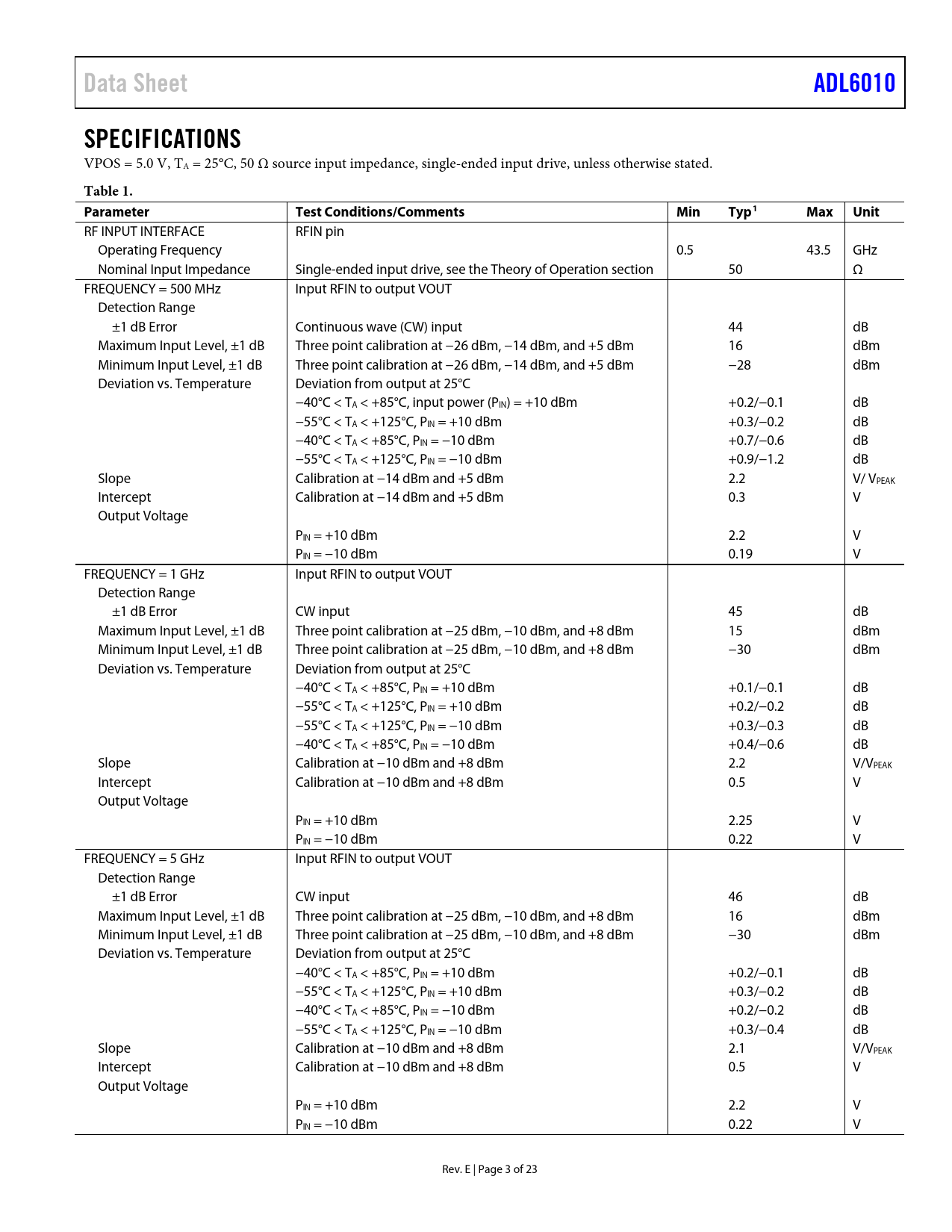

DescriptionFast Responding, 45 dB Range, 0.5 GHz to 43.5 GHz Envelope Detector

VPOS = 5.0 V, TA = 25°C, 50 Ω source input impedance, single-ended input drive, unless otherwise stated.
Table 1. Parameter Test Conditions/Comments Min Typ1 Max Unit
RF INPUT INTERFACE RFIN pin Operating Frequency 0.5 43.5 GHz Nominal Input Impedance Single-ended input drive, see the Theory of Operation section 50 Ω FREQUENCY = 500 MHz Input RFIN to output VOUT Detection Range ±1 dB Error Continuous wave (CW) input 44 dB Maximum Input Level, ±1 dB Three point calibration at −26 dBm, −14 dBm, and +5 dBm 16 dBm Minimum Input Level, ±1 dB Three point calibration at −26 dBm, −14 dBm, and +5 dBm −28 dBm Deviation vs. Temperature Deviation from output at 25°C −40°C < TA < +85°C, input power (PIN) = +10 dBm +0.2/−0.1 dB −55°C < TA < +125°C, PIN = +10 dBm +0.3/−0.2 dB −40°C < TA < +85°C, PIN = −10 dBm +0.7/−0.6 dB −55°C < TA < +125°C, PIN = −10 dBm +0.9/−1.2 dB Slope Calibration at −14 dBm and +5 dBm 2.2 V/ VPEAK Intercept Calibration at −14 dBm and +5 dBm 0.3 V Output Voltage PIN = +10 dBm 2.2 V PIN = −10 dBm 0.19 V FREQUENCY = 1 GHz Input RFIN to output VOUT Detection Range ±1 dB Error CW input 45 dB Maximum Input Level, ±1 dB Three point calibration at −25 dBm, −10 dBm, and +8 dBm 15 dBm Minimum Input Level, ±1 dB Three point calibration at −25 dBm, −10 dBm, and +8 dBm −30 dBm Deviation vs. Temperature Deviation from output at 25°C −40°C < TA < +85°C, PIN = +10 dBm +0.1/−0.1 dB −55°C < TA < +125°C, PIN = +10 dBm +0.2/−0.2 dB −55°C < TA < +125°C, PIN = −10 dBm +0.3/−0.3 dB −40°C < TA < +85°C, PIN = −10 dBm +0.4/−0.6 dB Slope Calibration at −10 dBm and +8 dBm 2.2 V/VPEAK Intercept Calibration at −10 dBm and +8 dBm 0.5 V Output Voltage PIN = +10 dBm 2.25 V PIN = −10 dBm 0.22 V FREQUENCY = 5 GHz Input RFIN to output VOUT Detection Range ±1 dB Error CW input 46 dB Maximum Input Level, ±1 dB Three point calibration at −25 dBm, −10 dBm, and +8 dBm 16 dBm Minimum Input Level, ±1 dB Three point calibration at −25 dBm, −10 dBm, and +8 dBm −30 dBm Deviation vs. Temperature Deviation from output at 25°C −40°C < TA < +85°C, PIN = +10 dBm +0.2/−0.1 dB −55°C < TA < +125°C, PIN = +10 dBm +0.3/−0.2 dB −40°C < TA < +85°C, PIN = −10 dBm +0.2/−0.2 dB −55°C < TA < +125°C, PIN = −10 dBm +0.3/−0.4 dB Slope Calibration at −10 dBm and +8 dBm 2.1 V/VPEAK Intercept Calibration at −10 dBm and +8 dBm 0.5 V Output Voltage PIN = +10 dBm 2.2 V PIN = −10 dBm 0.22 V Rev. E | Page 3 of 23 Document Outline FEATURES APPLICATIONS FUNCTIONAL BLOCK DIAGRAM GENERAL DESCRIPTION TABLE OF CONTENTS REVISION HISTORY SPECIFICATIONS ABSOLUTE MAXIMUM RATINGS ESD CAUTION PIN CONFIGURATIONS AND FUNCTION DESCRIPTIONS TYPICAL PERFORMANCE CHARACTERISTICS MEASUREMENT SETUPS THEORY OF OPERATION BASIC CONNECTIONS PCB LAYOUT RECOMMENDATIONS SYSTEM CALIBRATION AND ERROR CALCULATION EFFECT OF A CAPACITIVE LOAD ON RISE TIME AND FALL TIME EVALUATION BOARD EVALUATION BOARD ASSEMBLY DRAWINGS OUTLINE DIMENSIONS ORDERING GUIDE
