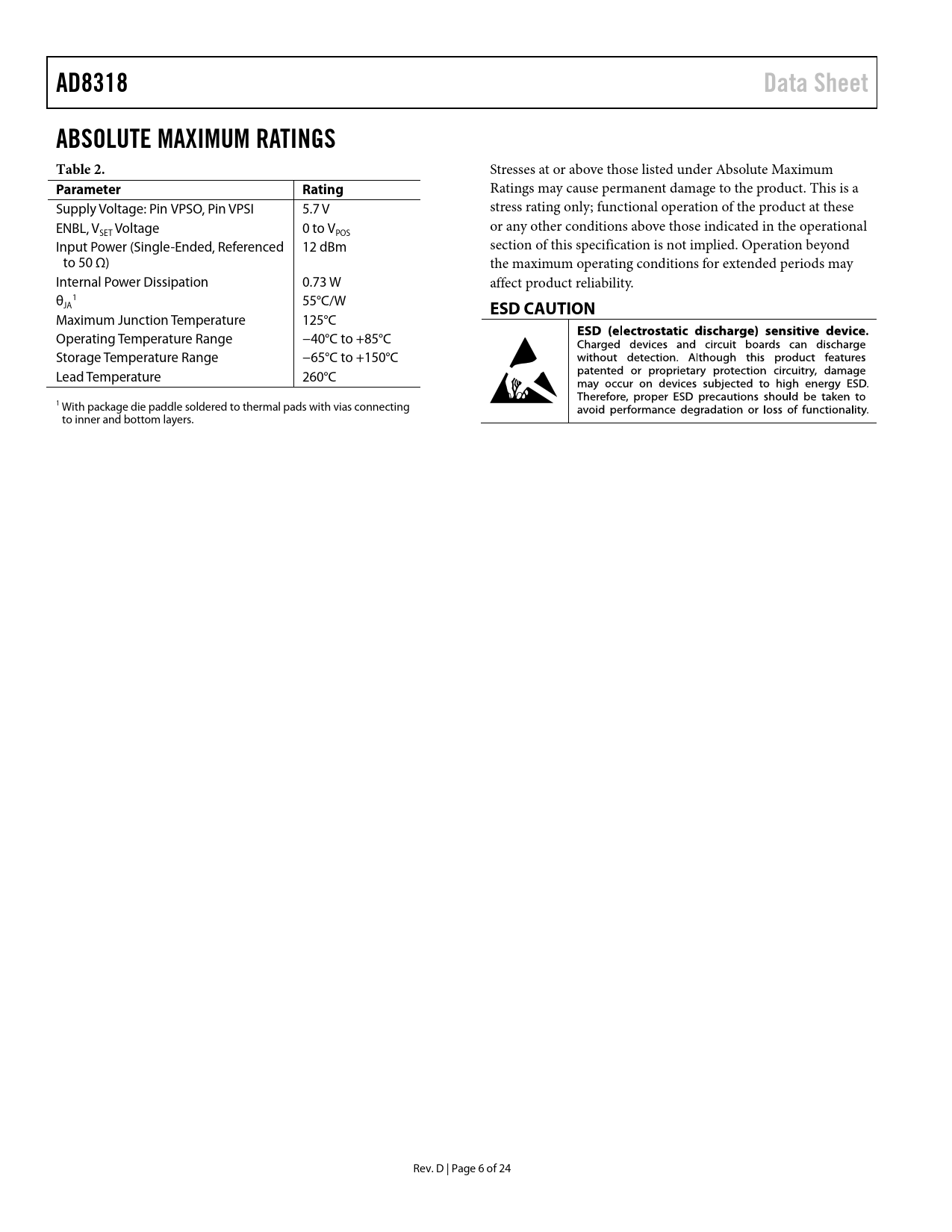

AD8318. Data Sheet. ABSOLUTE MAXIMUM RATINGS Table 2. Parameter. Rating. ESD CAUTION
AD8318 Data Sheet ABSOLUTE MAXIMUM RATINGS Table 2 Parameter Rating ESD CAUTION
AD8318 Data Sheet ABSOLUTE MAXIMUM RATINGS Table 2.
Stresses at or above those listed under Absolute Maximum
Parameter Rating
Ratings may cause permanent damage to the product. This is a Supply Voltage: Pin VPSO, Pin VPSI 5.7 V stress rating only; functional operation of the product at these ENBL, V Voltage 0 to V or any other conditions above those indicated in the operational SET POS Input Power (Single-Ended, Referenced 12 dBm section of this specification is not implied. Operation beyond to 50 Ω) the maximum operating conditions for extended periods may Internal Power Dissipation 0.73 W affect product reliability. θ 1 55°C/W JA
ESD CAUTION
Maximum Junction Temperature 125°C Operating Temperature Range −40°C to +85°C Storage Temperature Range −65°C to +150°C Lead Temperature 260°C 1 With package die paddle soldered to thermal pads with vias connecting to inner and bottom layers. Rev. D | Page 6 of 24 Document Outline Features Applications Functional Block Diagram General Description Revision History Specifications Absolute Maximum Ratings ESD Caution Pin Configuration and Function Descriptions Typical Performance Characteristics Theory of Operation Using the AD8318 Basic Connections Enable Interface Input Signal Coupling Output Interface Setpoint Interface Temperature Compensation of Output Voltage Temperature Sensor Measurement Mode Device Calibration and Error Calculation Selecting Calibration Points to Improve Accuracy over a Reduced Range Variation in Temperature Drift from Device to Device Temperature Drift at Different Temperatures Setting the Output Slope in Measurement Mode Response Time Capability Output Filtering Controller Mode Characterization Setup and Methods Evaluation Board Outline Dimensions Ordering Guide
