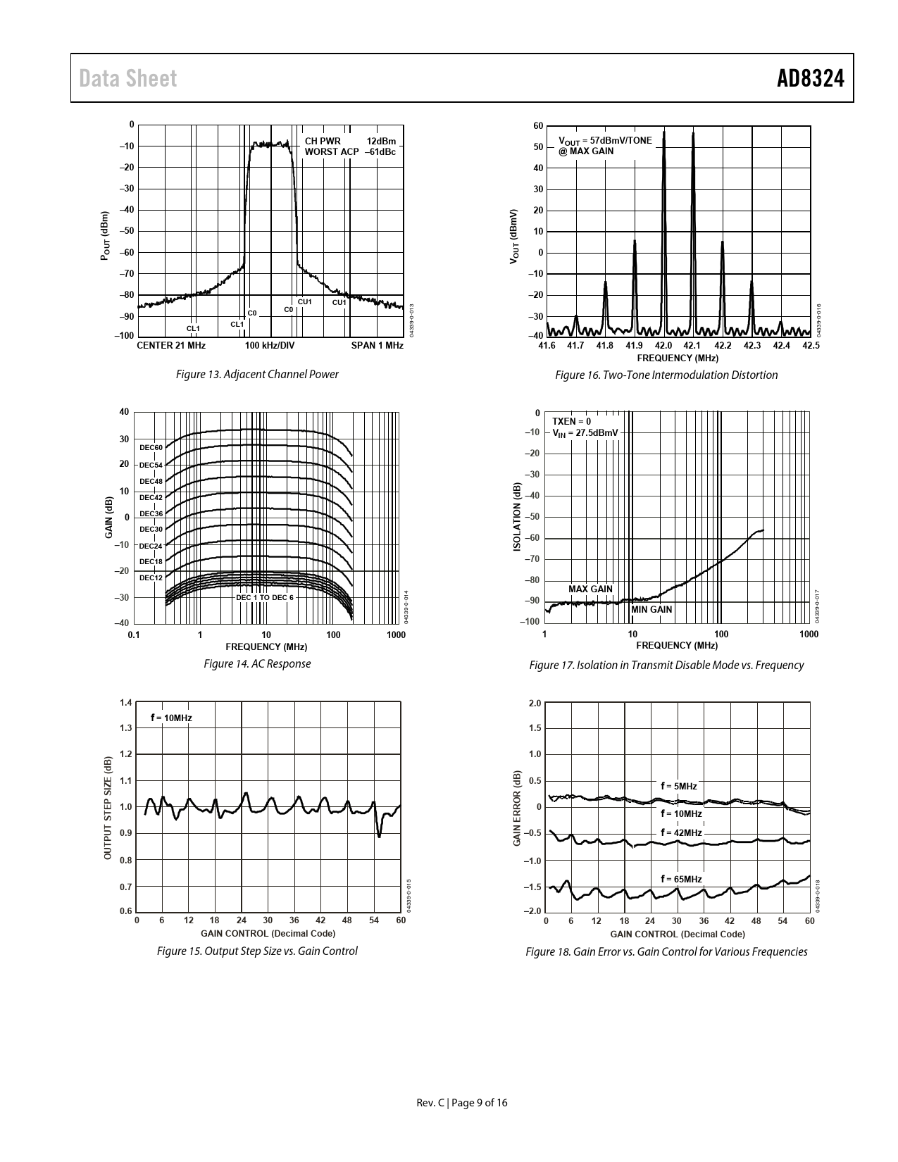

Data Sheet. AD8324. –10. CH PWR. 12dBm. OUT = 57dBmV/TONE. WORST ACP –61dBc. @ MAX GAIN. –20. –30. –40. m B. –50. (dBmV. –60. OUTV. –70. –80. CU1. –90. CL1. –100
Data Sheet AD8324 –10 CH PWR 12dBm OUT = 57dBmV/TONE WORST ACP –61dBc @ MAX GAIN –20 –30 –40 m B –50 (dBmV –60 OUTV –70 –80 CU1 –90 CL1 –100
Data Sheet AD8324 0 60 V –10 CH PWR 12dBm OUT = 57dBmV/TONE WORST ACP –61dBc 50 @ MAX GAIN –20 40 –30 30 ) –40 ) 20 m B –50 (d 10 T (dBmV OU –60 0 P OUTV –70 –10 –80 –20 CU1 CU1 –90 C0 C0
-013 0
–30
39-
CL1 CL1 –100
043
–40
04339-0-016
CENTER 21 MHz 100 kHz/DIV SPAN 1 MHz 41.6 41.7 41.8 41.9 42.0 42.1 42.2 42.3 42.4 42.5 FREQUENCY (MHz)
Figure 13. Adjacent Channel Power Figure 16. Two-Tone Intermodulation Distortion
40 0 TXEN = 0 –10 V 30 IN = 27.5dBmV DEC60 –20 20 DEC54 –30 DEC48 ) 10 B ) DEC42 d –40 B ( d ( 0 DEC36 ION –50 IN T DEC30 A GA L –60 –10 O DEC24 IS DEC18 –70 –20 DEC12 –80 MAX GAIN –30 DEC 1 TO DEC 6
14 17 0
–90
0 -0- 0-
MIN GAIN
9- 339
–40
433 04
–100
0
0.1 1 10 100 1000 1 10 100 1000 FREQUENCY (MHz) FREQUENCY (MHz)
Figure 14. AC Response Figure 17. Isolation in Transmit Disable Mode vs. Frequency
1.4 2.0 f = 10MHz 1.3 1.5 ) 1.2 1.0 B d 1.1 0.5 f = 5MHz 1.0 ROR (dB) 0 R f = 10MHz STEP SIZE ( T 0.9 –0.5 f = 42MHz TPU GAIN E OU 0.8 –1.0 f = 65MHz 0.7 –1.5 0.6
04339-0-015
–2.0
04339-0-018
0 6 12 18 24 30 36 42 48 54 60 0 6 12 18 24 30 36 42 48 54 60 GAIN CONTROL (Decimal Code) GAIN CONTROL (Decimal Code)
