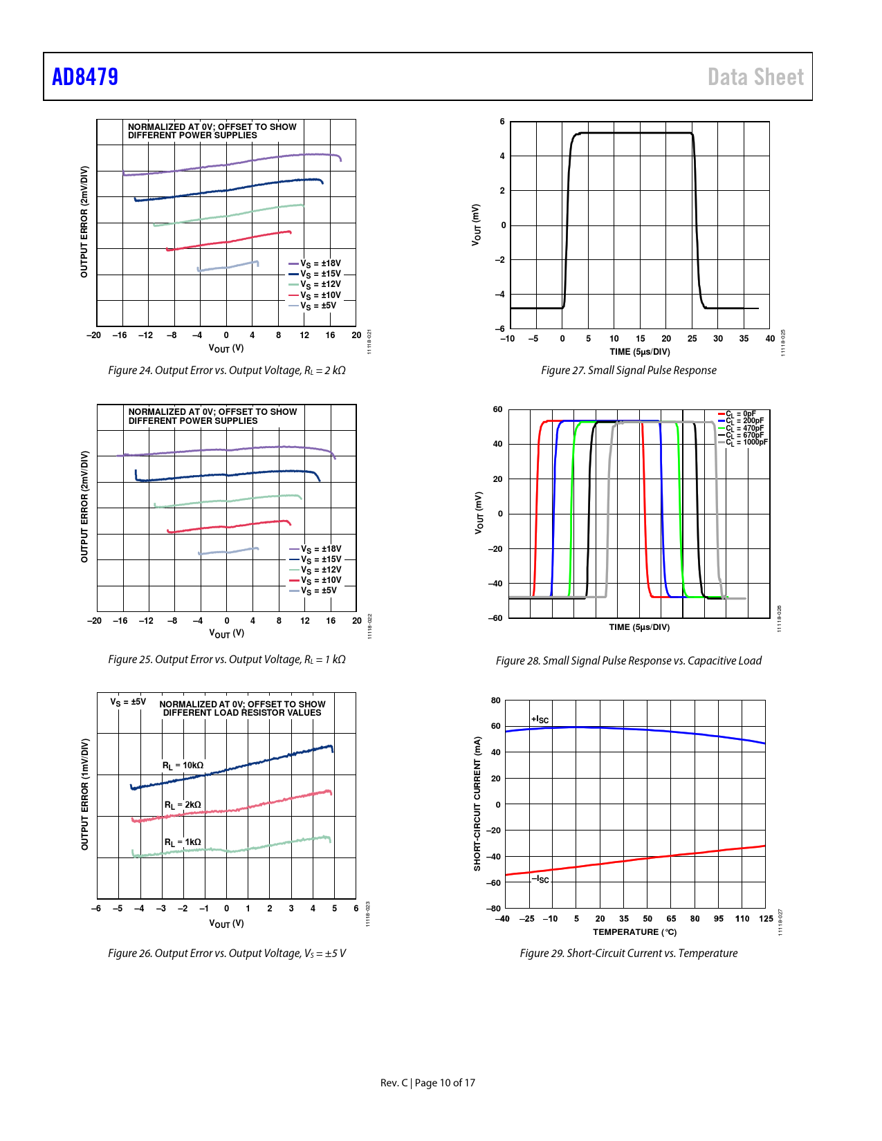

AD8479. Data Sheet. NORMALIZED AT 0V; OFFSET TO SHOW DIFFERENT POWER SUPPLIES. ) V /DI. 2mV R (. RRO. UT P. S = ±18V
AD8479 Data Sheet NORMALIZED AT 0V; OFFSET TO SHOW DIFFERENT POWER SUPPLIES ) V /DI 2mV R ( RRO UT P S = ±18V
AD8479 Data Sheet 6 NORMALIZED AT 0V; OFFSET TO SHOW DIFFERENT POWER SUPPLIES 4 ) V /DI 2 2mV R ( V) (m 0 RRO UT E OV UT P V –2 UT S = ±18V O VS = ±15V VS = ±12V VS = ±10V –4 VS = ±5V –6 –20 –16 –12 –8 –4 0 4 8 12 16 20

11118- Figure 24. Output Error vs. Output Voltage, RL = 2 kΩ Figure 27. Small Signal Pulse Response

111 Figure 25. Output Error vs. Output Voltage, RL = 1 kΩ Figure 28. Small Signal Pulse Response vs. Capacitive Load

11118- Figure 26. Output Error vs. Output Voltage, VS = ±5 V Figure 29. Short-Circuit Current vs. Temperature Rev. C | Page 10 of 17 Document Outline FEATURES APPLICATIONS FUNCTIONAL BLOCK DIAGRAM GENERAL DESCRIPTION TABLE OF CONTENTS REVISION HISTORY SPECIFICATIONS ABSOLUTE MAXIMUM RATINGS THERMAL RESISTANCE ESD CAUTION PIN CONFIGURATION AND FUNCTION DESCRIPTIONS TYPICAL PERFORMANCE CHARACTERISTICS THEORY OF OPERATION APPLICATIONS INFORMATION BASIC CONNECTIONS SINGLE-SUPPLY OPERATION SYSTEM-LEVEL DECOUPLING AND GROUNDING USING A LARGE SHUNT RESISTOR OUTPUT FILTERING GAIN OF 60 DIFFERENTIAL AMPLIFIER ERROR BUDGET ANALYSIS EXAMPLE OUTLINE DIMENSIONS ORDERING GUIDE
