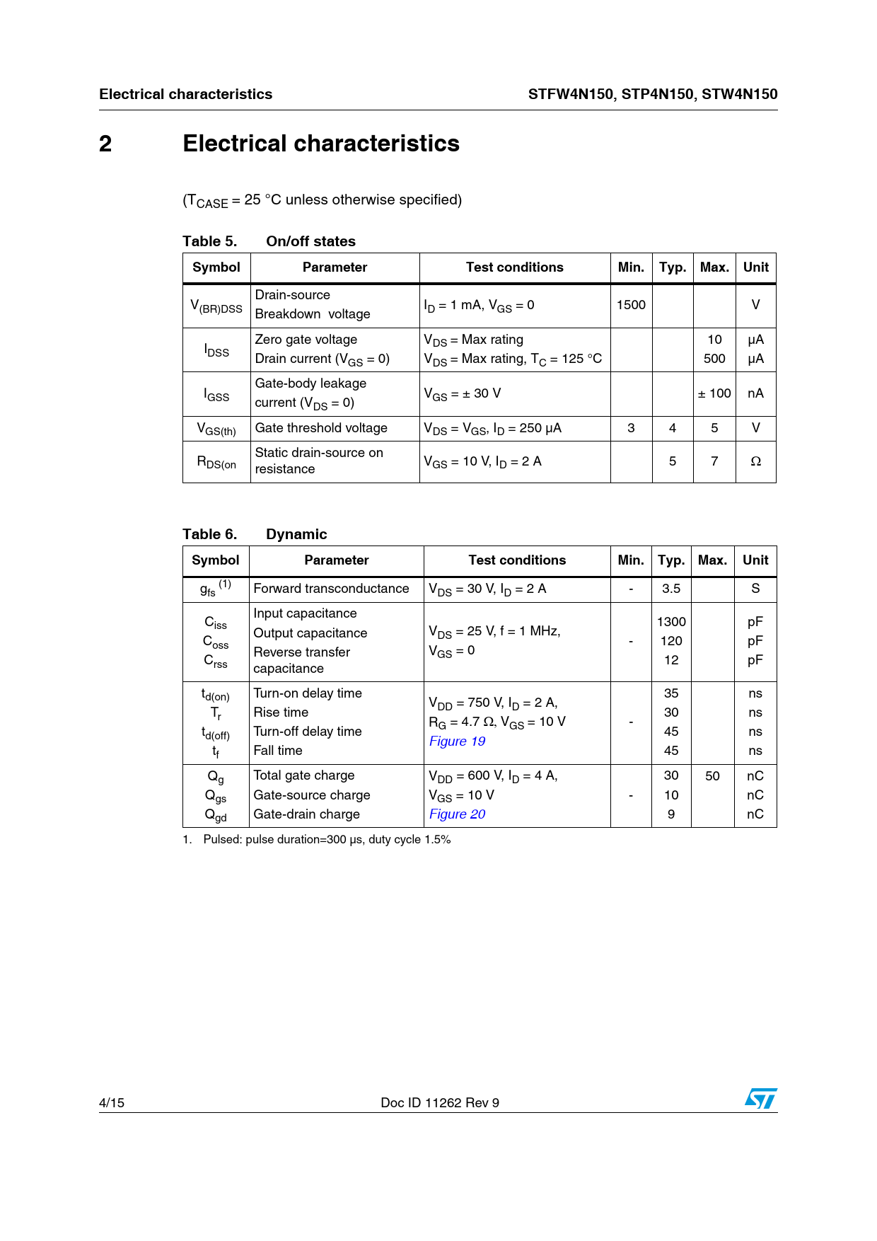

Electrical characteristics. STFW4N150, STP4N150, STW4N150. 2 Electrical. characteristics. Table 5. On/off states. Symbol. Parameter
Electrical characteristics STFW4N150, STP4N150, STW4N150 2 Electrical characteristics Table 5 On/off states Symbol Parameter
link to page 9 link to page 9
(TCASE = 25 °C unless otherwise specified)
Table 5. On/off states Symbol Parameter Test conditions Min. Typ. Max. Unit
Drain-source V(BR)DSS I Breakdown voltage D = 1 mA, VGS = 0 1500 V Zero gate voltage V 10 µA I DS = Max rating DSS Drain current (VGS = 0) VDS = Max rating, TC = 125 °C 500 µA Gate-body leakage IGSS V current (V GS = ± 30 V ± 100 nA DS = 0) VGS(th) Gate threshold voltage VDS = VGS, ID = 250 µA 3 4 5 V Static drain-source on RDS(on V resistance GS = 10 V, ID = 2 A 5 7 Ω
Table 6. Dynamic Symbol Parameter Test conditions Min. Typ. Max. Unit
