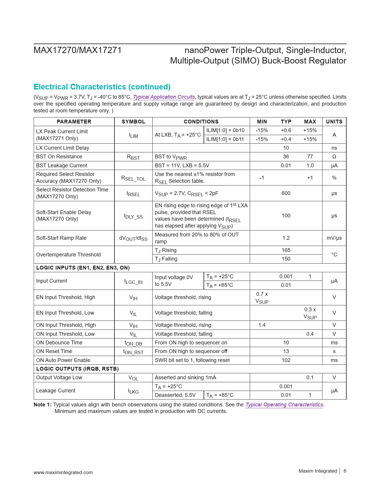

link to page 35 link to page 9 MAX17270/MAX17271 nanoPower Triple-Output, Single-Inductor, Multiple-Output (SIMO) Buck-Boost Regulator
Electrical Characteristics (continued)
(VSUP = VPWR = 3.7V, TJ = -40°C to 85°C, Typical Application Circuits, typical values are at TJ = 25°C unless otherwise specified. Limits over the specified operating temperature and supply voltage range are guaranteed by design and characterization, and production tested at room temperature only. )
PARAMETER SYMBOL CONDITIONS MIN TYP MAX UNITS
LX Peak Current Limit ILIM[1:0] = 0b10 -15% +0.6 +15% (MAX17271 Only) I LIM At LXB, TA = +25°C A ILIM[1:0] = 0b11 -15% +0.4 +15% LX Current Limit Delay 10 ns BST On Resistance RBST BST to VPWR 36 77 Ω BST Leakage Current BST = 11V, LXB = 5.5V 0.01 1.0 μA Required Select Resistor Use the nearest ±1% resistor from Accuracy (MAX17270 Only) RSEL_TOL RSEL Selection table. -1 +1 % Select Resistor Detection Time (MAX17270 Only) tRSEL VSUP = 2.7V, CRSEL < 2pF 600 μs EN rising edge to rising edge of 1st LXA Soft-Start Enable Delay pulse, provided that RSEL (MAX17270 Only) tDLY_SS values have been determined (t 100 μs RSEL has elapsed after applying VSUP) Soft-Start Ramp Rate dV Measured from 20% to 80% of OUT OUT/dtSS ramp 1.2 mV/μs T Overtemperature Threshold J Rising 165 °C TJ Falling 150
LOGIC INPUTS (EN1, EN2, EN3, ON)
T Input Current I Input voltage 0V A = +25°C 0.001 1 LGC_IN to 5.5V μA TA = +85°C 0.01 EN Input Threshold, High VIH Voltage threshold, rising 0.7 x V V SUP EN Input Threshold, Low VIL Voltage threshold, falling 0.3 x V V SUP ON Input Threshold, High VIH Voltage threshold, rising 1.4 V ON Input Threshold, Low VIL Voltage threshold, falling 0.4 V ON Debounce Time tON_DB From ON high to sequencer on 10 ms ON Reset Time tON_RST From ON high to sequencer off 13 s ON Auto Power Enable SWR bit set to 1, following reset 102 ms
LOGIC OUTPUTS (IRQB, RSTB)
Output Voltage Low VOL Asserted and sinking 1mA 0.1 V T Leakage Current I A = +25°C 0.001 LKG μA Deasserted, 5.5V TA = +85°C 0.01 1
Note 1:
Typical values align with bench observations using the stated conditions. See the Typical Operating Characteristics. Minimum and maximum values are tested in production with DC currents. www.maximintegrated.com Maxim Integrated │ 6
