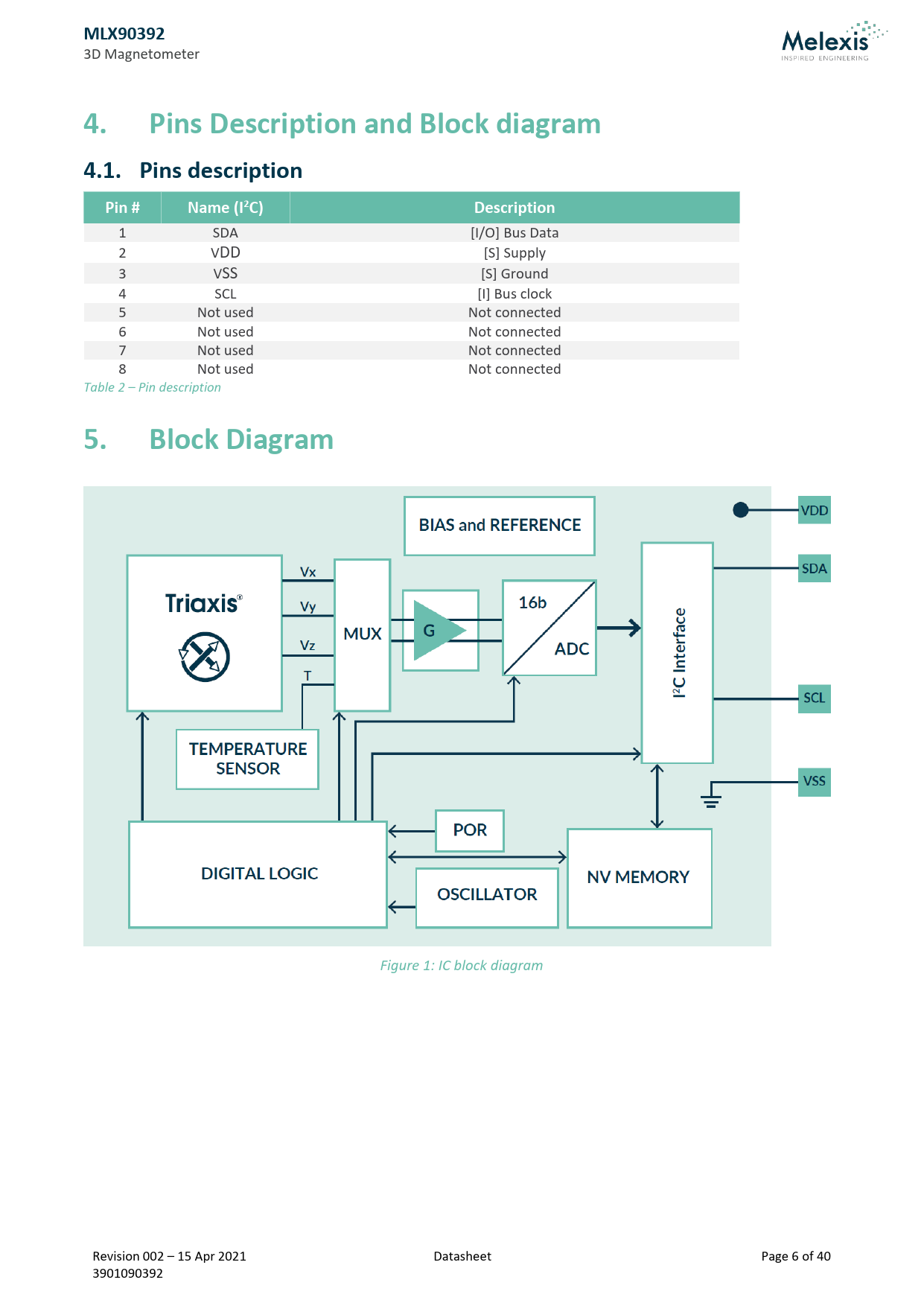

MLX90392. Pins Description and Block diagram. 4.1. Pins description. Pin #. Name (I2C). Description. Block Diagram
MLX90392 Pins Description and Block diagram 4.1 Pins description Pin # Name (I2C) Description Block Diagram
MLX90392
3D Magnetometer
4. Pins Description and Block diagram 4.1. Pins description Pin # Name (I2C) Description
1 SDA [I/O] Bus Data 2 VDD [S] Supply 3 VSS [S] Ground 4 SCL [I] Bus clock 5 Not used Not connected 6 Not used Not connected 7 Not used Not connected 8 Not used Not connected Table 2 – Pin description
5. Block Diagram
Figure 1: IC block diagram Revision 002 – 15 Apr 2021 Datasheet Page 6 of 40 3901090392
