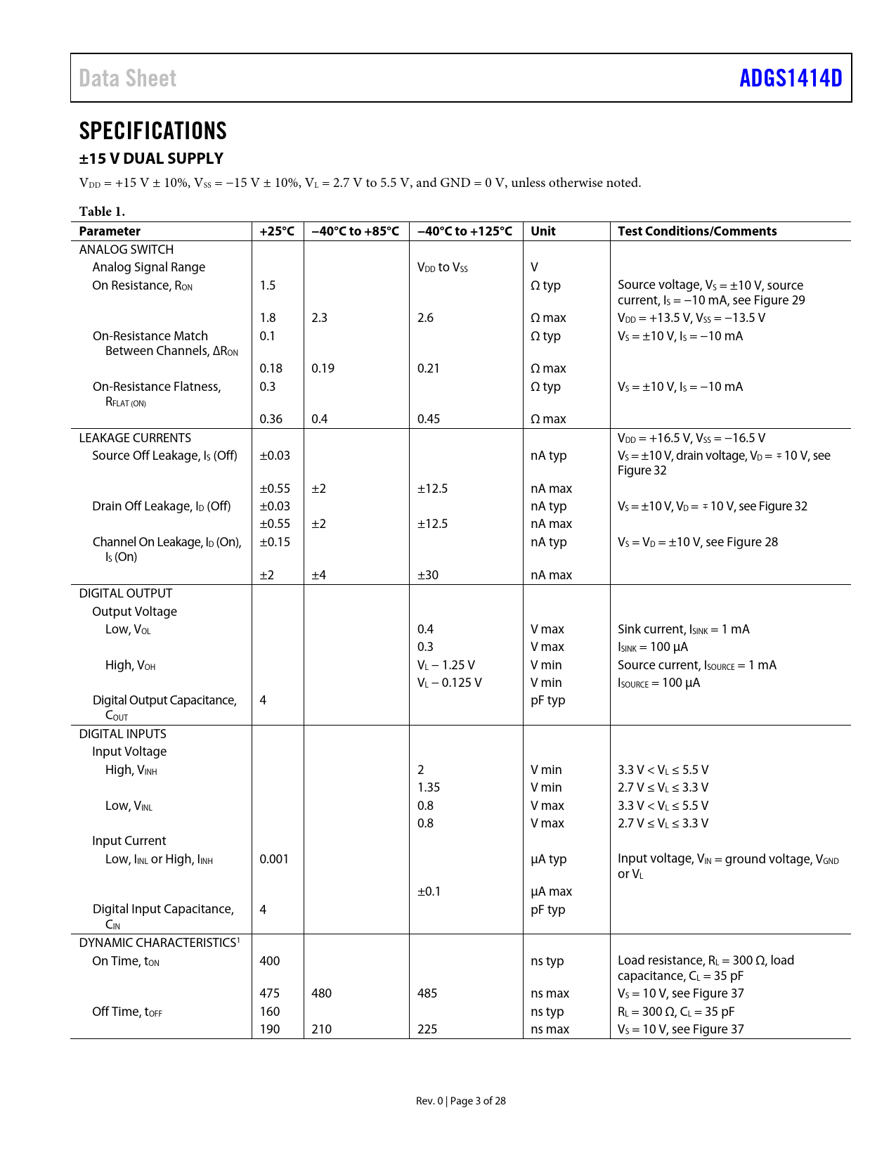

Data Sheet. ADGS1414D. SPECIFICATIONS ±15 V DUAL SUPPLY. Table 1. Parameter. +25°C −40°C to +85°C. −40°C to +125°C. Unit
Data Sheet ADGS1414D SPECIFICATIONS ±15 V DUAL SUPPLY Table 1 Parameter +25°C −40°C to +85°C −40°C to +125°C Unit
link to page 17 link to page 17 link to page 17 link to page 17 link to page 18 link to page 18 link to page 4
VDD = +15 V ± 10%, VSS = −15 V ± 10%, VL = 2.7 V to 5.5 V, and GND = 0 V, unless otherwise noted.
Table 1. Parameter +25°C −40°C to +85°C −40°C to +125°C Unit Test Conditions/Comments
ANALOG SWITCH Analog Signal Range VDD to VSS V On Resistance, RON 1.5 Ω typ Source voltage, VS = ±10 V, source current, IS = −10 mA, see Figure 29 1.8 2.3 2.6 Ω max VDD = +13.5 V, VSS = −13.5 V On-Resistance Match 0.1 Ω typ VS = ±10 V, IS = −10 mA Between Channels, ∆RON 0.18 0.19 0.21 Ω max On-Resistance Flatness, 0.3 Ω typ VS = ±10 V, IS = −10 mA RFLAT (ON) 0.36 0.4 0.45 Ω max LEAKAGE CURRENTS VDD = +16.5 V, VSS = −16.5 V Source Off Leakage, IS (Off) ±0.03 nA typ VS = ±10 V, drain voltage, VD =  10 V, see Figure 32 ±0.55 ±2 ±12.5 nA max Drain Off Leakage, ID (Off) ±0.03 nA typ VS = ±10 V, VD =  10 V, see Figure 32 ±0.55 ±2 ±12.5 nA max Channel On Leakage, ID (On), ±0.15 nA typ VS = VD = ±10 V, see Figure 28 IS (On) ±2 ±4 ±30 nA max DIGITAL OUTPUT Output Voltage Low, VOL 0.4 V max Sink current, ISINK = 1 mA 0.3 V max ISINK = 100 µA High, VOH VL − 1.25 V V min Source current, ISOURCE = 1 mA VL − 0.125 V V min ISOURCE = 100 µA Digital Output Capacitance, 4 pF typ COUT DIGITAL INPUTS Input Voltage High, VINH 2 V min 3.3 V < VL ≤ 5.5 V 1.35 V min 2.7 V ≤ VL ≤ 3.3 V Low, VINL 0.8 V max 3.3 V < VL ≤ 5.5 V 0.8 V max 2.7 V ≤ VL ≤ 3.3 V Input Current Low, IINL or High, IINH 0.001 µA typ Input voltage, VIN = ground voltage, VGND or VL ±0.1 µA max Digital Input Capacitance, 4 pF typ CIN DYNAMIC CHARACTERISTICS1 On Time, tON 400 ns typ Load resistance, RL = 300 Ω, load capacitance, CL = 35 pF 475 480 485 ns max VS = 10 V, see Figure 37 Off Time, tOFF 160 ns typ RL = 300 Ω, CL = 35 pF 190 210 225 ns max VS = 10 V, see Figure 37 Rev. 0 | Page 3 of 28 Document Outline Features Applications General Description Functional Block Diagram Product Highlights Revision History Specifications ±15 V Dual Supply ±5 V Dual Supply 12 V Single Supply Continuous Current per Channel, Sx or Dx Timing Characteristics Timing Diagrams Absolute Maximum Ratings Thermal Resistance Electrostatic Discharge (ESD) Ratings ESD Ratings for ADGS1414D ESD Caution Pin Configuration and Function Descriptions Typical Performance Characteristics Test Circuits Terminology Theory of Operation Address Mode Error Detection Features Cyclic Redundancy Check (CRC) Error Detection SCLK Count Error Detection Invalid Read and Write Address Error Clearing the Error Flags Register Burst Mode Software Reset Daisy-Chain Mode Power-On Reset Applications Information System Channel Density Route Through Pins Integrated Passive Components Break-Before-Make Switching Digital Input Buffers Power Supply Rails Power Supply Recommendations 1.8 V Logic Compatibility Register Summary Register Details Switch Data Register Error Configuration Register Error Flags Register Burst Enable Register Software Reset Register Outline Dimensions Ordering Guide
