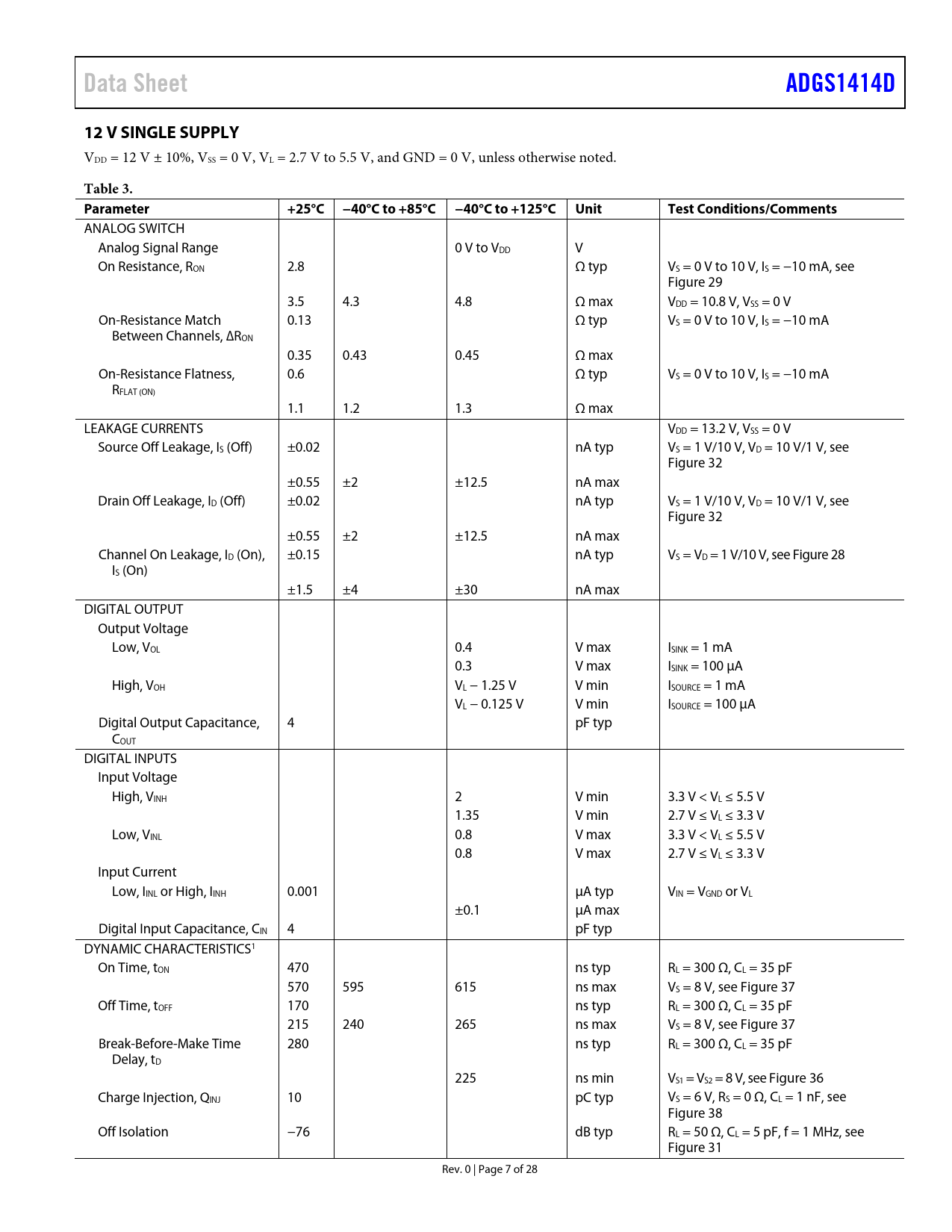

Data Sheet ADGS1414D 12 V SINGLE SUPPLY
VDD = 12 V ± 10%, VSS = 0 V, VL = 2.7 V to 5.5 V, and GND = 0 V, unless otherwise noted.
Table 3. Parameter +25°C −40°C to +85°C −40°C to +125°C Unit Test Conditions/Comments
ANALOG SWITCH Analog Signal Range 0 V to VDD V On Resistance, RON 2.8 Ω typ VS = 0 V to 10 V, IS = −10 mA, see Figure 29 3.5 4.3 4.8 Ω max VDD = 10.8 V, VSS = 0 V On-Resistance Match 0.13 Ω typ VS = 0 V to 10 V, IS = −10 mA Between Channels, ∆RON 0.35 0.43 0.45 Ω max On-Resistance Flatness, 0.6 Ω typ VS = 0 V to 10 V, IS = −10 mA RFLAT (ON) 1.1 1.2 1.3 Ω max LEAKAGE CURRENTS VDD = 13.2 V, VSS = 0 V Source Off Leakage, IS (Off) ±0.02 nA typ VS = 1 V/10 V, VD = 10 V/1 V, see Figure 32 ±0.55 ±2 ±12.5 nA max Drain Off Leakage, ID (Off) ±0.02 nA typ VS = 1 V/10 V, VD = 10 V/1 V, see Figure 32 ±0.55 ±2 ±12.5 nA max Channel On Leakage, ID (On), ±0.15 nA typ VS = VD = 1 V/10 V, see Figure 28 IS (On) ±1.5 ±4 ±30 nA max DIGITAL OUTPUT Output Voltage Low, VOL 0.4 V max ISINK = 1 mA 0.3 V max ISINK = 100 µA High, VOH VL − 1.25 V V min ISOURCE = 1 mA VL − 0.125 V V min ISOURCE = 100 µA Digital Output Capacitance, 4 pF typ COUT DIGITAL INPUTS Input Voltage High, VINH 2 V min 3.3 V < VL ≤ 5.5 V 1.35 V min 2.7 V ≤ VL ≤ 3.3 V Low, VINL 0.8 V max 3.3 V < VL ≤ 5.5 V 0.8 V max 2.7 V ≤ VL ≤ 3.3 V Input Current Low, IINL or High, IINH 0.001 µA typ VIN = VGND or VL ±0.1 µA max Digital Input Capacitance, CIN 4 pF typ DYNAMIC CHARACTERISTICS1 On Time, tON 470 ns typ RL = 300 Ω, CL = 35 pF 570 595 615 ns max VS = 8 V, see Figure 37 Off Time, tOFF 170 ns typ RL = 300 Ω, CL = 35 pF 215 240 265 ns max VS = 8 V, see Figure 37 Break-Before-Make Time 280 ns typ RL = 300 Ω, CL = 35 pF Delay, tD 225 ns min VS1 = VS2 = 8 V, see Figure 36 Charge Injection, QINJ 10 pC typ VS = 6 V, RS = 0 Ω, CL = 1 nF, see Figure 38 Off Isolation −76 dB typ RL = 50 Ω, CL = 5 pF, f = 1 MHz, see Figure 31 Rev. 0 | Page 7 of 28 Document Outline Features Applications General Description Functional Block Diagram Product Highlights Revision History Specifications ±15 V Dual Supply ±5 V Dual Supply 12 V Single Supply Continuous Current per Channel, Sx or Dx Timing Characteristics Timing Diagrams Absolute Maximum Ratings Thermal Resistance Electrostatic Discharge (ESD) Ratings ESD Ratings for ADGS1414D ESD Caution Pin Configuration and Function Descriptions Typical Performance Characteristics Test Circuits Terminology Theory of Operation Address Mode Error Detection Features Cyclic Redundancy Check (CRC) Error Detection SCLK Count Error Detection Invalid Read and Write Address Error Clearing the Error Flags Register Burst Mode Software Reset Daisy-Chain Mode Power-On Reset Applications Information System Channel Density Route Through Pins Integrated Passive Components Break-Before-Make Switching Digital Input Buffers Power Supply Rails Power Supply Recommendations 1.8 V Logic Compatibility Register Summary Register Details Switch Data Register Error Configuration Register Error Flags Register Burst Enable Register Software Reset Register Outline Dimensions Ordering Guide
