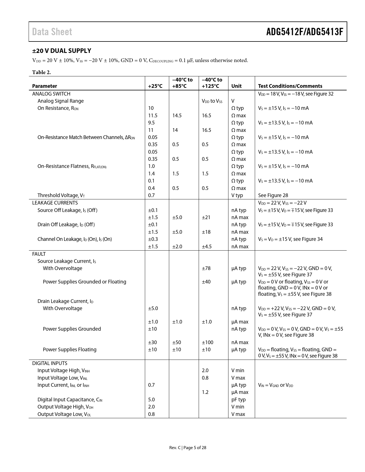

Data Sheet. ADG5412F/ADG5413F. ±20 V DUAL SUPPLY. Table 2. −40°C to. Parameter. +25°C. +85°C. +125°C. Unit. Test Conditions/Comments
Data Sheet ADG5412F/ADG5413F ±20 V DUAL SUPPLY Table 2 −40°C to Parameter +25°C +85°C +125°C Unit Test Conditions/Comments
link to page 19 link to page 17 link to page 19 link to page 19 link to page 19 link to page 19 link to page 19 link to page 19 link to page 19 link to page 19
VDD = 20 V ± 10%, VSS = −20 V ± 10%, GND = 0 V, CDECOUPLING = 0.1 µF, unless otherwise noted.
Table 2. −40°C to −40°C to Parameter +25°C +85°C +125°C Unit Test Conditions/Comments
ANALOG SWITCH VDD = 18 V, VSS = −18 V, see Figure 32 Analog Signal Range VDD to VSS V On Resistance, RON 10 Ω typ VS = ±15 V, IS = −10 mA 11.5 14.5 16.5 Ω max 9.5 Ω typ VS = ±13.5 V, IS = −10 mA 11 14 16.5 Ω max On-Resistance Match Between Channels, ∆RON 0.05 Ω typ VS = ±15 V, IS = −10 mA 0.35 0.5 0.5 Ω max 0.05 Ω typ VS = ±13.5 V, IS = −10 mA 0.35 0.5 0.5 Ω max On-Resistance Flatness, RFLAT(ON) 1.0 Ω typ VS = ±15 V, IS = −10 mA 1.4 1.5 1.5 Ω max 0.1 Ω typ VS = ±13.5 V, IS = −10 mA 0.4 0.5 0.5 Ω max Threshold Voltage, VT 0.7 V typ See Figure 28 LEAKAGE CURRENTS VDD = 22 V, VSS = −22 V Source Off Leakage, IS (Off) ±0.1 nA typ VS = ±15 V, VD = ∓15 V, see Figure 33 ±1.5 ±5.0 ±21 nA max Drain Off Leakage, ID (Off) ±0.1 nA typ VS = ±15 V, VD = ∓15 V, see Figure 33 ±1.5 ±5.0 ±18 nA max Channel On Leakage, ID (On), IS (On) ±0.3 nA typ VS = VD = ±15 V, see Figure 34 ±1.5 ±2.0 ±4.5 nA max FAULT Source Leakage Current, IS With Overvoltage ±78 µA typ VDD = 22 V, VSS = −22 V, GND = 0 V, VS = ±55 V, see Figure 37 Power Supplies Grounded or Floating ±40 µA typ VDD = 0 V or floating, VSS = 0 V or floating, GND = 0 V, INx = 0 V or floating, VS = ±55 V, see Figure 38 Drain Leakage Current, ID With Overvoltage ±5.0 nA typ VDD = +22 V, VSS = −22 V, GND = 0 V, VS = ±55 V, see Figure 37 ±1.0 ±1.0 ±1.0 µA max Power Supplies Grounded ±10 nA typ VDD = 0 V, VSS = 0 V, GND = 0 V, VS = ±55 V, INx = 0 V, see Figure 38 ±30 ±50 ±100 nA max Power Supplies Floating ±10 ±10 ±10 µA typ VDD = floating, VSS = floating, GND = 0 V, VS = ±55 V, INx = 0 V, see Figure 38 DIGITAL INPUTS Input Voltage High, VINH 2.0 V min Input Voltage Low, VINL 0.8 V max Input Current, IINL or IINH 0.7 µA typ VIN = VGND or VDD 1.2 µA max Digital Input Capacitance, CIN 5.0 pF typ Output Voltage High, VOH 2.0 V min Output Voltage Low, VOL 0.8 V max Rev. C | Page 5 of 28 Document Outline FEATURES APPLICATIONS FUNCTIONAL BLOCK DIAGRAMS GENERAL DESCRIPTION PRODUCT HIGHLIGHTS TABLE OF CONTENTS REVISION HISTORY SPECIFICATIONS ±15 V DUAL SUPPLY ±20 V DUAL SUPPLY 12 V SINGLE SUPPLY 36 V SINGLE SUPPLY CONTINUOUS CURRENT PER CHANNEL, Sx OR Dx ABSOLUTE MAXIMUM RATINGS ESD CAUTION PIN CONFIGURATIONS AND FUNCTION DESCRIPTIONS TYPICAL PERFORMANCE CHARACTERISTICS TEST CIRCUITS TERMINOLOGY THEORY OF OPERATION SWITCH ARCHITECTURE ESD Performance Trench Isolation FAULT PROTECTION Power-On Protection Power-Off Protection Digital Input Protection Overvoltage Interrupt Flag APPLICATIONS INFORMATION POWER SUPPLY RAILS POWER SUPPLY SEQUENCING PROTECTION SIGNAL RANGE LOW IMPEDANCE CHANNEL PROTECTION HIGH VOLTAGE SURGE SUPPRESSION INTELLIGENT FAULT DETECTION LARGE VOLTAGE, HIGH FREQUENCY SIGNALS OUTLINE DIMENSIONS ORDERING GUIDE
