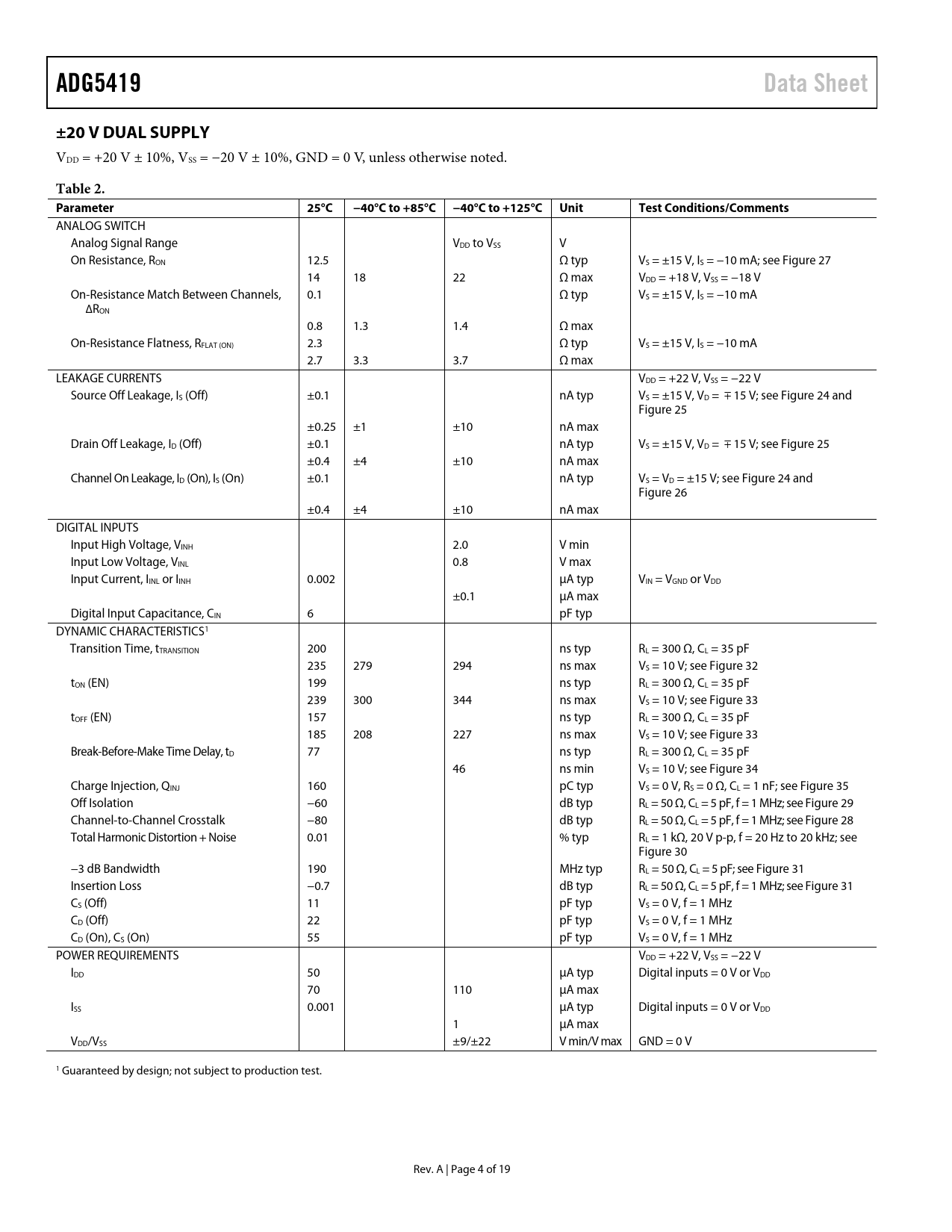

ADG5419. Data Sheet. ±20 V DUAL SUPPLY. Table 2. Parameter. 25°C. −40°C to +85°C. −40°C to +125°C Unit. Test. Conditions/Comments
ADG5419 Data Sheet ±20 V DUAL SUPPLY Table 2 Parameter 25°C −40°C to +85°C −40°C to +125°C Unit Test Conditions/Comments
link to page 14 link to page 14 link to page 14 link to page 14 link to page 14 link to page 14 link to page 15 link to page 15 link to page 15 link to page 16 link to page 16 link to page 14 link to page 14 link to page 15 link to page 15 link to page 15
VDD = +20 V ± 10%, VSS = −20 V ± 10%, GND = 0 V, unless otherwise noted.
Table 2. Parameter 25°C −40°C to +85°C −40°C to +125°C Unit Test Conditions/Comments
ANALOG SWITCH Analog Signal Range VDD to VSS V On Resistance, RON 12.5 Ω typ VS = ±15 V, IS = −10 mA; see Figure 27 14 18 22 Ω max VDD = +18 V, VSS = −18 V On-Resistance Match Between Channels, 0.1 Ω typ VS = ±15 V, IS = −10 mA ∆RON 0.8 1.3 1.4 Ω max On-Resistance Flatness, RFLAT (ON) 2.3 Ω typ VS = ±15 V, IS = −10 mA 2.7 3.3 3.7 Ω max LEAKAGE CURRENTS VDD = +22 V, VSS = −22 V Source Off Leakage, IS (Off) ±0.1 nA typ VS = ±15 V, VD =  15 V; see Figure 24 and Figure 25 ±0.25 ±1 ±10 nA max Drain Off Leakage, ID (Off) ±0.1 nA typ VS = ±15 V, VD =  15 V; see Figure 25 ±0.4 ±4 ±10 nA max Channel On Leakage, ID (On), IS (On) ±0.1 nA typ VS = VD = ±15 V; see Figure 24 and Figure 26 ±0.4 ±4 ±10 nA max DIGITAL INPUTS Input High Voltage, VINH 2.0 V min Input Low Voltage, VINL 0.8 V max Input Current, IINL or IINH 0.002 μA typ VIN = VGND or VDD ±0.1 μA max Digital Input Capacitance, CIN 6 pF typ DYNAMIC CHARACTERISTICS1 Transition Time, tTRANSITION 200 ns typ RL = 300 Ω, CL = 35 pF 235 279 294 ns max VS = 10 V; see Figure 32 tON (EN) 199 ns typ RL = 300 Ω, CL = 35 pF 239 300 344 ns max VS = 10 V; see Figure 33 tOFF (EN) 157 ns typ RL = 300 Ω, CL = 35 pF 185 208 227 ns max VS = 10 V; see Figure 33 Break-Before-Make Time Delay, tD 77 ns typ RL = 300 Ω, CL = 35 pF 46 ns min VS = 10 V; see Figure 34 Charge Injection, QINJ 160 pC typ VS = 0 V, RS = 0 Ω, CL = 1 nF; see Figure 35 Off Isolation −60 dB typ RL = 50 Ω, CL = 5 pF, f = 1 MHz; see Figure 29 Channel-to-Channel Crosstalk −80 dB typ RL = 50 Ω, CL = 5 pF, f = 1 MHz; see Figure 28 Total Harmonic Distortion + Noise 0.01 % typ RL = 1 kΩ, 20 V p-p, f = 20 Hz to 20 kHz; see Figure 30 −3 dB Bandwidth 190 MHz typ RL = 50 Ω, CL = 5 pF; see Figure 31 Insertion Loss −0.7 dB typ RL = 50 Ω, CL = 5 pF, f = 1 MHz; see Figure 31 CS (Off) 11 pF typ VS = 0 V, f = 1 MHz CD (Off) 22 pF typ VS = 0 V, f = 1 MHz CD (On), CS (On) 55 pF typ VS = 0 V, f = 1 MHz POWER REQUIREMENTS VDD = +22 V, VSS = −22 V IDD 50 μA typ Digital inputs = 0 V or VDD 70 110 μA max ISS 0.001 μA typ Digital inputs = 0 V or VDD 1 μA max VDD/VSS ±9/±22 V min/V max GND = 0 V 1 Guaranteed by design; not subject to production test. Rev. A | Page 4 of 19 Document Outline FEATURES APPLICATIONS FUNCTIONAL BLOCK DIAGRAMS GENERAL DESCRIPTION PRODUCT HIGHLIGHTS TABLE OF CONTENTS REVISION HISTORY SPECIFICATIONS ±15 V DUAL SUPPLY ±20 V DUAL SUPPLY 12 V SINGLE SUPPLY 36 V SINGLE SUPPLY CONTINUOUS CURRENT PER CHANNEL, Sx OR D ABSOLUTE MAXIMUM RATINGS ESD CAUTION PIN CONFIGURATIONS AND FUNCTION DESCRIPTIONS TYPICAL PERFORMANCE CHARACTERISTICS TEST CIRCUITS TERMINOLOGY APPLICATIONS INFORMATION TRENCH ISOLATION OUTLINE DIMENSIONS ORDERING GUIDE
