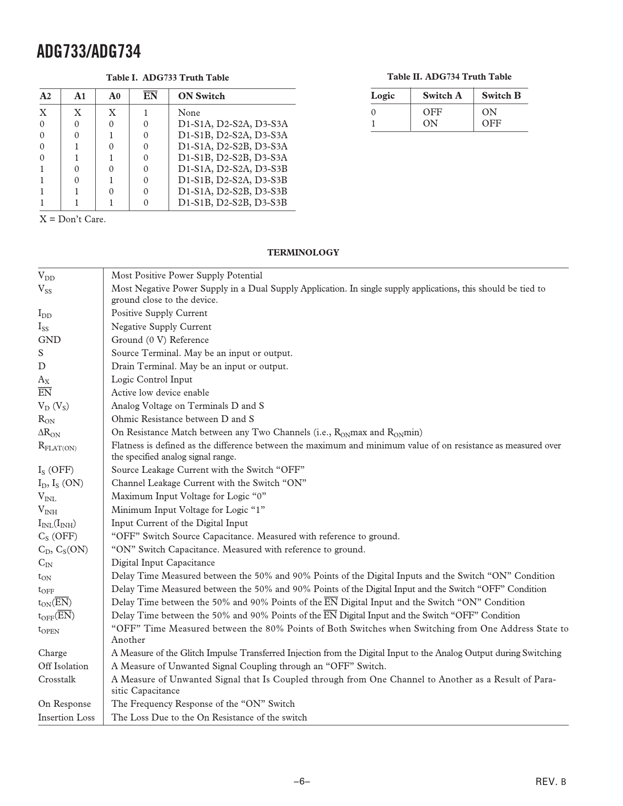

ADG733/ADG734. Table I. ADG733 Truth Table. Table II. ADG734 Truth Table. ON Switch. Logic. Switch A. Switch B. TERMINOLOGY
ADG733/ADG734 Table I ADG733 Truth Table Table II ADG734 Truth Table ON Switch Logic Switch A Switch B TERMINOLOGY
ADG733/ADG734 Table I. ADG733 Truth Table Table II. ADG734 Truth Table A2 A1 A0 EN ON Switch Logic Switch A Switch B
X X X 1 None 0 OFF ON 0 0 0 0 D1-S1A, D2-S2A, D3-S3A 1 ON OFF 0 0 1 0 D1-S1B, D2-S2A, D3-S3A 0 1 0 0 D1-S1A, D2-S2B, D3-S3A 0 1 1 0 D1-S1B, D2-S2B, D3-S3A 1 0 0 0 D1-S1A, D2-S2A, D3-S3B 1 0 1 0 D1-S1B, D2-S2A, D3-S3B 1 1 0 0 D1-S1A, D2-S2B, D3-S3B 1 1 1 0 D1-S1B, D2-S2B, D3-S3B X = Don’t Care.
TERMINOLOGY
