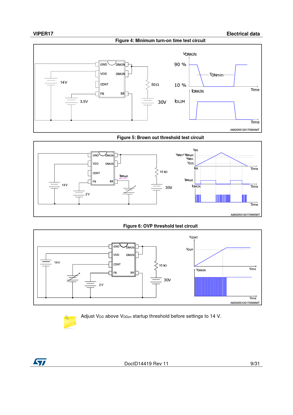

— VIPER17. Electrical data. Figure 4: Minimum turn-on time test circuit. …
2.4 Mb
VIPER17. Electrical data. Figure 4: Minimum turn-on time test circuit. Figure 5: Brown out threshold test circuit

Electrical data
Figure 6: OVP threshold test circuit
Adjust VDD above VDDon startup threshold before settings to 14 V. DocID14419 Rev 11 9/31
