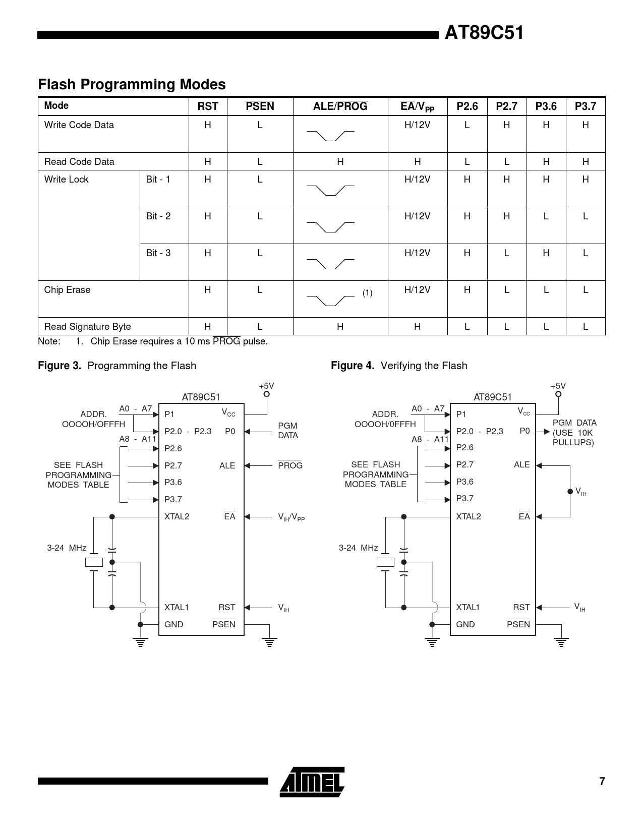

AT89C51. Flash Programming Modes. Mode. RST. PSEN. ALE/PROG. EA/V. P2.6. P2.7. P3.6. P3.7. Figure 3. Figure 4
AT89C51 Flash Programming Modes Mode RST PSEN ALE/PROG EA/V P2.6 P2.7 P3.6 P3.7 Figure 3 Figure 4
AT89C51 Flash Programming Modes Mode RST PSEN ALE/PROG EA/V P2.6 P2.7 P3.6 P3.7 PP
Write Code Data H L H/12V L H H H Read Code Data H L H H L L H H Write Lock Bit - 1 H L H/12V H H H H Bit - 2 H L H/12V H H L L Bit - 3 H L H/12V H L H L Chip Erase H L H/12V H L L L (1) Read Signature Byte H L H H L L L L Note: 1. Chip Erase requires a 10 ms PROG pulse.
Figure 3.
Programming the Flash
Figure 4.
Verifying the Flash +5V +5V AT89C51 AT89C51 A0 - A7 A0 - A7 ADDR. P1 V V CC ADDR. P1 CC OOOOH/OFFFH PGM OOOOH/0FFFH PGM DATA P2.0 - P2.3 P0 P2.0 - P2.3 P0 (USE 10K A8 - A11 DATA A8 - A11 PULLUPS) P2.6 P2.6 SEE FLASH P2.7 ALE PROG SEE FLASH P2.7 ALE PROGRAMMING PROGRAMMING P3.6 MODES TABLE P3.6 MODES TABLE VIH P3.7 P3.7 XTAL2 EA V /V XTAL2 EA IH PP 3-24 MHz 3-24 MHz XTAL1 RST V XTAL1 RST V IH IH GND PSEN GND PSEN
