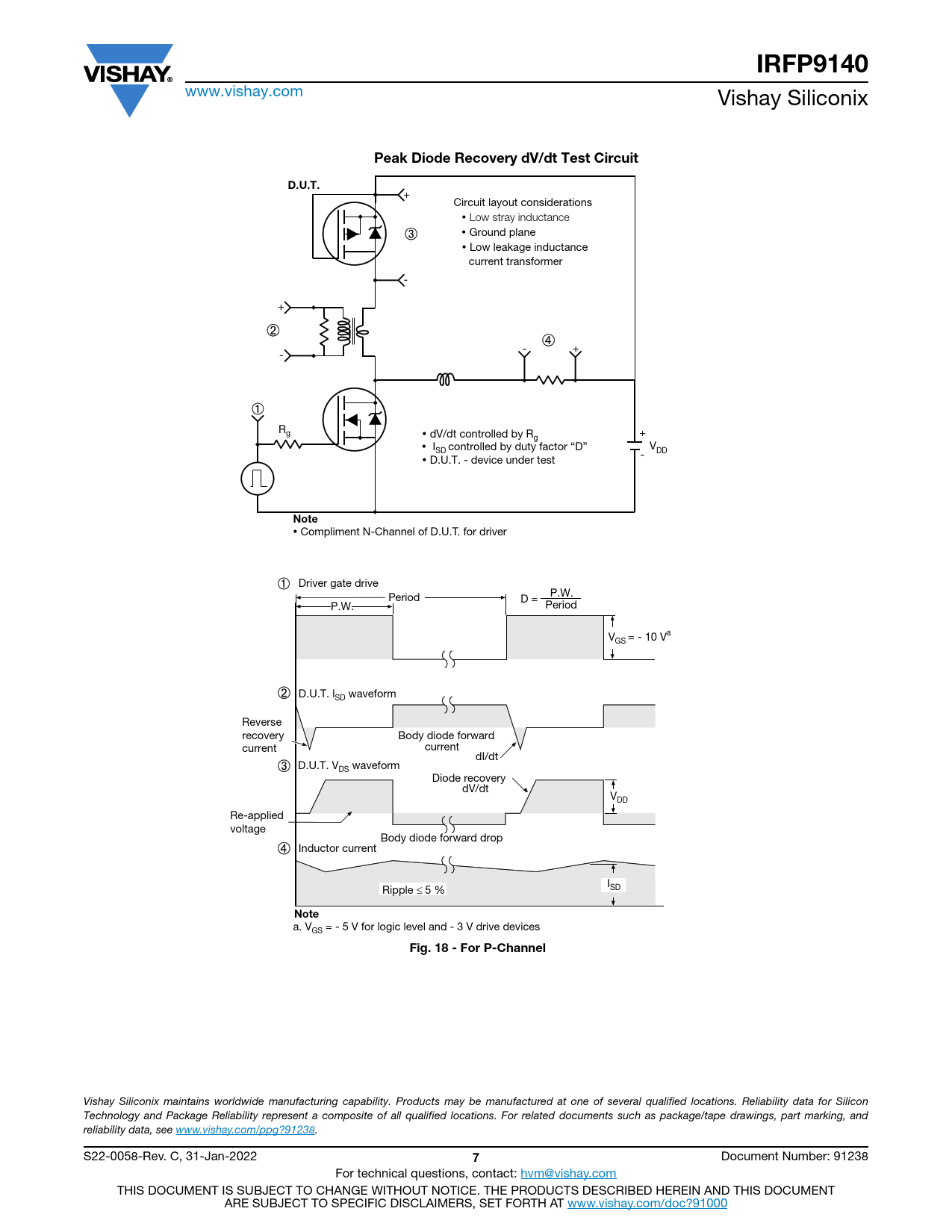

Pages / Page11 / 7 — IRFP9140. Peak Diode Recovery dV/dt Test Circuit. D.U.T. Note. Fig. 18 - …
IRFP9140. Peak Diode Recovery dV/dt Test Circuit. D.U.T. Note. Fig. 18 - For P-Channel
IRFP9140 Peak Diode Recovery dV/dt Test Circuit D.U.T Note Fig 18 - For P-Channel
IRFP9140
Peak Diode Recovery dV/dt Test Circuit D.U.T.
+ Circuit layout considerations • Low stray inductance • Ground plane • Low leakage inductance current transformer - + - - + Rg • dV/dt controlled by R + g • I V SD controlled by duty factor “D” - DD • D.U.T. - device under test
Note
• Compliment N-Channel of D.U.T. for driver Driver gate drive Period P.W. D = P.W. Period V = - 10 Va GS D.U.T. l waveform SD Reverse recovery Body diode forward current current dI/dt D.U.T. V waveform DS Diode recovery dV/dt VDD Re-applied voltage Body diode forward drop Inductor current I Ripple ≤ 5 % SD
Note
a. V = - 5 V for logic level and - 3 V drive devices GS
