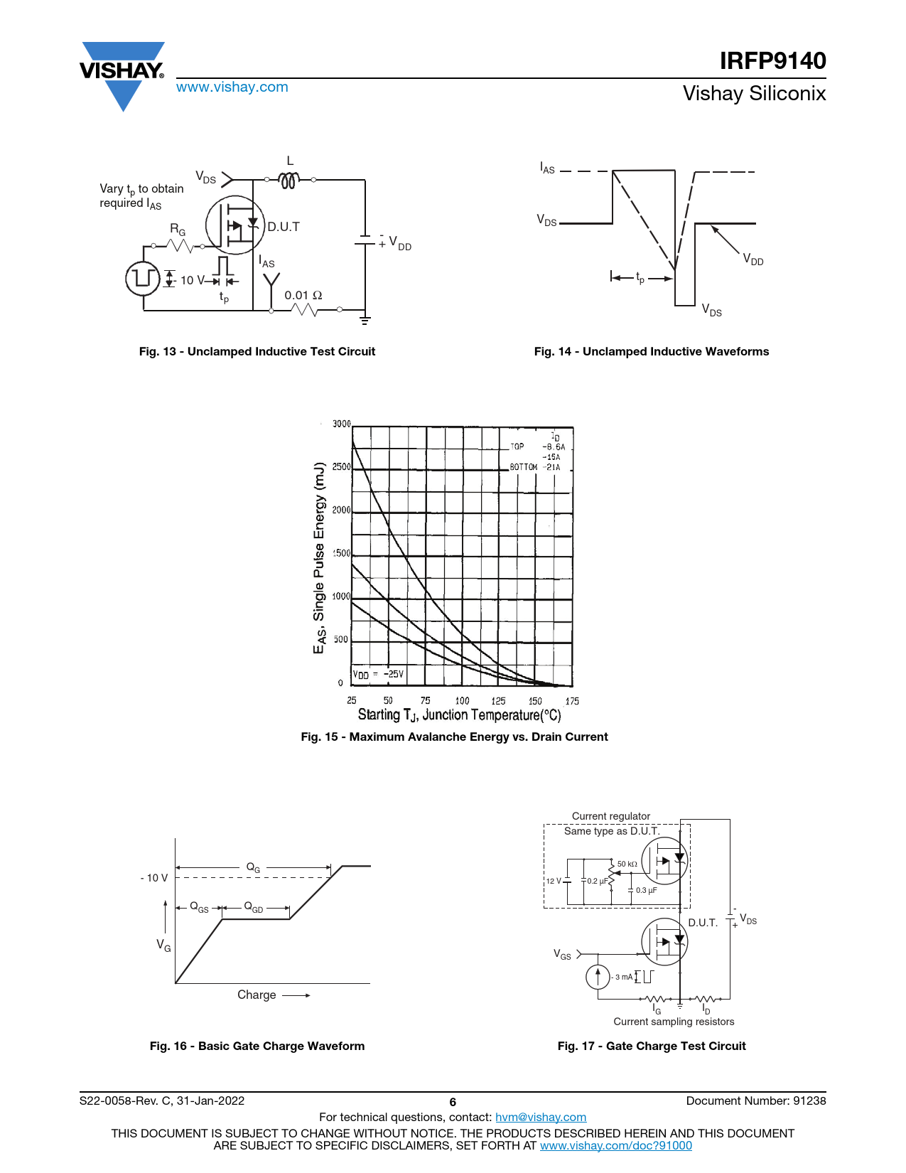

Pages / Page11 / 6 — IRFP9140. Fig. 13 - Unclamped Inductive Test Circuit. Fig. 14 - Unclamped …
IRFP9140. Fig. 13 - Unclamped Inductive Test Circuit. Fig. 14 - Unclamped Inductive Waveforms
IRFP9140 Fig 13 - Unclamped Inductive Test Circuit Fig 14 - Unclamped Inductive Waveforms
IRFP9140
www.vishay.com Vishay Siliconix L I V AS DS Vary tp to obtain required IAS VDS R D.U.T G -+ VDD I V AS DD - 10 V tp t 0.01 p Ω VDS
Fig. 13 - Unclamped Inductive Test Circuit Fig. 14 - Unclamped Inductive Waveforms Fig. 15 - Maximum Avalanche Energy vs. Drain Current
Current regulator Same type as D.U.T. Q 50 kΩ G - 10 V 12 V 0.2 µF 0.3 µF Q Q - GS GD + V D.U.T. DS VG VGS - 3 mA Charge I I G D Current sampling resistors
Fig. 16 - Basic Gate Charge Waveform Fig. 17 - Gate Charge Test Circuit
