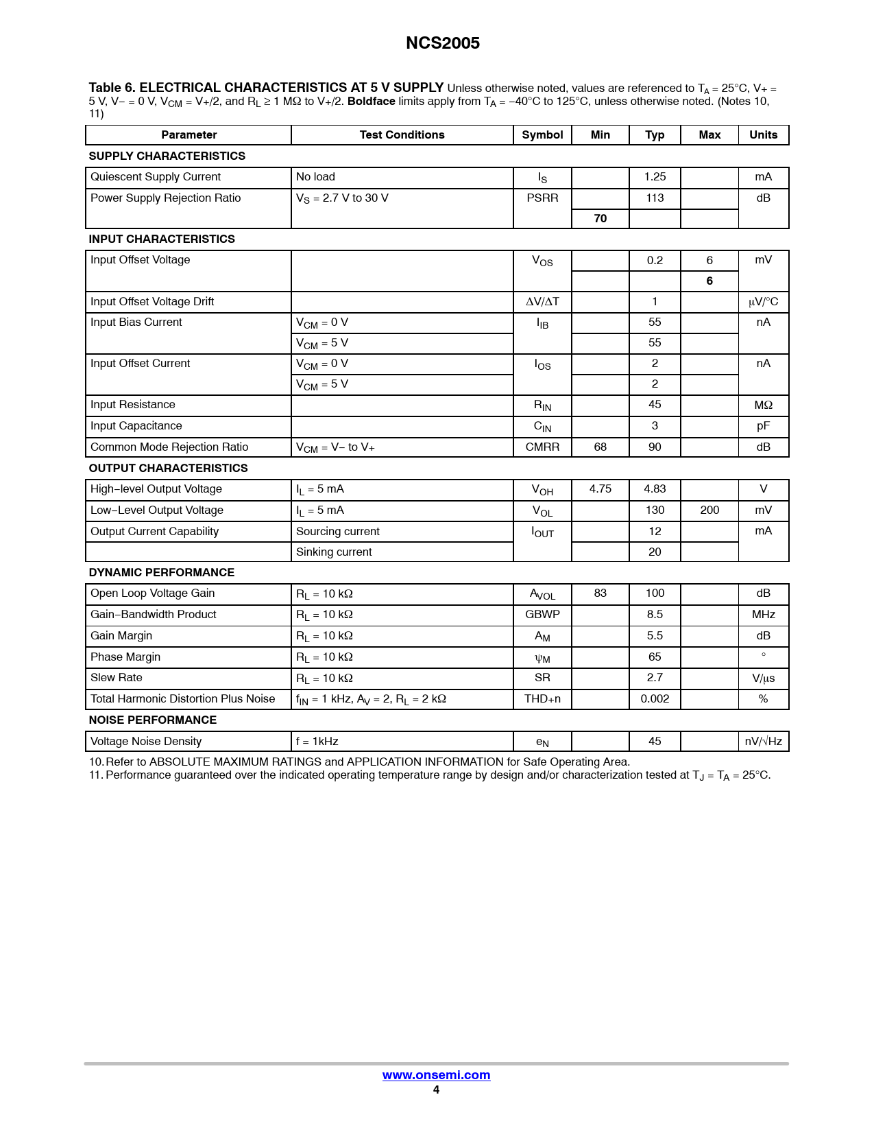

NCS2005 Table 6. ELECTRICAL CHARACTERISTICS AT 5 V SUPPLY
Unless otherwise noted, values are referenced to TA = 25°C, V+ = 5 V, V− = 0 V, VCM = V+/2, and RL ≥ 1 MW to V+/2.
Boldface
limits apply from TA = −40°C to 125°C, unless otherwise noted. (Notes 10, 11)
Parameter Test Conditions Symbol Min Typ Max Units SUPPLY CHARACTERISTICS
Quiescent Supply Current No load IS 1.25 mA Power Supply Rejection Ratio VS = 2.7 V to 30 V PSRR 113 dB
70 INPUT CHARACTERISTICS
Input Offset Voltage VOS 0.2 6 mV
6
Input Offset Voltage Drift DV/DT 1 mV/°C Input Bias Current VCM = 0 V IIB 55 nA VCM = 5 V 55 Input Offset Current VCM = 0 V IOS 2 nA VCM = 5 V 2 Input Resistance RIN 45 MW Input Capacitance CIN 3 pF Common Mode Rejection Ratio VCM = V− to V+ CMRR 68 90 dB
OUTPUT CHARACTERISTICS
High−level Output Voltage IL = 5 mA VOH 4.75 4.83 V Low−Level Output Voltage IL = 5 mA VOL 130 200 mV Output Current Capability Sourcing current IOUT 12 mA Sinking current 20
DYNAMIC PERFORMANCE
Open Loop Voltage Gain RL = 10 kW AVOL 83 100 dB Gain−Bandwidth Product RL = 10 kW GBWP 8.5 MHz Gain Margin RL = 10 kW AM 5.5 dB Phase Margin RL = 10 kW yM 65 ° Slew Rate RL = 10 kW SR 2.7 V/ms Total Harmonic Distortion Plus Noise fIN = 1 kHz, AV = 2, RL = 2 kW THD+n 0.002 %
NOISE PERFORMANCE
Voltage Noise Density f = 1kHz eN 45 nV/√Hz 10.Refer to ABSOLUTE MAXIMUM RATINGS and APPLICATION INFORMATION for Safe Operating Area. 11. Performance guaranteed over the indicated operating temperature range by design and/or characterization tested at TJ = TA = 25°C.
