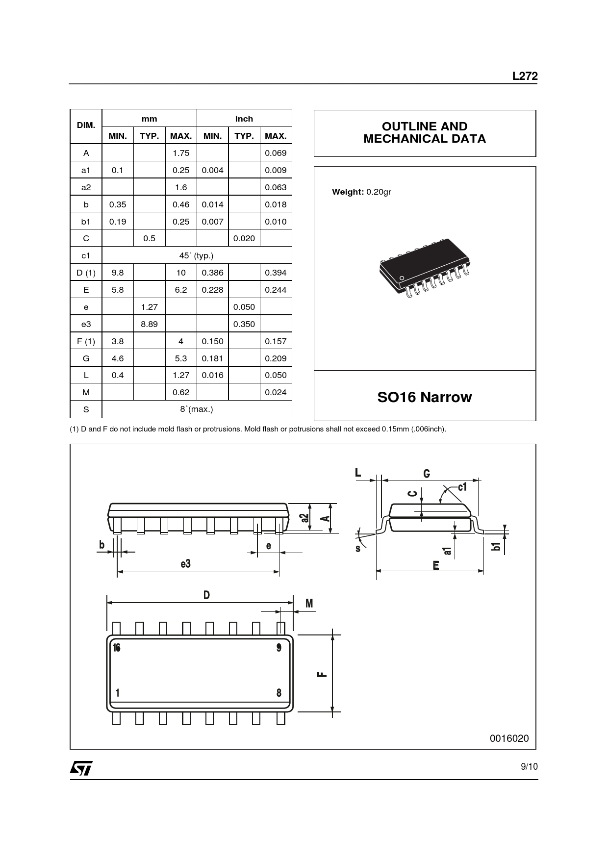

Pages / Page10 / 9 — L272. inch. DIM. OUTLINE AND. MIN. TYP. MAX. MECHANICAL DATA. Weight:. …
File Format / SizePDF / 913 Kb
L272. inch. DIM. OUTLINE AND. MIN. TYP. MAX. MECHANICAL DATA. Weight:. SO16 Narrow
L272 inch DIM OUTLINE AND MIN TYP MAX MECHANICAL DATA Weight: SO16 Narrow
L272 mm inch DIM. OUTLINE AND MIN. TYP. MAX. MIN. TYP. MAX. MECHANICAL DATA
A 1.75 0.069 a1 0.1 0.25 0.004 0.009 a2 1.6 0.063
Weight:
0.20gr b 0.35 0.46 0.014 0.018 b1 0.19 0.25 0.007 0.010 C 0.5 0.020 c1 45˚ (typ.) D (1) 9.8 10 0.386 0.394 E 5.8 6.2 0.228 0.244 e 1.27 0.050 e3 8.89 0.350 F (1) 3.8 4 0.150 0.157 G 4.6 5.3 0.181 0.209 L 0.4 1.27 0.016 0.050 M 0.62 0.024
SO16 Narrow
S 8˚(max.) (1) D and F do not include mold flash or protrusions. Mold flash or potrusions shall not exceed 0.15mm (.006inch). 0016020 9/10
