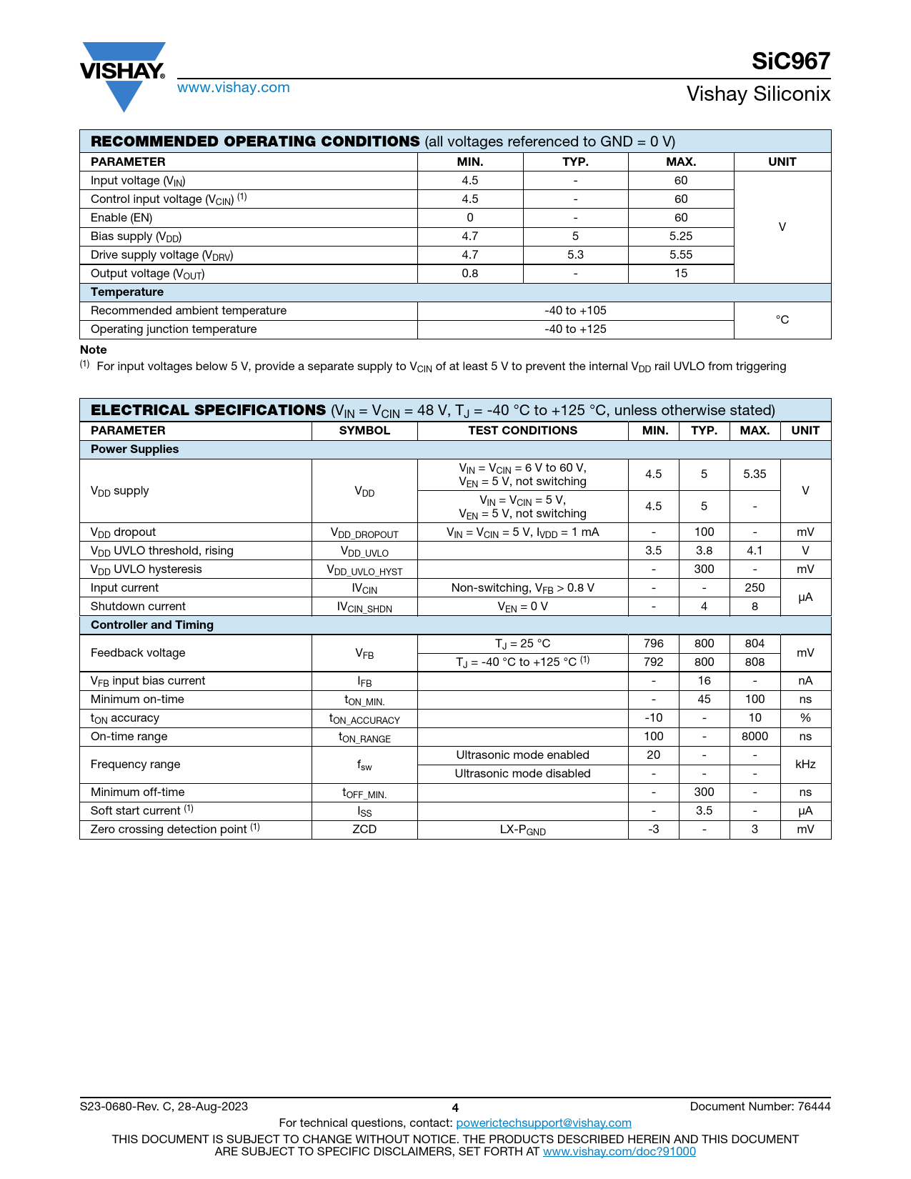

SiC967. RECOMMENDED OPERATING CONDITIONS. PARAMETER MIN. TYP. MAX. UNIT. Temperature. Note. ELECTRICAL SPECIFICATIONS. PARAMETER. SYMBOL
SiC967 RECOMMENDED OPERATING CONDITIONS PARAMETER MIN TYP MAX UNIT Temperature Note ELECTRICAL SPECIFICATIONS PARAMETER SYMBOL
SiC967
(all voltages referenced to GND = 0 V)
Input voltage (VIN) 4.5 - 60 Control input voltage (VCIN) (1) 4.5 - 60 Enable (EN) 0 - 60 V Bias supply (VDD) 4.7 5 5.25 Drive supply voltage (VDRV) 4.7 5.3 5.55 Output voltage (VOUT) 0.8 - 15
Temperature
Recommended ambient temperature -40 to +105 °C Operating junction temperature -40 to +125
Note
(1) For input voltages below 5 V, provide a separate supply to VCIN of at least 5 V to prevent the internal VDD rail UVLO from triggering
(VIN = VCIN = 48 V, TJ = -40 °C to +125 °C, unless otherwise stated)
PARAMETER SYMBOL TEST CONDITIONS MIN. TYP. MAX. UNIT Power Supplies
VIN = VCIN = 6 V to 60 V, 4.5 5 5.35 VEN = 5 V, not switching VDD supply VDD V VIN = VCIN = 5 V, 4.5 5 - VEN = 5 V, not switching VDD dropout VDD_DROPOUT VIN = VCIN = 5 V, IVDD = 1 mA - 100 - mV VDD UVLO threshold, rising VDD_UVLO 3.5 3.8 4.1 V VDD UVLO hysteresis VDD_UVLO_HYST - 300 - mV Input current IVCIN Non-switching, VFB > 0.8 V - - 250 μA Shutdown current IVCIN_SHDN VEN = 0 V - 4 8
Controller and Timing
TJ = 25 °C 796 800 804 Feedback voltage VFB mV TJ = -40 °C to +125 °C (1) 792 800 808 VFB input bias current IFB - 16 - nA Minimum on-time tON_MIN. - 45 100 ns tON accuracy tON_ACCURACY -10 - 10 % On-time range tON_RANGE 100 - 8000 ns Ultrasonic mode enabled 20 - - Frequency range fsw kHz Ultrasonic mode disabled - - - Minimum off-time tOFF_MIN. - 300 - ns Soft start current (1) ISS - 3.5 - μA Zero crossing detection point (1) ZCD LX-PGND -3 - 3 mV S23-0680-Rev. C, 28-Aug-2023
