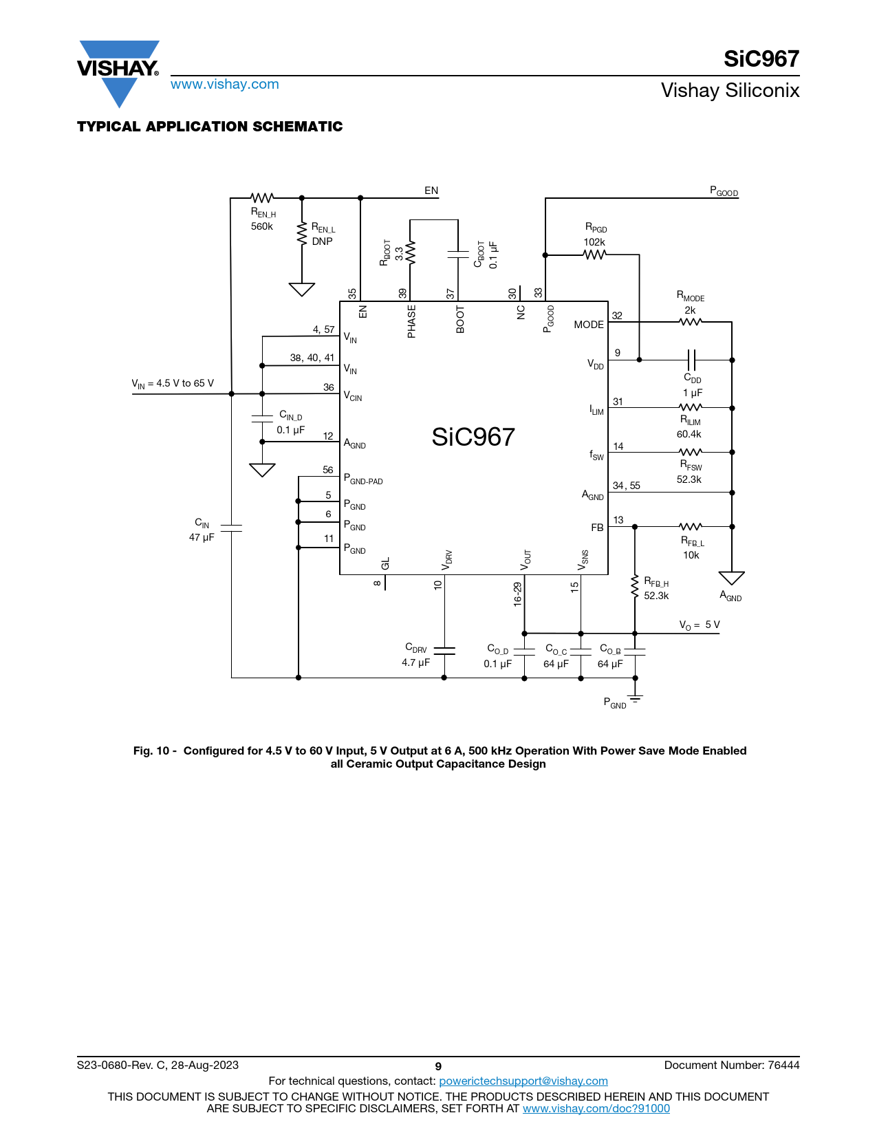

SiC967. TYPICAL APPLICATION SCHEMATIC
SiC967 TYPICAL APPLICATION SCHEMATIC
SiC967
EN PGOOD REN_H 560k REN_L RPGD T DNP T F 102k O 3 O R BO 3. 1 µ C BO 0. 35 39 37 30 33 RMODE D O 2k EN SE A NC 32 OOT MODE 4, 57 B P GO V PH IN 9 38, 40, 41 VDD VIN CDD VIN = 4.5 V to 65 V 36 V 1 µF CIN 31 ILIM CIN_D RILIM 0.1 µF 12 60.4k A SiC967 GND 14 fSW RFSW 56 PGND-PAD 52.3k 34, 55 5 AGND PGND 6 C 13 IN PGND FB 47 µF 11 RFB_L PGND V S 10k GL V DR V OUT V SN 8 RFB_H 10 29 15 52.3k AGND 16- VO = 5 V CDRV CO_D CO_C CO_B 4.7 µF 0.1 µF 64 µF 64 µF PGND
Fig. 10 - Configured for 4.5 V to 60 V Input, 5 V Output at 6 A, 500 kHz Operation With Power Save Mode Enabled all Ceramic Output Capacitance Design
