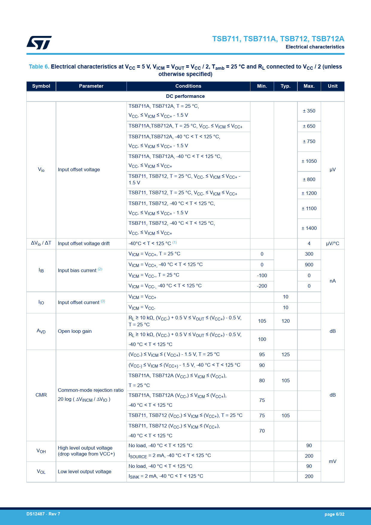

TSB711, TSB711A, TSB712, TSB712A. Electrical characteristics
TSB711, TSB711A, TSB712, TSB712A Electrical characteristics
link to page 7 link to page 7 link to page 7
TSB711, TSB711A, TSB712, TSB712A Electrical characteristics Table 6. Electrical characteristics at VCC = 5 V, VICM = VOUT = VCC / 2, Tamb = 25 °C and RL connected to VCC / 2 (unless otherwise specified) Symbol Parameter Conditions Min. Typ. Max. Unit DC performance
TSB711A, TSB712A, T = 25 °C, ± 350 VCC- ≤ VICM ≤ VCC+ - 1.5 V TSB711A,TSB712A, T = 25 °C, VCC- ≤ VICM ≤ VCC+ ± 650 TSB711A,TSB712A, -40 °C < T < 125 °C, ± 750 VCC- ≤ VICM ≤ VCC+ - 1.5 V TSB711A, TSB712A, -40 °C < T < 125 °C, ± 1050 V V CC- ≤ VICM ≤ VCC+ io Input offset voltage µV TSB711, TSB712, T = 25 °C, VCC- ≤ VICM ≤ VCC+ - ± 800 1.5 V TSB711, TSB712, T = 25 °C, VCC- ≤ VICM ≤ VCC+ ± 1200 TSB711, TSB712, -40 °C < T < 125 °C, ± 1100 VCC- ≤ VICM ≤ VCC+ - 1.5 V TSB711, TSB712, -40 °C < T < 125 °C, ± 1400 VCC- ≤ VICM ≤ VCC+ ΔVio / ΔT Input offset voltage drift -40°C < T < 125 °C (1) 4 µV/°C VICM = VCC+, T = 25 °C 0 300 VICM = VCC+, -40 °C < T < 125 °C 0 900 IIB Input bias current (2) VICM = VCC-, T = 25 °C -100 0 nA VICM = VCC-, -40 °C < T < 125 °C -200 0 VICM = VCC+ 10 IIO Input offset current (3) VICM = VCC- 10 RL ≥ 10 kΩ, (VCC-) + 0.5 V ≤ VOUT ≤ (VCC+) - 0.5 V, 105 120 T = 25 °C AVD Open loop gain dB RL ≥ 10 kΩ, (VCC-) + 0.5 V ≤ VOUT ≤ (VCC+) - 0.5 V, 100 -40 °C < T < 125 °C (VCC-) ≤ VICM ≤ ( VCC+) - 1.5 V, T = 25 °C 95 125 (VCC-) ≤ VICM ≤ (VCC+) - 1.5 V, -40 °C < T < 125 °C 90 TSB711A, TSB712A (VCC-) ≤ VICM ≤ (VCC+), 80 105 T = 25 °C Common-mode rejection ratio CMR TSB711A, TSB712A (V dB 20 log ( ∆V CC-) ≤ VICM ≤ (VCC+), INCM / ∆VIO ) 75 -40 °C < T < 125 °C TSB711, TSB712 (VCC-) ≤ VICM ≤ (VCC+), T = 25 °C 75 105 TSB711, TSB712 (VCC-) ≤ VICM ≤ (VCC+), 70 -40 °C < T < 125 °C No load, -40 °C < T < 125 °C 90 V High level output voltage OH (drop voltage from VCC+) ISOURCE = 2 mA, -40 °C < T < 125 °C 200 mV No load, -40 °C < T < 125 °C 90 VOL Low level output voltage ISINK = 2 mA, -40 °C < T < 125 °C 200
