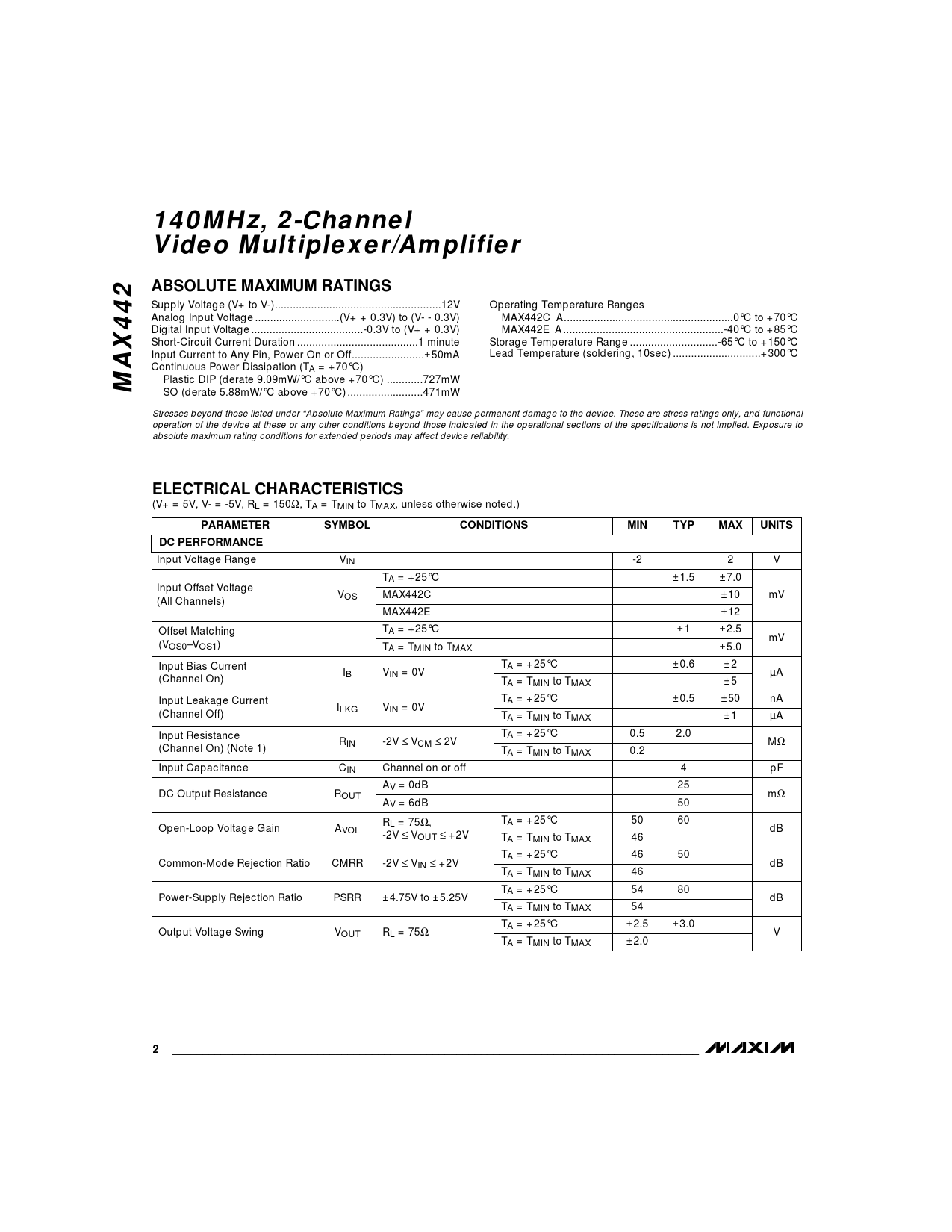

140MHz, 2-Channel Video Multiplexer/Amplifier. ABSOLUTE MAXIMUM RATINGS. MAX442. ELECTRICAL CHARACTERISTICS. PARAMETER. SYMBOL
140MHz, 2-Channel Video Multiplexer/Amplifier ABSOLUTE MAXIMUM RATINGS MAX442 ELECTRICAL CHARACTERISTICS PARAMETER SYMBOL
Supply Voltage (V+ to V-)...12V Operating Temperature Ranges Analog Input Voltage ..(V+ + 0.3V) to (V- - 0.3V) MAX442C_A..0°C to +70°C Digital Input Voltage ...-0.3V to (V+ + 0.3V) MAX442E_A ...-40°C to +85°C Short-Circuit Current Duration ..1 minute Storage Temperature Range ...-65°C to +150°C Input Current to Any Pin, Power On or Off..±50mA Lead Temperature (soldering, 10sec) ...+300°C Continuous Power Dissipation (TA = +70°C)
MAX442
Plastic DIP (derate 9.09mW/°C above +70°C) ..727mW SO (derate 5.88mW/°C above +70°C) ...471mW Stresses beyond those listed under “Absolute Maximum Ratings” may cause permanent damage to the device. These are stress ratings only, and functional operation of the device at these or any other conditions beyond those indicated in the operational sections of the specifications is not implied. Exposure to absolute maximum rating conditions for extended periods may affect device reliability.
(V+ = 5V, V- = -5V, RL = 150Ω, TA = TMIN to TMAX, unless otherwise noted.)
PARAMETER SYMBOL CONDITIONS MIN TYP MAX UNITS DC PERFORMANCE
Input Voltage Range VIN -2 2 V TA = +25°C ±1.5 ±7.0 Input Offset Voltage VOS MAX442C ±10 mV (All Channels) MAX442E ±12 TA = +25°C ±1 ±2.5 Offset Matching mV (VOS0–VOS1) TA = TMIN to TMAX ±5.0 TA = +25°C ±0.6 ±2 Input Bias Current IB VIN = 0V µA (Channel On) TA = TMIN to TMAX ±5 T Input Leakage Current A = +25°C ±0.5 ±50 nA ILKG VIN = 0V (Channel Off) TA = TMIN to TMAX ±1 µA T Input Resistance A = +25°C 0.5 2.0 RIN -2V ≤ VCM ≤ 2V MΩ (Channel On) (Note 1) TA = TMIN to TMAX 0.2 Input Capacitance CIN Channel on or off 4 pF AV = 0dB 25 DC Output Resistance ROUT mΩ AV = 6dB 50 RL = 75Ω, TA = +25°C 50 60 Open-Loop Voltage Gain AVOL dB -2V ≤ VOUT ≤ +2V TA = TMIN to TMAX 46 TA = +25°C 46 50 Common-Mode Rejection Ratio CMRR -2V ≤ VIN ≤ +2V dB TA = TMIN to TMAX 46 TA = +25°C 54 80 Power-Supply Rejection Ratio PSRR ±4.75V to ±5.25V dB TA = TMIN to TMAX 54 TA = +25°C ±2.5 ±3.0 Output Voltage Swing VOUT RL = 75Ω V TA = TMIN to TMAX ±2.0
