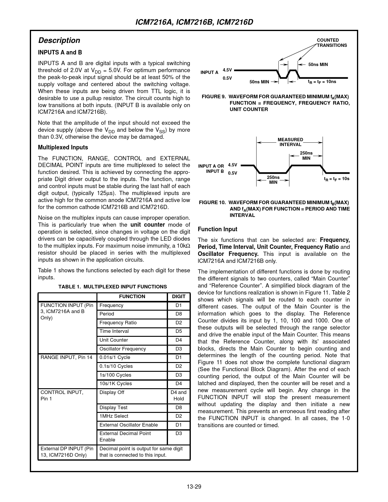

ICM7216A, ICM7216B, ICM7216D. Description. COUNTED TRANSITIONS. INPUTS A and B. 50ns MIN. 4.5V. INPUT A. 0.5V. tR = tF = 10ns
ICM7216A, ICM7216B, ICM7216D Description COUNTED TRANSITIONS INPUTS A and B 50ns MIN 4.5V INPUT A 0.5V tR = tF = 10ns
INPUTS A and B are digital inputs with a typical switching
50ns MIN
threshold of 2.0V at VDD = 5.0V. For optimum performance
4.5V INPUT A
the peak-to-peak input signal should be at least 50% of the
0.5V
supply voltage and centered about the switching voltage.
50ns MIN tR = tF = 10ns
When these inputs are being driven from TTL logic, it is desirable to use a pullup resistor. The circuit counts high to
FIGURE 9. WAVEFORM FOR GUARANTEED MINIMUM fA(MAX)
low transitions at both inputs. (INPUT B is available only on
FUNCTION = FREQUENCY, FREQUENCY RATIO, UNIT COUNTER
lCM7216A and lCM7216B). Note that the amplitude of the input should not exceed the device supply (above the VDD and below the VSS) by more than 0.3V, otherwise the device may be damaged.
MEASURED INTERVAL Multiplexed Inputs 250ns
The FUNCTION, RANGE, CONTROL and EXTERNAL
MIN
DECIMAL POINT inputs are time multiplexed to select the
INPUT A OR 4.5V
function desired. This is achieved by connecting the appro-
INPUT B 0.5V
priate Digit driver output to the inputs. The function, range
250ns tR = tF = 10s MIN
and control inputs must be stable during the last half of each digit output, (typically 125µs). The multiplexed inputs are active high for the common anode lCM7216A and active low
FIGURE 10. WAVEFORM FOR GUARANTEED MINIMUM fB(MAX)
for the common cathode lCM7216B and lCM7216D.
AND fA(MAX) FOR FUNCTION = PERIOD AND TIME INTERVAL
Noise on the multiplex inputs can cause improper operation. This is particularly true when the
unit counter
mode of operation is selected, since changes in voltage on the digit
Function Input
drivers can be capacitively coupled through the LED diodes The six functions that can be selected are:
Frequency,
to the multiplex inputs. For maximum noise immunity, a 10kΩ
Period, Time Interval, Unit Counter, Frequency Ratio
and resistor should be placed in series with the multiplexed
Oscillator Frequency.
This input is available on the inputs as shown in the application circuits. lCM7216A and lCM7216B only. Table 1 shows the functions selected by each digit for these The implementation of different functions is done by routing inputs. the different signals to two counters, called “Main Counter”
