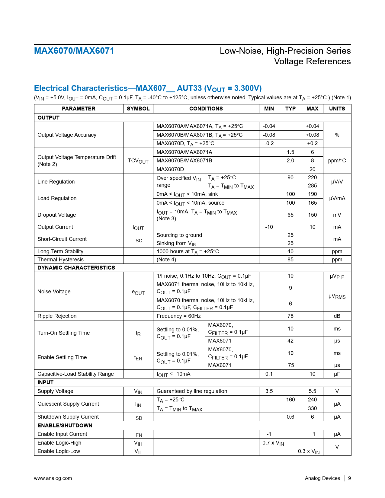

MAX6070/MAX6071. Electrical Characteristics—MAX607__ AUT33 (VOUT = 3.300V). PARAMETER. SYMBOL. CONDITIONS. MIN. TYP. MAX. UNITS. OUTPUT
MAX6070/MAX6071 Electrical Characteristics—MAX607__ AUT33 (VOUT = 3.300V) PARAMETER SYMBOL CONDITIONS MIN TYP MAX UNITS OUTPUT
MAX6070
MAX6071
MAX6070/MAX6071
Low-Noise, High-Precision Series Voltage References
(VIN = +5.0V, IOUT = 0mA, COUT = 0.1µF, TA = -40°C to +125°C, unless otherwise noted. Typical values are at TA = +25°C.) (Note 1)
MAX6070A/MAX6071A, TA = +25°C -0.04 +0.04 Output Voltage Accuracy MAX6070B/MAX6071B, TA = +25°C -0.08 +0.08 % MAX6070D, TA = +25°C -0.2 +0.2 MAX6070A/MAX6071A 1.5 6 Output Voltage Temperature Drift (Note 2) TCVOUT MAX6070B/MAX6071B 2.0 8 ppm/°C MAX6070D 20 T Line Regulation Over specified VIN A = +25°C 90 220 range µV/V TA = TMIN to TMAX 285 0mA < I Load Regulation OUT < 10mA, sink 100 190 µV/mA 0mA < IOUT < 10mA, source 100 165 Dropout Voltage IOUT = 10mA, TA = TMIN to TMAX (Note 3) 65 150 mV Output Current IOUT -10 10 mA Sourcing to ground 25 Short-Circuit Current ISC mA Sinking from VIN 25 Long-Term Stability 1000 hours at TA = +25°C 40 ppm Thermal Hysteresis (Note 4) 85 ppm
DYNAMIC CHARACTERISTICS
1/f noise, 0.1Hz to 10Hz, COUT = 0.1µF 10 µVP-P MAX6071 thermal noise, 10Hz to 10kHz, Noise Voltage eOUT COUT = 0.1µF 9 µVRMS MAX6070 thermal noise, 10Hz to 10kHz, COUT = 0.1µF, CFILTER = 0.1µF 6 Ripple Rejection Frequency = 60Hz 78 dB MAX6070, Turn-On Settling Time t Settling to 0.01%, R C C FILTER = 0.1µF 10 ms OUT = 0.1µF MAX6071 42 µs MAX6070, Enable Settling Time t Settling to 0.01%, EN C C FILTER = 0.1µF 10 ms OUT = 0.1µF MAX6071 75 µs Capacitive-Load Stability Range IOUT ≤ 10mA 0.1 10 µF
INPUT
Supply Voltage VIN Guaranteed by line regulation 3.5 5.5 V T Quiescent Supply Current I A = +25°C 160 240 IN µA TA = TMIN to TMAX 330 Shutdown Supply Current ISD 0.6 6 µA
ENABLE/SHUTDOWN
Enable Input Current IEN -1 +1 µA Enable Logic-High VIH 0.7 x VIN V Enable Logic-Low VIL 0.3 x VIN www.analog.com Analog Devices │ 9
