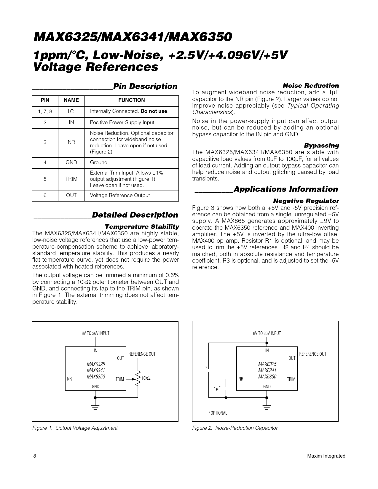

1ppm/°C, Low-Noise, +2.5V/+4.096V/+5V Voltage References. _____________________Pin Description. Noise Reduction. PIN. NAME
1ppm/°C, Low-Noise, +2.5V/+4.096V/+5V Voltage References _____________________Pin Description Noise Reduction PIN NAME
MAX6325/MAX6341/MAX6350 MAX6325/MAX6341/MAX6350
To augment wideband noise reduction, add a 1µF capacitor to the NR pin (Figure 2). Larger values do not
PIN NAME FUNCTION
improve noise appreciably (see Typical Operating 1, 7, 8 I.C. Internally Connected.
Do not use
. Characteristics). 2 IN Positive Power-Supply Input Noise in the power-supply input can affect output noise, but can be reduced by adding an optional Noise Reduction. Optional capacitor bypass capacitor to the IN pin and GND. connection for wideband noise 3 NR reduction. Leave open if not used
Bypassing
(Figure 2). The MAX6325/MAX6341/MAX6350 are stable with capacitive load values from 0µF to 100µF, for all values 4 GND Ground of load current. Adding an output bypass capacitor can External Trim Input. Allows ±1% help reduce noise and output glitching caused by load 5 TRIM output adjustment (Figure 1). transients. Leave open if not used.
__________Applications Information
6 OUT Voltage Reference Output
Negative Regulator
Figure 3 shows how both a +5V and -5V precision ref-
_______________Detailed Description
erence can be obtained from a single, unregulated +5V supply. A MAX865 generates approximately ±9V to
