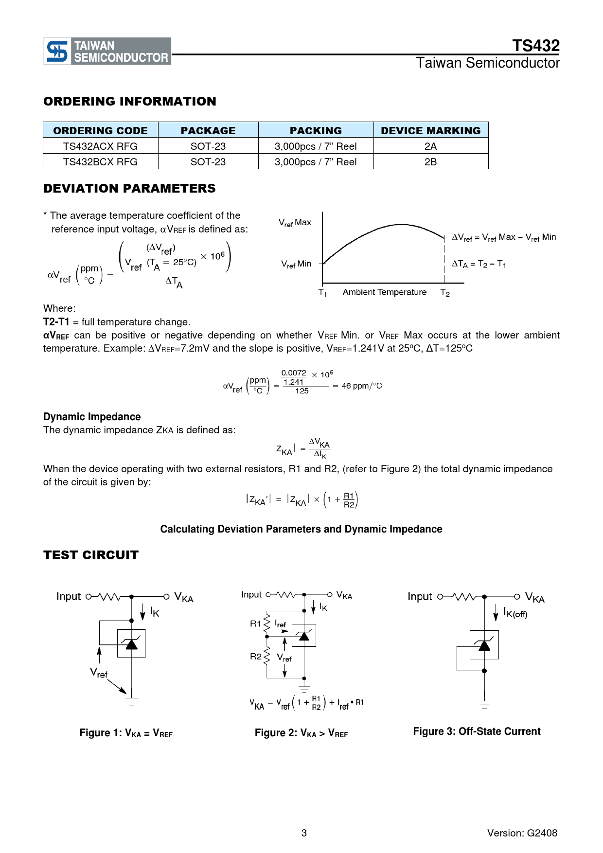

ORDERING INFORMATION ORDERING CODE PACKAGE PACKING DEVICE MARKING
TS432ACX RFG SOT-23 3,000pcs / 7” Reel 2A TS432BCX RFG SOT-23 3,000pcs / 7” Reel 2B
DEVIATION PARAMETERS
* The average temperature coefficient of the reference input voltage, VREF is defined as: Where:
T2-T1
= full temperature change.
αVREF
can be positive or negative depending on whether VREF Min. or VREF Max occurs at the lower ambient temperature. Example: ∆VREF=7.2mV and the slope is positive, VREF=1.241V at 25oC, ΔT=125oC
Dynamic Impedance
The dynamic impedance ZKA is defined as: When the device operating with two external resistors, R1 and R2, (refer to Figure 2) the total dynamic impedance of the circuit is given by:
Calculating Deviation Parameters and Dynamic Impedance TEST CIRCUIT Figure 1: V Figure 3: Off-State Current KA = VREF Figure 2: VKA > VREF
