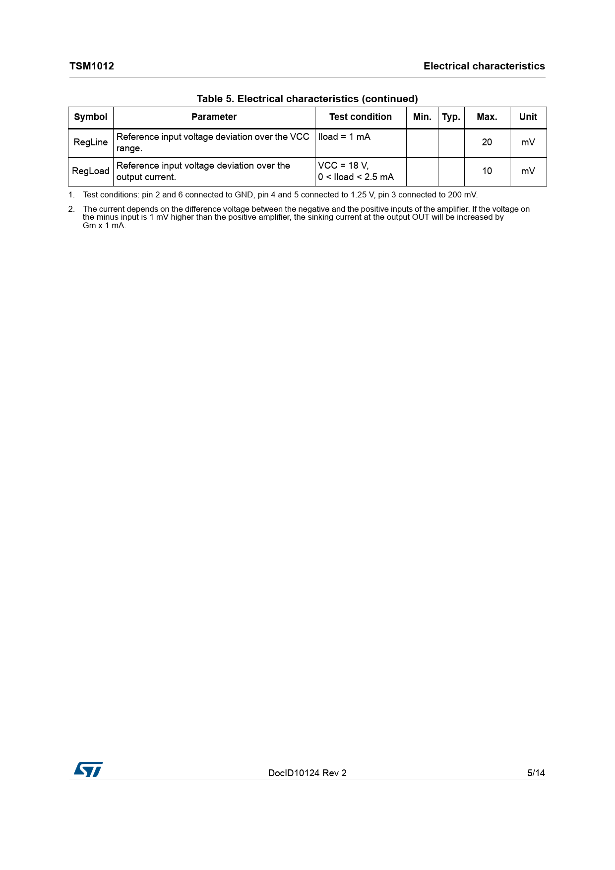

TSM1012. Electrical characteristics. Table 5. Electrical characteristics (continued). Symbol. Parameter. Test condition. Min. Typ
TSM1012 Electrical characteristics Table 5 Electrical characteristics (continued) Symbol Parameter Test condition Min Typ
TSM1012 Electrical characteristics Table 5. Electrical characteristics (continued) Symbol Parameter Test condition Min. Typ. Max. Unit
Reference input voltage deviation over the VCC Iload = 1 mA RegLine 20 mV range. Reference input voltage deviation over the VCC = 18 V, RegLoad 10 mV output current. 0 < Iload < 2.5 mA 1. Test conditions: pin 2 and 6 connected to GND, pin 4 and 5 connected to 1.25 V, pin 3 connected to 200 mV. 2. The current depends on the difference voltage between the negative and the positive inputs of the amplifier. If the voltage on the minus input is 1 mV higher than the positive amplifier, the sinking current at the output OUT will be increased by Gm x 1 mA. DocID10124 Rev 2 5/14 14 Document Outline Figure 1. Pin connections (top view) Table 1. Order codes 1 Pin descriptions Table 2. SO-8 pinout 2 Absolute maximum ratings Table 3. Absolute maximum ratings 3 Operating conditions Table 4. Operating conditions 4 Electrical characteristics Table 5. Electrical characteristics 5 Internal schematics Figure 2. Internal schematic Figure 3. Typical adapter or battery charger application using TSM1012 6 Principle of operation and application hints 6.1 Voltage and current control 6.1.1 Voltage control 6.1.2 Current control Figure 4. Output voltage versus output current 6.2 Compensation 6.3 Start-up and short-circuit conditions 6.4 Voltage clamp Figure 5. Clamp voltage Figure 6. Typical application schematic 7 Package information 7.1 SO-8 package information Figure 7. SO-8 package outline Table 6. SO-8 package mechanical data 8 Revision history Table 7. Document revision history
