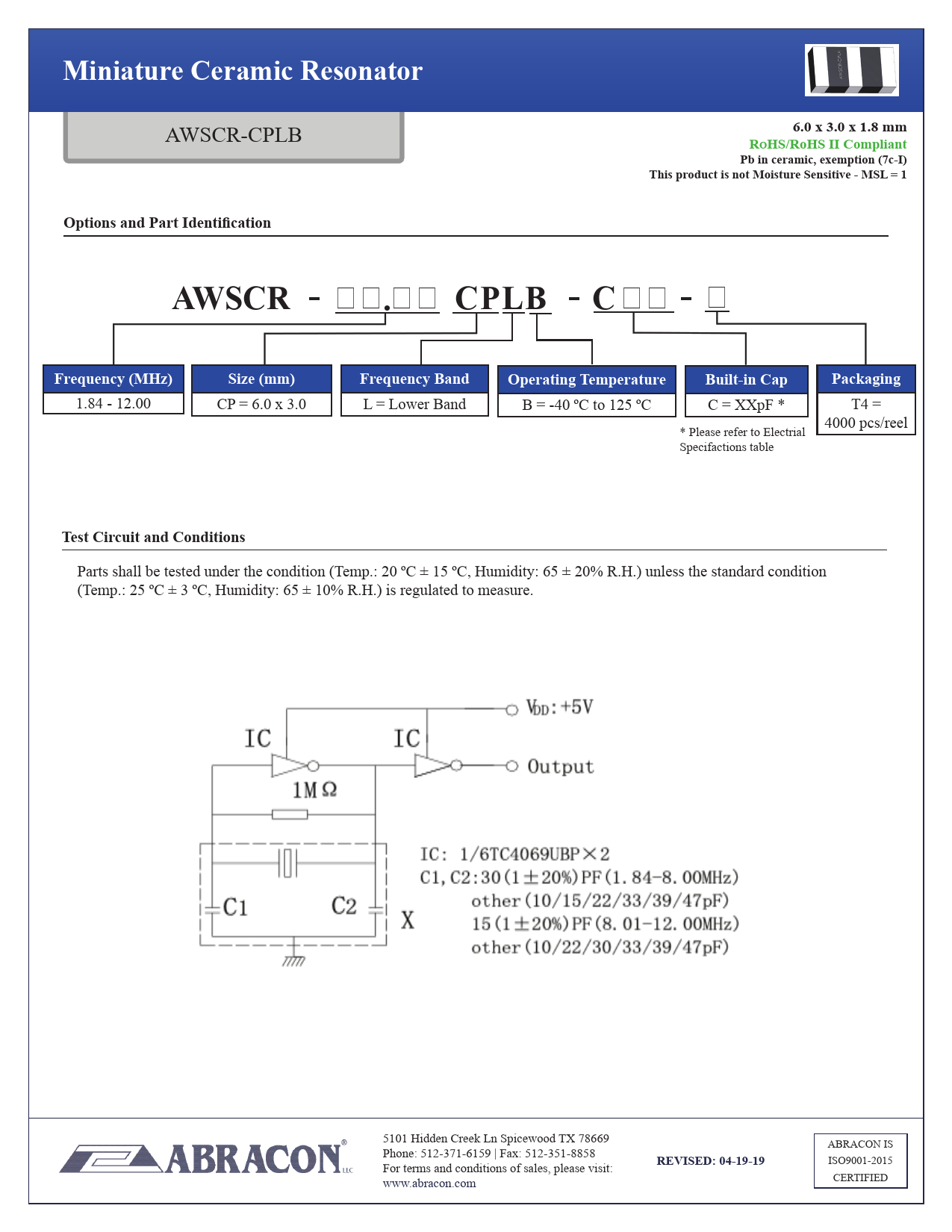

DescriptionSMD Ceramic Resonator with Internal Capacitors
Pages / Page6 / 2 — Miniature Ceramic Resonator. 6.0 x 3.0 x 1.8 mm. RoHS/RoHS II Compliant. …
File Format / SizePDF / 678 Kb
Miniature Ceramic Resonator. 6.0 x 3.0 x 1.8 mm. RoHS/RoHS II Compliant. Pb in ceramic, exemption (7c-I)
Miniature Ceramic Resonator 6.0 x 3.0 x 1.8 mm RoHS/RoHS II Compliant Pb in ceramic, exemption (7c-I)
AWSCR-CPLB
RoHS/RoHS II Compliant Pb in ceramic, exemption (7c-I) This product is not Moisture Sensitive - MSL = 1 Options and Part Identification AWSCR .   CPLB C  Frequency (MHz) Size (mm) Frequency Band Operating Temperature Built-in Cap Packaging
1.84 - 12.00 CP = 6.0 x 3.0 L = Lower Band B = -40 ºC to 125 ºC C = XXpF * T4 = 4000 pcs/reel * Please refer to Electrial Specifactions table
Test Circuit and Conditions
Parts shall be tested under the condition (Temp.: 20 ºC ± 15 ºC, Humidity: 65 ± 20% R.H.) unless the standard condition (Temp.: 25 ºC ± 3 ºC, Humidity: 65 ± 10% R.H.) is regulated to measure. 5101 Hidden Creek Ln Spicewood TX 78669 ABRACON IS Phone: 512-371-6159 | Fax: 512-351-8858
