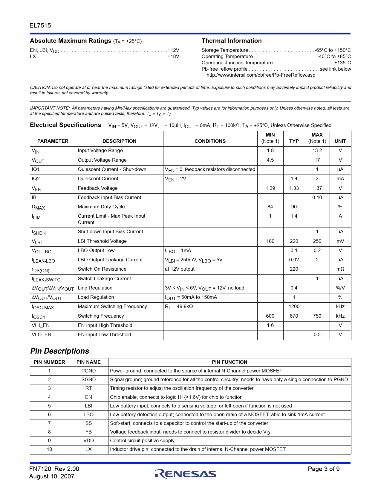

EL7515
Absolute Maximum Ratings
(TA = +25°C)
Thermal Information
EN, LBI, VDD . .+12V Storage Temperature . .-65°C to +150°C LX . .+18V Operating Temperature . .-40°C to +85°C Operating Junction Temperature: . +135°C Pb-free reflow profile . .see link below http://www.intersil.com/pbfree/Pb-FreeReflow.asp CAUTION: Do not operate at or near the maximum ratings listed for extended periods of time. Exposure to such conditions may adversely impact product reliability and result in failures not covered by warranty. IMPORTANT NOTE: All parameters having Min/Max specifications are guaranteed. Typ values are for information purposes only. Unless otherwise noted, all tests are at the specified temperature and are pulsed tests, therefore: TJ = TC = TA
Electrical Specifications
VIN = 5V, VOUT = 12V, L = 10µH, IOUT = 0mA, RT = 100k, TA = +25°C, Unless Otherwise Specified.
MIN MAX PARAMETER DESCRIPTION CONDITIONS
(Note 1)
TYP
(Note 1)
UNIT
VIN Input Voltage Range 1.8 13.2 V VOUT Output Voltage Range 4.5 17 V IQ1 Quiescent Current - Shut-down VEN = 0, feedback resistors disconnected 1 µA IQ2 Quiescent Current VEN = 2V 1.4 2 mA VFB Feedback Voltage 1.29 1.33 1.37 V IB Feedback Input Bias Current 0.10 µA DMAX Maximum Duty Cycle 84 90 % ILIM Current Limit - Max Peak Input 1 1.4 A Current ISHDN Shut-down Input Bias Current 1 µA VLBI LBI Threshold Voltage 180 220 250 mV VOL-LBO LBO Output Low ILBO = 1mA 0.1 0.2 V ILEAK-LBO LBO Output Leakage Current VLBI = 250mV, VLBO = 5V 0.02 2 µA rDS(ON) Switch On Resistance at 12V output 220 m ILEAK-SWITCH Switch Leakage Current 1 µA VOUT/VIN/VOUT Line Regulation 3V < VIN < 6V, VOUT = 12V, no load 0.4 %/V VOUT/VOUT Load Regulation IOUT = 50mA to 150mA 1 % fOSC-MAX Maximum Switching Frequency RT = 49.9k 1200 kHz fOSC1 Switching Frequency 600 670 750 kHz VHI_EN EN Input High Threshold 1.6 V VLO_EN EN Input Low Threshold 0.5 V
Pin Descriptions PIN NUMBER PIN NAME PIN FUNCTION
1 PGND Power ground; connected to the source of internal N-Channel power MOSFET 2 SGND Signal ground; ground reference for all the control circuitry; needs to have only a single connection to PGND 3 RT Timing resistor to adjust the oscillation frequency of the converter 4 EN Chip enable; connects to logic HI (>1.6V) for chip to function 5 LBI Low battery input; connects to a sensing voltage, or left open if function is not used 6 LBO Low battery detection output; connected to the open drain of a MOSFET; able to sink 1mA current 7 SS Soft-start; connects to a capacitor to control the start-up of the converter 8 FB Voltage feedback input; needs to connect to resistor divider to decide VO 9 VDD Control circuit positive supply 10 LX Inductor drive pin; connected to the drain of internal N-Channel power MOSFET FN7120 Rev 2.00 Page 3 of 9 August 10, 2007
