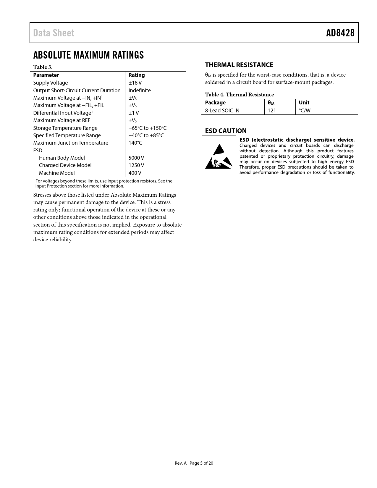

Data Sheet. AD8428. ABSOLUTE MAXIMUM RATINGS Table 3. THERMAL RESISTANCE. Parameter Rating. Table 4. Thermal Resistance. Package θ
Data Sheet AD8428 ABSOLUTE MAXIMUM RATINGS Table 3 THERMAL RESISTANCE Parameter Rating Table 4 Thermal Resistance Package θ
link to page 15 link to page 5 link to page 5
Data Sheet AD8428 ABSOLUTE MAXIMUM RATINGS Table 3. THERMAL RESISTANCE Parameter Rating
θJA is specified for the worst-case conditions, that is, a device Supply Voltage ±18 V soldered in a circuit board for surface-mount packages. Output Short-Circuit Current Duration Indefinite
Maximum Voltage at −IN, +IN1 ±VS
Package θ
Maximum Voltage at −FIL, +FIL ±V
JA Unit
S Differential Input Voltage1 ±1 V 8-Lead SOIC_N 121 °C/W Maximum Voltage at REF ±VS Storage Temperature Range −65°C to +150°C
ESD CAUTION
Specified Temperature Range −40°C to +85°C Maximum Junction Temperature 140°C ESD Human Body Model 5000 V Charged Device Model 1250 V Machine Model 400 V 1 For voltages beyond these limits, use input protection resistors. See the Input Protection section for more information. Stresses above those listed under Absolute Maximum Ratings may cause permanent damage to the device. This is a stress rating only; functional operation of the device at these or any other conditions above those indicated in the operational section of this specification is not implied. Exposure to absolute maximum rating conditions for extended periods may affect device reliability. Rev. A | Page 5 of 20 Document Outline FEATURES APPLICATIONS FUNCTIONAL BLOCK DIAGRAM GENERAL DESCRIPTION TABLE OF CONTENTS REVISION HISTORY SPECIFICATIONS ABSOLUTE MAXIMUM RATINGS THERMAL RESISTANCE ESD CAUTION PIN CONFIGURATION AND FUNCTION DESCRIPTIONS TYPICAL PERFORMANCE CHARACTERISTICS THEORY OF OPERATION ARCHITECTURE FILTER TERMINALS REFERENCE TERMINAL INPUT VOLTAGE RANGE LAYOUT Common-Mode Rejection Ratio over Frequency Power Supplies and Grounding Reference Pin INPUT BIAS CURRENT RETURN PATH INPUT PROTECTION IMAX Input Voltages Beyond the Rails Large Differential Input Voltage at High Gain RADIO FREQUENCY INTERFERENCE (RFI) CALCULATING THE NOISE OF THE INPUT STAGE Source Resistance Noise Voltage Noise of the Instrumentation Amplifier Current Noise of the Instrumentation Amplifier Total Noise Density Calculation APPLICATIONS INFORMATION EFFECT OF PASSIVE NETWORK ACROSS THE FILTER TERMINALS CIRCUITS USING THE FILTER TERMINALS Setting the Amplifier to Different Gains Low-Pass Filter Notch Filter Extracting the Common-Mode Voltage of the Input OUTLINE DIMENSIONS ORDERING GUIDE
