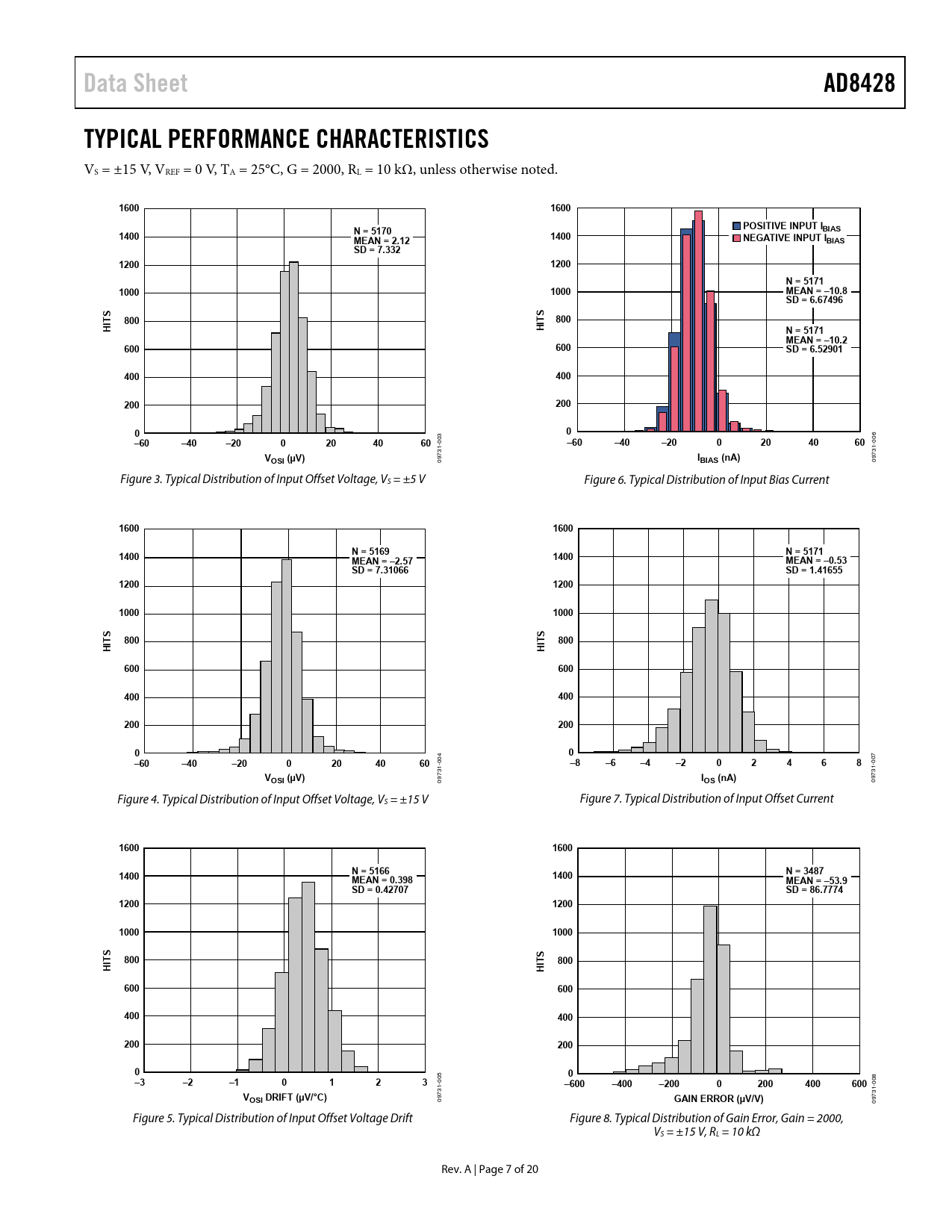

Data Sheet AD8428 TYPICAL PERFORMANCE CHARACTERISTICS
VS = ±15 V, VREF = 0 V, TA = 25°C, G = 2000, RL = 10 kΩ, unless otherwise noted.
1600 1600 POSITIVE INPUT IBIAS 1400 N = 5170 MEAN = 2.12 1400 NEGATIVE INPUT IBIAS SD = 7.332 1200 1200 N = 5171 1000 1000 MEAN = –10.8 SD = 6.67496 S S T 800 T 800 HI HI N = 5171 MEAN = –10.2 600 600 SD = 6.52901 400 400 200 200 0 0

097 Figure 3. Typical Distribution of Input Offset Voltage, VS = ±5 V Figure 6. Typical Distribution of Input Bias Current

09 Figure 4. Typical Distribution of Input Offset Voltage, VS = ±15 V Figure 7. Typical Distribution of Input Offset Current
1600 1600 N = 5166 1400 N = 3487 MEAN = 0.398 1400 MEAN = –53.9 SD = 0.42707 SD = 86.7774 1200 1200 1000 1000 S T S 800 T 800 HI HI 600 600 400 400 200 200 0 0 –3 –2 –1 0 1 2 3

097 Figure 5. Typical Distribution of Input Offset Voltage Drift Figure 8. Typical Distribution of Gain Error, Gain = 2000, VS = ±15 V, RL = 10 kΩ Rev. A | Page 7 of 20 Document Outline FEATURES APPLICATIONS FUNCTIONAL BLOCK DIAGRAM GENERAL DESCRIPTION TABLE OF CONTENTS REVISION HISTORY SPECIFICATIONS ABSOLUTE MAXIMUM RATINGS THERMAL RESISTANCE ESD CAUTION PIN CONFIGURATION AND FUNCTION DESCRIPTIONS TYPICAL PERFORMANCE CHARACTERISTICS THEORY OF OPERATION ARCHITECTURE FILTER TERMINALS REFERENCE TERMINAL INPUT VOLTAGE RANGE LAYOUT Common-Mode Rejection Ratio over Frequency Power Supplies and Grounding Reference Pin INPUT BIAS CURRENT RETURN PATH INPUT PROTECTION IMAX Input Voltages Beyond the Rails Large Differential Input Voltage at High Gain RADIO FREQUENCY INTERFERENCE (RFI) CALCULATING THE NOISE OF THE INPUT STAGE Source Resistance Noise Voltage Noise of the Instrumentation Amplifier Current Noise of the Instrumentation Amplifier Total Noise Density Calculation APPLICATIONS INFORMATION EFFECT OF PASSIVE NETWORK ACROSS THE FILTER TERMINALS CIRCUITS USING THE FILTER TERMINALS Setting the Amplifier to Different Gains Low-Pass Filter Notch Filter Extracting the Common-Mode Voltage of the Input OUTLINE DIMENSIONS ORDERING GUIDE
