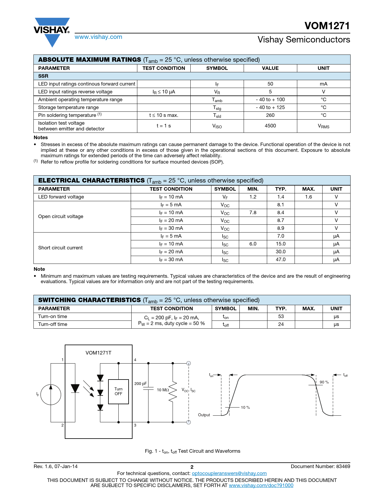

ABSOLUTE MAXIMUM RATINGS
(Tamb = 25 °C, unless otherwise specified)
PARAMETER TEST CONDITION SYMBOL VALUE UNIT SSR
LED input ratings continous forward current IF 50 mA LED input ratings reverse voltage IR ≤ 10 μA VR 5 V Ambient operating temperature range Tamb - 40 to + 100 °C Storage temperature range Tstg - 40 to + 125 °C Pin soldering temperature (1) t ≤ 10 s max. Tsld 260 °C Isolation test voltage t = 1 s V between emitter and detector ISO 4500 VRMS
Notes
• Stresses in excess of the absolute maximum ratings can cause permanent damage to the device. Functional operation of the device is not implied at these or any other conditions in excess of those given in the operational sections of this document. Exposure to absolute maximum ratings for extended periods of the time can adversely affect reliability. (1) Refer to reflow profile for soldering conditions for surface mounted devices (SOP).
ELECTRICAL CHARACTERISTICS
PARAMETER TEST CONDITION SYMBOL MIN. TYP. MAX. UNIT
LED forward voltage IF = 10 mA VF 1.2 1.4 1.6 V IF = 5 mA VOC 8.1 V IF = 10 mA VOC 7.8 8.4 V Open circuit voltage IF = 20 mA VOC 8.7 V IF = 30 mA VOC 8.9 V IF = 5 mA ISC 7.0 μA IF = 10 mA ISC 6.0 15.0 μA Short circuit current IF = 20 mA ISC 30.0 μA IF = 30 mA ISC 47.0 μA
Note
• Minimum and maximum values are testing requirements. Typical values are characteristics of the device and are the result of engineering evaluations. Typical values are for information only and are not part of the testing requirements.
SWITCHING CHARACTERISTICS
Turn-on time C t L = 200 pF, IF = 20 mA, on 53 μs P Turn-off time W = 2 ms, duty cycle = 50 % toff 24 μs VOM1271T 1 4 t t on off 200 pF 90 % Turn 10 MΩ V , I OC SC I OFF F 10 % Output 2 3 Fig. 1 - ton, toff Test Circuit and Waveforms Rev. 1.6, 07-Jan-14
