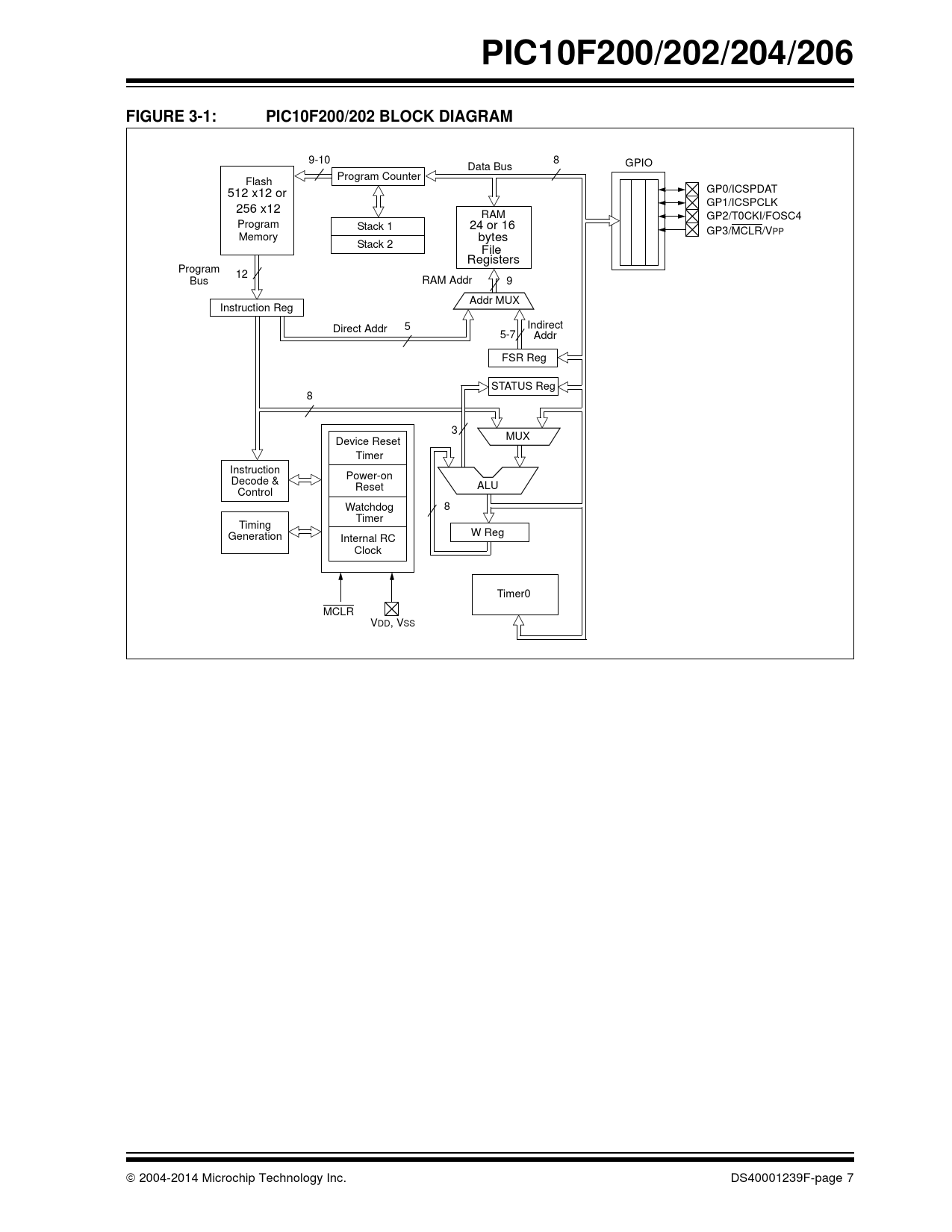

PIC10F200/202/204/206. FIGURE 3-1: PIC10F200/202 BLOCK DIAGRAM. 9-10 512 x12 or. 256 x12 24 or 16. bytes. File. Registers Stack 1
PIC10F200/202/204/206 FIGURE 3-1: PIC10F200/202 BLOCK DIAGRAM 9-10 512 x12 or 256 x12 24 or 16 bytes File Registers Stack 1
9-10 512 x12 or
256 x12 24 or 16
bytes
File
Registers Stack 1
Stack 2 12 RAM Addr GPIO
GP0/ICSPDAT
GP1/ICSPCLK
GP2/T0CKI/FOSC4
GP3/MCLR/VPP RAM Program
Memory
Program
Bus 8 Data Bus Program Counter Flash 9 Addr MUX Instruction Reg
Direct Addr 5 5-7 Indirect
Addr FSR Reg
STATUS Reg
8
3 MUX Device Reset
Timer
Instruction
Decode &
Control
Timing
Generation Power-on
Reset
Watchdog
Timer
Internal RC
Clock ALU
8
W Reg Timer0
MCLR
