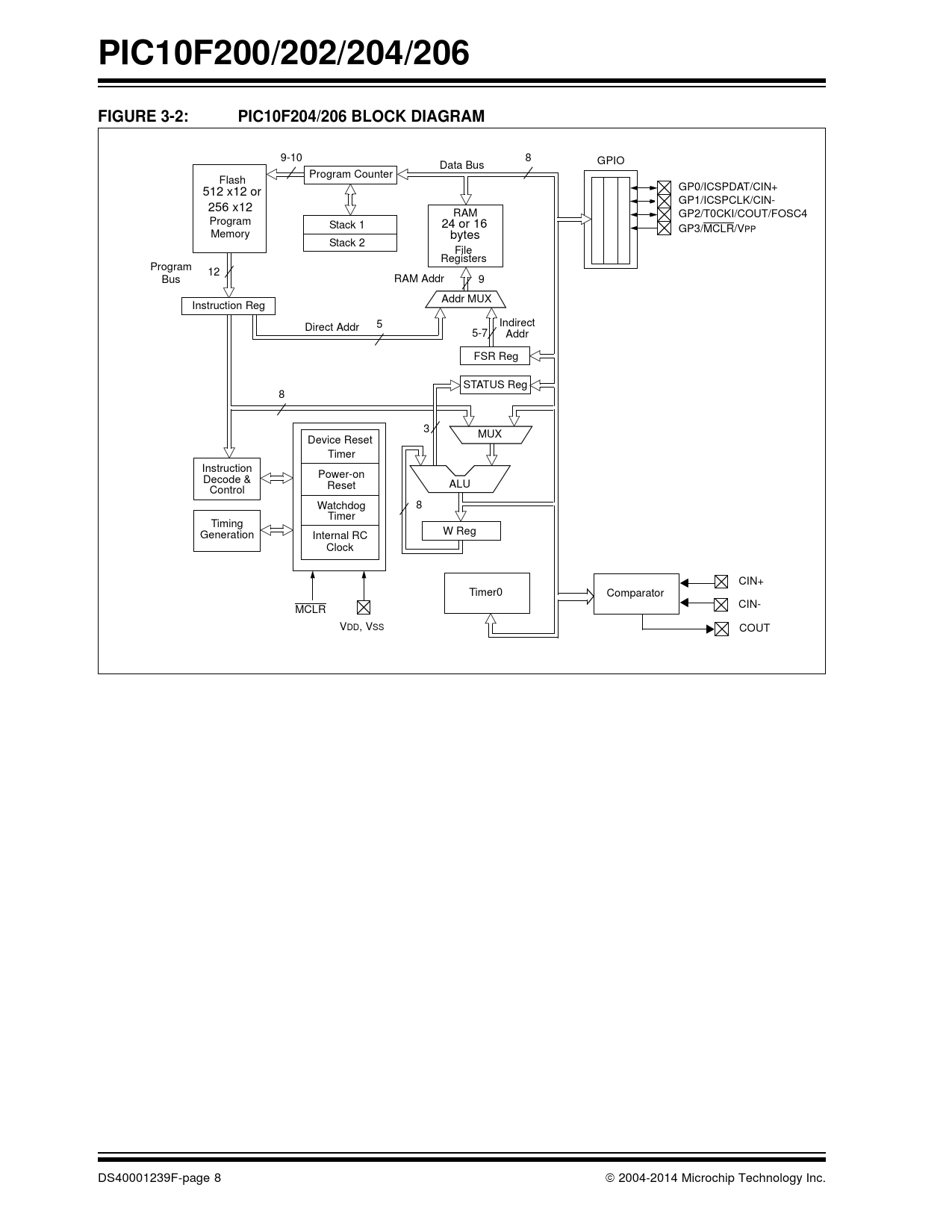

Pages / Page88 / 8 — PIC10F200/202/204/206. FIGURE 3-2: PIC10F204/206 BLOCK DIAGRAM. 9-10 512 …
PIC10F200/202/204/206. FIGURE 3-2: PIC10F204/206 BLOCK DIAGRAM. 9-10 512 x12 or. 256 x12 GPIO. GP0/ICSPDAT/CIN+
PIC10F200/202/204/206 FIGURE 3-2: PIC10F204/206 BLOCK DIAGRAM 9-10 512 x12 or 256 x12 GPIO GP0/ICSPDAT/CIN+
9-10 512 x12 or
256 x12 GPIO
GP0/ICSPDAT/CIN+
GP1/ICSPCLK/CINGP2/T0CKI/COUT/FOSC4
GP3/MCLR/VPP RAM Program
Memory
Program
Bus 8 Data Bus Program Counter Flash 24 or 16
bytes Stack 1
Stack 2 File
Registers 12 RAM Addr 9 Addr MUX Instruction Reg
Direct Addr 5 5-7 Indirect
Addr FSR Reg
STATUS Reg
8
3 MUX Device Reset
Timer
Instruction
Decode &
Control
Timing
Generation Power-on
Reset
Watchdog
Timer
Internal RC
Clock ALU
8
W Reg CIN+
Timer0 CIN-MCLR
VDD, VSS DS40001239F-page 8 Comparator
