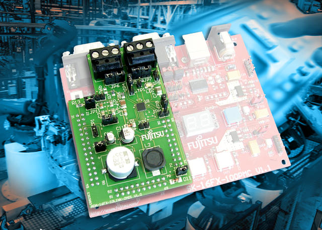

Fujitsu Semiconductor Europe has launched an IO-Link starter kit, which is designed to provide developers of automation solutions with a quick and easy introduction to all aspects of IO-Link as well as support IO-Link communication in both master and slave mode. The board was developed in collaboration with Technology Management Group (TMG) and Zentrum Mikroelektronik Dresden AG (ZMDI).

The starter kit from Fujitsu comprises a microcontroller-based board, the IO-Link adapter board and an evaluation version of the IO-Link protocol stack developed by TMG.
Microcontroller baseboard
The SK-16FX-EUROSCOPE microcontroller baseboard is based on Fujitsu’s scalable 16-bit microcontroller platform 16FX and is used for evaluating the microcontroller properties. In addition to the MB96F348H-MCU, the board features a UART, USB and high-speed CAN interface, pin contact strips that make all the pins on the microcontroller easily accessible, segment displays and buttons. The complete development environment with the compiler, linker, flash programmer, GUI and the Euroscope Lite on-chip debugger are also included in the scope of delivery.

The ADA-16FX-IOLINK-ZDMI adapter board is a cost-effective solution providing an IO-Link interface for the microcontroller baseboard. The core of the adapter board is the ZIOL2401 IO-Link high-voltage transceiver developed by ZMDI, which is the only IO-Link IC on the market today that supports not only IO-Link master ports and IO-Link device ports but also standard I/O applications. This is possible thanks to the ZIOL2401 chip, which features an innovative two-channel IO-Link driver and a DC/DC converter for up to 15V. The IO-Link drivers can be fully programmed – including the slew rate – and feature comprehensive diagnostic functions as well as a temperature sensor. The board is also equipped with a 24V converter and jumpers for a wide range of configuration settings.
