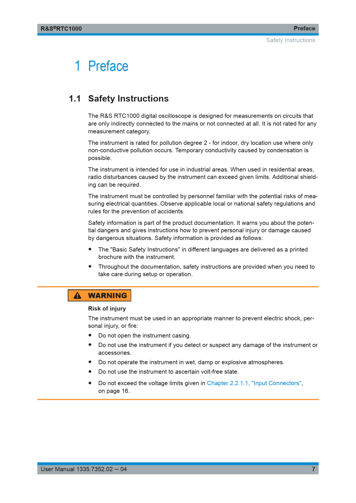

R&S
RTC1000 Preface
Safety Instructions 1 Preface
1.1 Safety Instructions
The R&S RTC1000 digital oscilloscope is designed for measurements on circuits that are only indirectly connected to the mains or not connected at all. It is not rated for any measurement category. The instrument is rated for pollution degree 2 - for indoor, dry location use where only non-conductive pollution occurs. Temporary conductivity caused by condensation is possible. The instrument is intended for use in industrial areas. When used in residential areas, radio disturbances caused by the instrument can exceed given limits. Additional shield- ing can be required. The instrument must be controlled by personnel familiar with the potential risks of mea- suring electrical quantities. Observe applicable local or national safety regulations and rules for the prevention of accidents. Safety information is part of the product documentation. It warns you about the poten- tial dangers and gives instructions how to prevent personal injury or damage caused by dangerous situations. Safety information is provided as follows: ● The "Basic Safety Instructions" in different languages are delivered as a printed brochure with the instrument. ● Throughout the documentation, safety instructions are provided when you need to take care during setup or operation.
Risk of injury
The instrument must be used in an appropriate manner to prevent electric shock, per- sonal injury, or fire: ● Do not open the instrument casing. ● Do not use the instrument if you detect or suspect any damage of the instrument or accessories. ● Do not operate the instrument in wet, damp or explosive atmospheres. ● Do not use the instrument to ascertain volt-free state. ● Do not exceed the voltage limits given in Chapter 2.2.1.1, "Input Connectors", on page 16. User Manual 1335.7352.02 ─ 04
7
