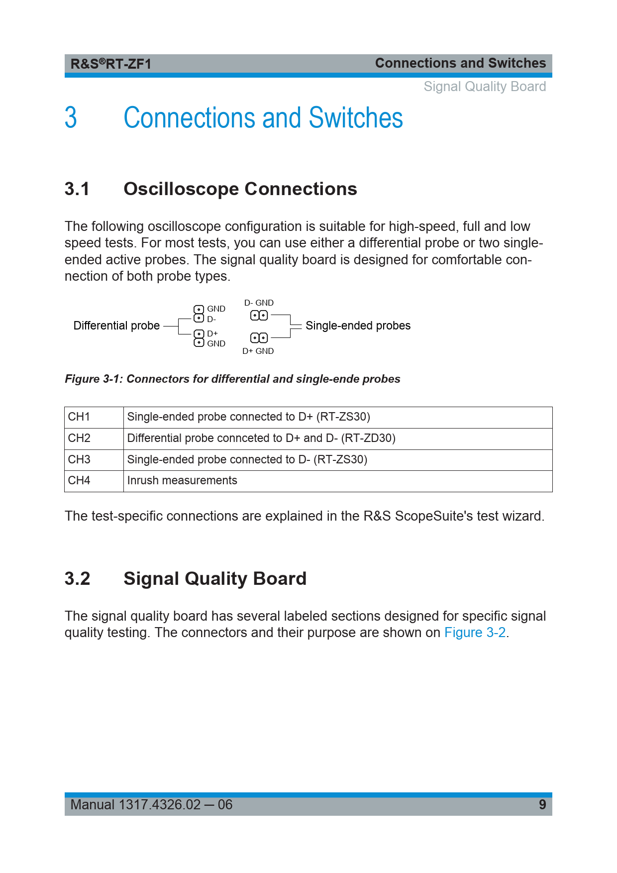

3.1 Oscilloscope Connections
The following oscilloscope configuration is suitable for high-speed, full and low speed tests. For most tests, you can use either a differential probe or two single- ended active probes. The signal quality board is designed for comfortable con- nection of both probe types. D- GND GND D- Differential probe Single-ended probes D+ GND D+ GND
Figure 3-1: Connectors for differential and single-ende probes
CH1 Single-ended probe connected to D+ (RT-ZS30) CH2 Differential probe connceted to D+ and D- (RT-ZD30) CH3 Single-ended probe connected to D- (RT-ZS30) CH4 Inrush measurements The test-specific connections are explained in the R&S ScopeSuite's test wizard.
