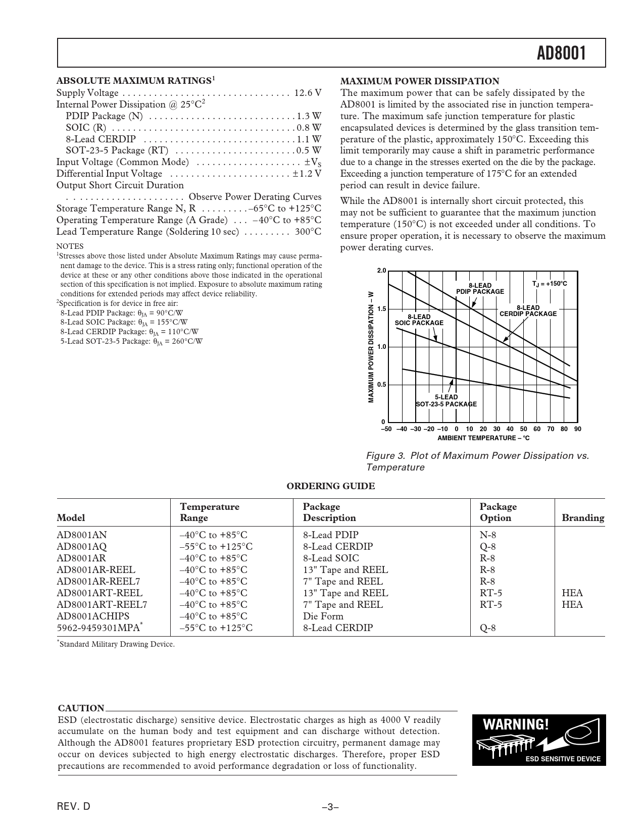

AD8001. ABSOLUTE MAXIMUM RATINGS1. MAXIMUM POWER DISSIPATION. 2.0. 8-LEAD. TJ = +150. PDIP PACKAGE. 1.5. CERDIP PACKAGE. SOIC PACKAGE. 1.0
AD8001 ABSOLUTE MAXIMUM RATINGS1 MAXIMUM POWER DISSIPATION 2.0 8-LEAD TJ = +150 PDIP PACKAGE 1.5 CERDIP PACKAGE SOIC PACKAGE 1.0
AD8001
Supply Voltage . 12.6 V The maximum power that can be safely dissipated by the Internal Power Dissipation @ 25°C2 AD8001 is limited by the associated rise in junction tempera- PDIP Package (N) . 1.3 W ture. The maximum safe junction temperature for plastic SOIC (R) . 0.8 W encapsulated devices is determined by the glass transition tem- 8-Lead CERDIP . 1.1 W perature of the plastic, approximately 150°C. Exceeding this SOT-23-5 Package (RT) . 0.5 W limit temporarily may cause a shift in parametric performance Input Voltage (Common Mode) . ± VS due to a change in the stresses exerted on the die by the package. Differential Input Voltage . ± 1.2 V Exceeding a junction temperature of 175°C for an extended Output Short Circuit Duration period can result in device failure. Observe Power Derating Curves While the AD8001 is internally short circuit protected, this Storage Temperature Range N, R . –65°C to +125°C may not be sufficient to guarantee that the maximum junction Operating Temperature Range (A Grade) . – 40°C to +85°C temperature (150°C) is not exceeded under all conditions. To Lead Temperature Range (Soldering 10 sec) . 300°C ensure proper operation, it is necessary to observe the maximum NOTES power derating curves. 1Stresses above those listed under Absolute Maximum Ratings may cause perma- nent damage to the device. This is a stress rating only; functional operation of the
2.0
device at these or any other conditions above those indicated in the operational section of this specification is not implied. Exposure to absolute maximum rating
8-LEAD TJ = +150 C
conditions for extended periods may affect device reliability.
PDIP PACKAGE
2Specification is for device in free air:
1.5 8-LEAD
8-Lead PDIP Package: θJA = 90°C/W
8-LEAD CERDIP PACKAGE
8-Lead SOIC Package: θJA = 155°C/W
SOIC PACKAGE
8-Lead CERDIP Package: θJA = 110°C/W 5-Lead SOT-23-5 Package: θJA = 260°C/W
1.0 0.5 5-LEAD MAXIMUM POWER DISSIPATION – W SOT-23-5 PACKAGE 0 –50 –40 –30 –20 –10 0 10 20 30 40 50 60 70 80 90 AMBIENT TEMPERATURE – C
Figure 3. Plot of Maximum Power Dissipation vs. Temperature
