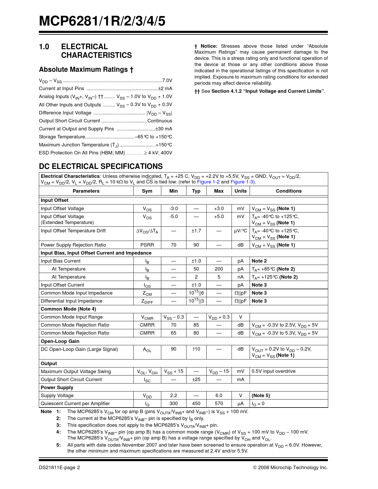

MCP6281/1R/2/3/4/5. 1.0. ELECTRICAL. † Notice:. CHARACTERISTICS. Absolute Maximum Ratings †
MCP6281/1R/2/3/4/5 1.0 ELECTRICAL † Notice: CHARACTERISTICS Absolute Maximum Ratings †
link to page 12 link to page 4 link to page 4 link to page 2 link to page 2 link to page 2 link to page 2 link to page 2 link to page 2 link to page 2 link to page 2 link to page 2 link to page 2 link to page 2 link to page 2 link to page 2
Stresses above those listed under “Absolute Maximum Ratings” may cause permanent damage to the
CHARACTERISTICS
device. This is a stress rating only and functional operation of the device at those or any other conditions above those
indicated in the operational listings of this specification is not implied. Exposure to maximum rating conditions for extended VDD – VSS ..7.0V periods may affect device reliability. Current at Input Pins ..±2 mA
See
Section 4.1.2 “Input Voltage and Current Limits”
. Analog Inputs (VIN+, VIN–) †† .. VSS – 1.0V to VDD + 1.0V All Other Inputs and Outputs ... VSS – 0.3V to VDD + 0.3V Difference Input Voltage .. |VDD – VSS| Output Short Circuit Current ...Continuous Current at Output and Supply Pins ..±30 mA Storage Temperature.. –65°C to +150°C Maximum Junction Temperature (TJ) ..+150°C ESD Protection On All Pins (HBM; MM) .. ≥ 4 kV; 400V
DC ELECTRICAL SPECIFICATIONS Electrical Characteristics
: Unless otherwise indicated, T ≈ A = +25 C, VDD = +2.2V to +5.5V, VSS = GND, VOUT VDD/2, VCM = VDD/2, VL = VDD/2, RL = 10 kΩ to VL and CS is tied low. (refer to Figure 1-2 and Figure 1-3).
Parameters Sym Min Typ Max Units Conditions Input Offset
Input Offset Voltage VOS -3.0 — +3.0 mV VCM = VSS
(Note 1)
Input Offset Voltage VOS -5.0 — +5.0 mV TA= -40°C to +125°C, (Extended Temperature) VCM = VSS
(Note 1 )
Input Offset Temperature Drift ΔVOS/ΔTA — ±1.7 — µV/°C TA= -40°C to +125°C, VCM = VSS
(Note 1)
Power Supply Rejection Ratio PSRR 70 90 — dB VCM = VSS
(Note 1) Input Bias, Input Offset Current and Impedance
Input Bias Current IB — ±1.0 — pA
Note 2
At Temperature IB — 50 200 pA TA= +85°C
(Note 2)
At Temperature IB — 2 5 nA TA= +125°C
(Note 2 )
Input Offset Current IOS — ±1.0 — pA
Note 3
Common Mode Input Impedance ZCM — 1013||6 — Ω||pF
Note 3
Differential Input Impedance ZDIFF — 1013||3 — Ω||pF
Note 3 Common Mode (Note 4)
Common Mode Input Range V − CMR VSS 0.3 — VDD + 0.3 V Common Mode Rejection Ratio CMRR 70 85 — dB VCM = -0.3V to 2.5V, VDD = 5V Common Mode Rejection Ratio CMRR 65 80 — dB VCM = -0.3V to 5.3V, VDD = 5V
Open-Loop Gain
DC Open-Loop Gain (Large Signal) AOL 90 110 — dB VOUT = 0.2V to VDD – 0.2V, VCM = VSS
(Note 1 ) Output
Maximum Output Voltage Swing VOL, VOH VSS + 15 — VDD – 15 mV 0.5V input overdrive Output Short Circuit Current ISC — ±25 — mA
Power Supply
Supply Voltage VDD 2.2 — 6.0 V
(Note 5 )
Quiescent Current per Amplifier IQ 300 450 570 µA IO = 0
Note 1:
The MCP6285’s VCM for op amp B (pins VOUTA/VINB+ and VINB–) is VSS + 100 mV.
2:
The current at the MCP6285’s VINB– pin is specified by IB only.
3:
This specification does not apply to the MCP6285’s VOUTA/VINB+ pin.
4:
The MCP6285’s VINB– pin (op amp B) has a common mode range (VCMR) of VSS + 100 mV to VDD – 100 mV. The MCP6285’s VOUTA/VINB+ pin (op amp B) has a voltage range specified by VOH and VOL.
5:
All parts with date codes November 2007 and later have been screened to ensure operation at VDD = 6.0V. However, the other minimum and maximum specifications are measured at 2.4V and/or 5.5V. DS21811E-page 2 © 2008 Microchip Technology Inc. Document Outline 1.0 Electrical Characteristics FIGURE 1-1: Timing Diagram for the Chip Select (CS) pin on the MCP6283 and MCP6285. 1.1 Test Circuits FIGURE 1-2: AC and DC Test Circuit for Most Non-Inverting Gain Conditions. FIGURE 1-3: AC and DC Test Circuit for Most Inverting Gain Conditions. 2.0 Typical Performance Curves FIGURE 2-1: Input Offset Voltage. FIGURE 2-2: Input Bias Current at TA = +85 ˚C. FIGURE 2-3: Input Offset Voltage vs. Common Mode Input Voltage at VDD = 2.2V. FIGURE 2-4: Input Offset Voltage Drift. FIGURE 2-5: Input Bias Current at TA = +125 ˚C. FIGURE 2-6: Input Offset Voltage vs. Common Mode Input Voltage at VDD = 5.5V. FIGURE 2-7: Input Offset Voltage vs. Output Voltage. FIGURE 2-8: CMRR, PSRR vs. Frequency. FIGURE 2-9: Input Bias, Offset Currents vs. Common Mode Input Voltage at TA = +85˚C. FIGURE 2-10: Input Bias, Input Offset Currents vs. Ambient Temperature. FIGURE 2-11: CMRR, PSRR vs. Ambient Temperature. FIGURE 2-12: Input Bias, Offset Currents vs. Common Mode Input Voltage at TA = +125˚C. FIGURE 2-13: Quiescent Current vs. Power Supply Voltage. FIGURE 2-14: Open-Loop Gain, Phase vs. Frequency. FIGURE 2-15: Maximum Output Voltage Swing vs. Frequency. FIGURE 2-16: Output Voltage Headroom vs. Output Current Magnitude. FIGURE 2-17: Gain Bandwidth Product, Phase Margin vs. Ambient Temperature. FIGURE 2-18: Slew Rate vs. Ambient Temperature. FIGURE 2-19: Input Noise Voltage Density vs. Frequency. FIGURE 2-20: Output Short Circuit Current vs. Power Supply Voltage. FIGURE 2-21: Quiescent Current vs. Chip Select (CS) Voltage at VDD = 2.2V (MCP6283 and MCP6285 only). FIGURE 2-22: Input Noise Voltage Density vs. Common Mode Input Voltage at 1 kHz. FIGURE 2-23: Channel-to-Channel Separation vs. Frequency (MCP6282 and MCP6284 only). FIGURE 2-24: Quiescent Current vs. Chip Select (CS) Voltage at VDD = 5.5V (MCP6283 and MCP6285 only). FIGURE 2-25: Large-Signal, Non-inverting Pulse Response. FIGURE 2-26: Small-Signal, Non-inverting Pulse Response. FIGURE 2-27: Chip Select (CS) to Amplifier Output Response Time at VDD = 2.2V (MCP6283 and MCP6285 only). FIGURE 2-28: Large-Signal, Inverting Pulse Response. FIGURE 2-29: Small-Signal, Inverting Pulse Response. FIGURE 2-30: Chip Select (CS) to Amplifier Output Response Time at VDD = 5.5V (MCP6283 and MCP6285 only). FIGURE 2-31: Measured Input Current vs. Input Voltage (below VSS). FIGURE 2-32: The MCP6281/1R/2/3/4/5 Show No Phase Reversal. 3.0 Pin Descriptions TABLE 3-1: Pin Function Table for Single Op Amps TABLE 3-2: Pin Function Table for Dual and Quad Op Amps 3.1 Analog Outputs 3.2 Analog Inputs 3.3 MCP6285’s VOUTA/VINB+ Pin 3.4 Chip Select Digital Input (CS) 3.5 Power Supply Pins 4.0 Application infoRmation 4.1 Rail-to-Rail Inputs FIGURE 4-1: Simplified Analog Input ESD Structures. FIGURE 4-2: Protecting the Analog Inputs. 4.2 Rail-to-Rail Output 4.3 Capacitive Loads FIGURE 4-3: Output Resistor, RISO stabilizes large capacitive loads. FIGURE 4-4: Recommended RISO Values for Capacitive Loads. 4.4 MCP628X Chip Select (CS) 4.5 Cascaded Dual Op Amps (MCP6285) FIGURE 4-5: Cascaded Gain Amplifier. 4.6 Supply Bypass 4.7 Unused Op Amps FIGURE 4-6: Unused Op Amps. 4.8 PCB Surface Leakage FIGURE 4-7: Example Guard Ring Layout for Inverting Gain. 4.9 Application Circuits FIGURE 4-8: Sallen-Key High-Pass Filter. FIGURE 4-9: Miller Integrator. FIGURE 4-10: Isolating the Load with a Buffer. FIGURE 4-11: Cascaded Gain Circuit Configuration. FIGURE 4-12: Difference Amplifier Circuit. FIGURE 4-13: Buffered Non-inverting Integrator with Chip Select. FIGURE 4-14: Integrator Circuit with Active Compensation. FIGURE 4-15: Second-Order Multiple Feedback Low-Pass Filter with an Extra Pole-Zero Pair. FIGURE 4-16: Second-Order Sallen-Key Low-Pass Filter with an Extra Pole-Zero Pair and Chip Select. FIGURE 4-17: Capacitorless Second-Order Low-Pass Filter with Chip Select. 5.0 Design AIDS 5.1 SPICE Macro Model 5.2 FilterLab® Software 5.3 Mindi™ Circuit Designer & Simulator 5.4 MAPS (Microchip Advanced Part Selector) 5.5 Analog Demonstration and Evaluation Boards 5.6 Application Notes 6.0 Packaging Information 6.1 Package Marking Information
