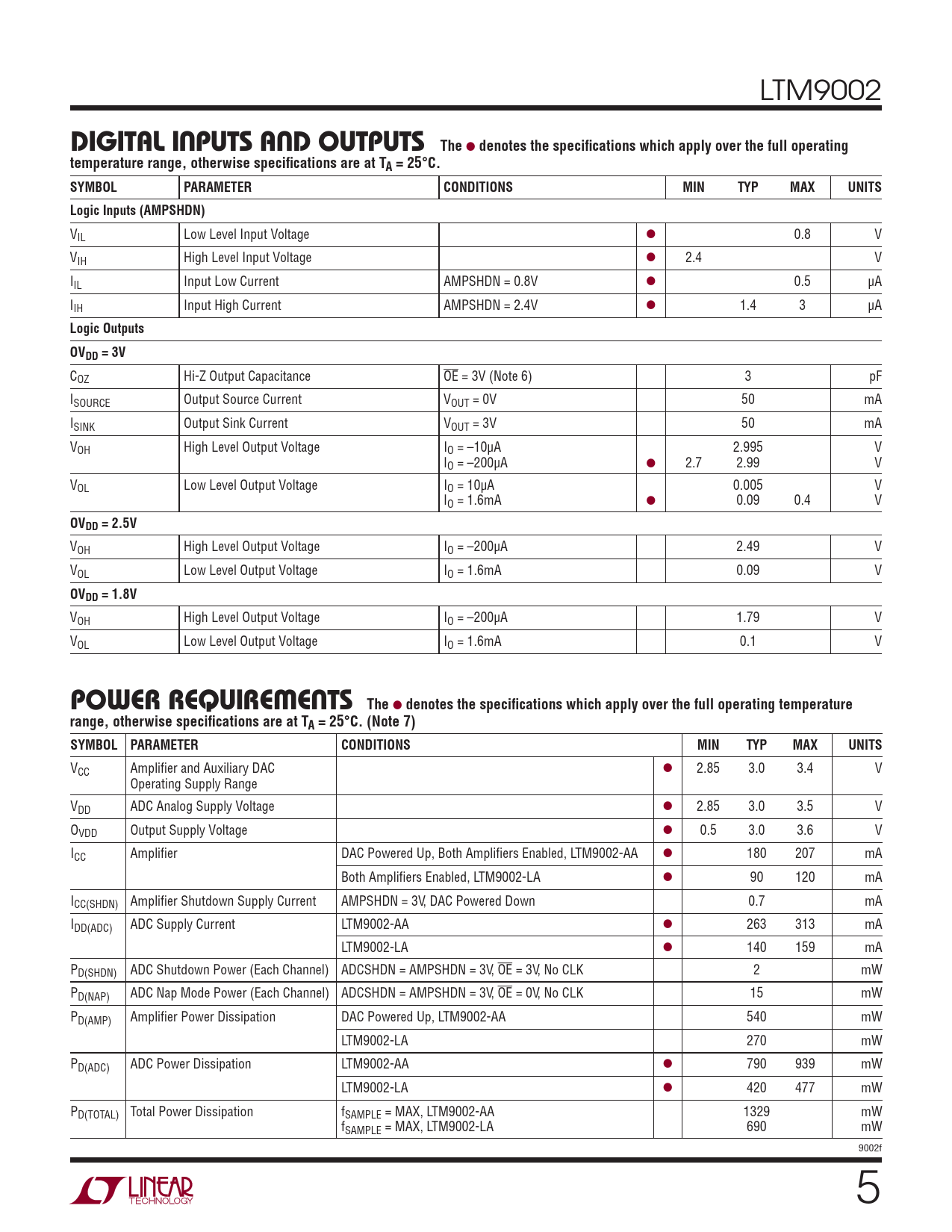

DIGITAL INPUTS AND OUTPUTS. The. denotes the specifi cations which apply over the full operating
DIGITAL INPUTS AND OUTPUTS The denotes the specifi cations which apply over the full operating
LTM9002
l
denotes the specifi cations which apply over the full operating temperature range, otherwise specifi cations are at TA = 25°C. SYMBOL PARAMETER CONDITIONS MIN TYP MAX UNITS Logic Inputs (AMPSHDN)
VIL Low Level Input Voltage l 0.8 V VIH High Level Input Voltage l 2.4 V IIL Input Low Current AMPSHDN = 0.8V l 0.5 μA IIH Input High Current AMPSHDN = 2.4V l 1.4 3 μA
Logic Outputs OVDD = 3V
COZ Hi-Z Output Capacitance OE = 3V (Note 6) 3 pF ISOURCE Output Source Current VOUT = 0V 50 mA ISINK Output Sink Current VOUT = 3V 50 mA VOH High Level Output Voltage IO = –10μA 2.995 V IO = –200μA l 2.7 2.99 V VOL Low Level Output Voltage IO = 10μA 0.005 V IO = 1.6mA l 0.09 0.4 V
OVDD = 2.5V
VOH High Level Output Voltage IO = –200μA 2.49 V VOL Low Level Output Voltage IO = 1.6mA 0.09 V
OVDD = 1.8V
VOH High Level Output Voltage IO = –200μA 1.79 V VOL Low Level Output Voltage IO = 1.6mA 0.1 V
The POWER REQUIREMENTS
l
denotes the specifi cations which apply over the full operating temperature range, otherwise specifi cations are at TA = 25°C. (Note 7) SYMBOL PARAMETER CONDITIONS MIN TYP MAX UNITS
VCC Amplifi er and Auxiliary DAC l 2.85 3.0 3.4 V Operating Supply Range VDD ADC Analog Supply Voltage l 2.85 3.0 3.5 V OVDD Output Supply Voltage l 0.5 3.0 3.6 V ICC Amplifi er DAC Powered Up, Both Amplifi ers Enabled, LTM9002-AA l 180 207 mA Both Amplifi ers Enabled, LTM9002-LA l 90 120 mA ICC(SHDN) Amplifi er Shutdown Supply Current AMPSHDN = 3V, DAC Powered Down 0.7 mA IDD(ADC) ADC Supply Current LTM9002-AA l 263 313 mA LTM9002-LA l 140 159 mA PD(SHDN) ADC Shutdown Power (Each Channel) ADCSHDN = AMPSHDN = 3V, OE = 3V, No CLK 2 mW PD(NAP) ADC Nap Mode Power (Each Channel) ADCSHDN = AMPSHDN = 3V, OE = 0V, No CLK 15 mW PD(AMP) Amplifi er Power Dissipation DAC Powered Up, LTM9002-AA 540 mW LTM9002-LA 270 mW PD(ADC) ADC Power Dissipation LTM9002-AA l 790 939 mW LTM9002-LA l 420 477 mW PD(TOTAL) Total Power Dissipation fSAMPLE = MAX, LTM9002-AA 1329 mW fSAMPLE = MAX, LTM9002-LA 690 mW 9002f 5
