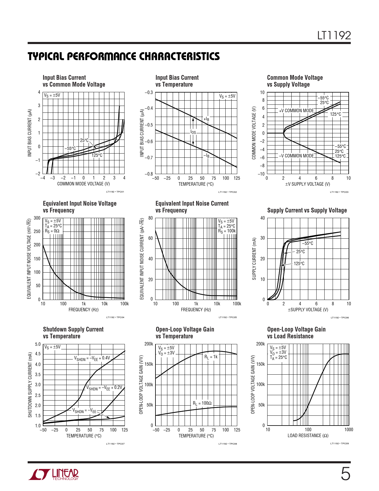

TYPICAL PERFOR A CE CHARACTERISTICS. Input Bias Current. Common Mode Voltage. vs Common Mode Voltage. vs Temperature
TYPICAL PERFOR A CE CHARACTERISTICS Input Bias Current Common Mode Voltage vs Common Mode Voltage vs Temperature
LT1192
W U TYPICAL PERFOR A CE CHARACTERISTICS Input Bias Current Input Bias Current Common Mode Voltage vs Common Mode Voltage vs Temperature vs Supply Voltage
4 –0.3 10 VS = ±5V VS = ±5V –55°C 8 25°C 3 –0.4 6 +V COMMON MODE µA) µA) 125 C ° 4 +I 2 B –0.5 2 I 1 OS 0 25°C –0.6 –2 0 –55°C –55°C –4 25°C INPUT BIAS CURRENT ( 125°C INPUT BIAS CURRENT ( –IB –V COMMON MODE –0.7 COMMON MODE VOLTAGE (V) –6 125°C –1 –8 –2 –0.8 –10 –4 –3 –2 –1 0 1 2 3 4 –50 –25 0 25 50 75 100 125 0 2 4 6 8 10 COMMON MODE VOLTAGE (V) TEMPERATURE (°C) ±V SUPPLY VOLTAGE (V) LT1192 • TPC01 LT1192 • TPC02 LT1192 • TPC03
Equivalent Input Noise Voltage Equivalent Input Noise Current vs Frequency vs Frequency Supply Current vs Supply Voltage
300 80 40 V √Hz) S = ±5V T √Hz) VS = ±5V A = 25°C TA = 25°C 250 RS = 0Ω RS = 100k 60 30 TAGE (nV/ 200 –55°C 25°C 150 40 20 125°C Y CURRENT (mA) 100 20 SUPPL 10 50 ALENT INPUT NOISE VOL ALENT INPUT NOISE CURRENT (pA/ EQUIV 0 EQUIV 0 0 10 100 1k 10k 100k 10 100 1k 10k 100k 0 2 4 6 8 10 FREQUENCY (Hz) FREQUENCY (Hz) ±SUPPLY VOLTAGE (V) LT1192 • TPC04 LT1192 • TPC05 LT1192 • TPC06
Shutdown Supply Current Open-Loop Voltage Gain Open-Loop Voltage Gain vs Temperature vs Temperature vs Load Resistance
5.0 200k 200k VS = ±5V V V S = ±5V S = ±5V 4.5 V V O = ±3V O = ±3V V RL = 1k T SHDN = –VEE + 0.4V A = 25°C 4.0 150k 150k 3.5 3.0 100k 100k VSHDN = –VEE + 0.2V 2.5 R 2.0 50k L = 100Ω 50k VSHDN = –VEE OPEN-LOOP VOLTAGE GAIN (V/V) OPEN-LOOP VOLTAGE GAIN (V/V) SHUTDOWN SUPPLY CURRENT (mA) 1.5 1.0 0 0 –50 –25 0 25 50 75 100 125 –50 –25 0 25 50 75 100 125 10 100 1000 TEMPERATURE (°C) TEMPERATURE (°C) LOAD RESISTANCE (Ω) LT1192 • TPC07 LT1192 • TPC08 LT1192 • TPC09 5
