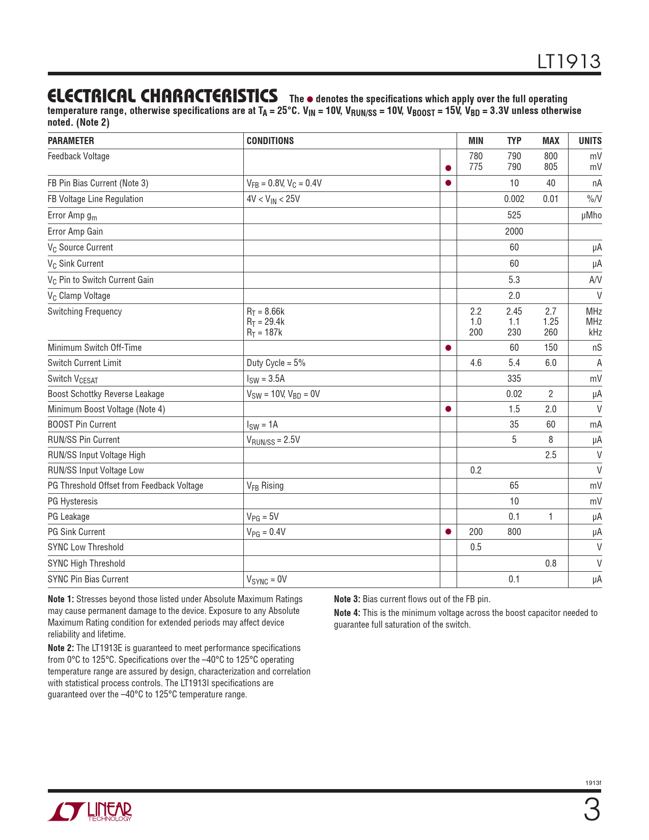

The. ELECTRICAL CHARACTERISTICS. denotes the specifi cations which apply over the full operating
The ELECTRICAL CHARACTERISTICS denotes the specifi cations which apply over the full operating
LT1913
denotes the specifi cations which apply over the full operating temperature range, otherwise specifi cations are at TA = 25°C. VIN = 10V, VRUN/SS = 10V, VBOOST = 15V, VBD = 3.3V unless otherwise noted. (Note 2) PARAMETER CONDITIONS MIN TYP MAX UNITS
Feedback Voltage 780 790 800 mV ● 775 790 805 mV FB Pin Bias Current (Note 3) VFB = 0.8V, VC = 0.4V ● 10 40 nA FB Voltage Line Regulation 4V < VIN < 25V 0.002 0.01 %/V Error Amp gm 525 μMho Error Amp Gain 2000 VC Source Current 60 μA VC Sink Current 60 μA VC Pin to Switch Current Gain 5.3 A/V VC Clamp Voltage 2.0 V Switching Frequency RT = 8.66k 2.2 2.45 2.7 MHz RT = 29.4k 1.0 1.1 1.25 MHz RT = 187k 200 230 260 kHz Minimum Switch Off-Time ● 60 150 nS Switch Current Limit Duty Cycle = 5% 4.6 5.4 6.0 A Switch VCESAT ISW = 3.5A 335 mV Boost Schottky Reverse Leakage VSW = 10V, VBD = 0V 0.02 2 μA Minimum Boost Voltage (Note 4) ● 1.5 2.0 V BOOST Pin Current ISW = 1A 35 60 mA RUN/SS Pin Current VRUN/SS = 2.5V 5 8 μA RUN/SS Input Voltage High 2.5 V RUN/SS Input Voltage Low 0.2 V PG Threshold Offset from Feedback Voltage VFB Rising 65 mV PG Hysteresis 10 mV PG Leakage VPG = 5V 0.1 1 μA PG Sink Current VPG = 0.4V ● 200 800 μA SYNC Low Threshold 0.5 V SYNC High Threshold 0.8 V SYNC Pin Bias Current VSYNC = 0V 0.1 μA
Note 1:
Note 3:
Bias current fl ows out of the FB pin. may cause permanent damage to the device. Exposure to any Absolute
Note 4:
This is the minimum voltage across the boost capacitor needed to Maximum Rating condition for extended periods may affect device guarantee full saturation of the switch. reliability and lifetime.
Note 2:
The LT1913E is guaranteed to meet performance specifi cations from 0°C to 125°C. Specifi cations over the –40°C to 125°C operating temperature range are assured by design, characterization and correlation with statistical process controls. The LT1913I specifi cations are guaranteed over the –40°C to 125°C temperature range. 1913f 3
