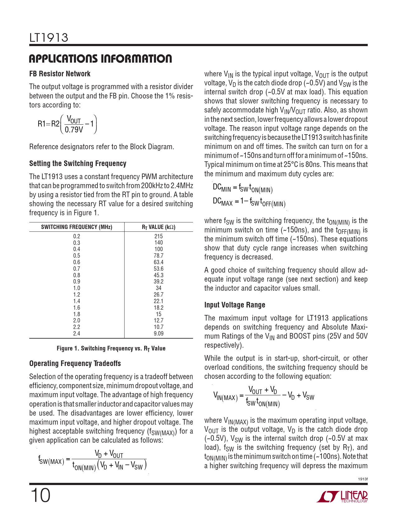

APPLICATIONS INFORMATION FB Resistor Network
where VIN is the typical input voltage, VOUT is the output voltage, V The output voltage is programmed with a resistor divider D is the catch diode drop (~0.5V) and VSW is the internal switch drop (~0.5V at max load). This equation between the output and the FB pin. Choose the 1% resis- shows that slower switching frequency is necessary to tors according to: safely accommodate high VIN/VOUT ratio. Also, as shown V in the next section, lower frequency allows a lower dropout R1= R2 OUT – 1 0.79V voltage. The reason input voltage range depends on the switching frequency is because the LT1913 switch has fi nite Reference designators refer to the Block Diagram. minimum on and off times. The switch can turn on for a minimum of ~150ns and turn off for a minimum of ~150ns.
Setting the Switching Frequency
Typical minimum on time at 25°C is 80ns. This means that The LT1913 uses a constant frequency PWM architecture the minimum and maximum duty cycles are: that can be programmed to switch from 200kHz to 2.4MHz DC t MIN = fSW ON MIN ( ) by using a resistor tied from the RT pin to ground. A table showing the necessary RT value for a desired switching DC t MAX = 1– fSW OFF MIN ( ) frequency is in Figure 1. where fSW is the switching frequency, the tON(MIN) is the
SWITCHING FREQUENCY (MHz) RT VALUE (k
Ω
minimum switch on time (~150ns), and the tOFF(MIN) is 0.2 215 the minimum switch off time (~150ns). These equations 0.3 140 0.4 100 show that duty cycle range increases when switching 0.5 78.7 frequency is decreased. 0.6 63.4 0.7 53.6 A good choice of switching frequency should allow ad- 0.8 45.3 0.9 39.2 equate input voltage range (see next section) and keep 1.0 34 the inductor and capacitor values small. 1.2 26.7 1.4 22.1 1.6 18.2
Input Voltage Range
1.8 15 2.0 12.7 The maximum input voltage for LT1913 applications 2.2 10.7 depends on switching frequency and Absolute Maxi- 2.4 9.09 mum Ratings of the VIN and BOOST pins (25V and 50V respectively).
Figure 1. Switching Frequency vs. RT Value
