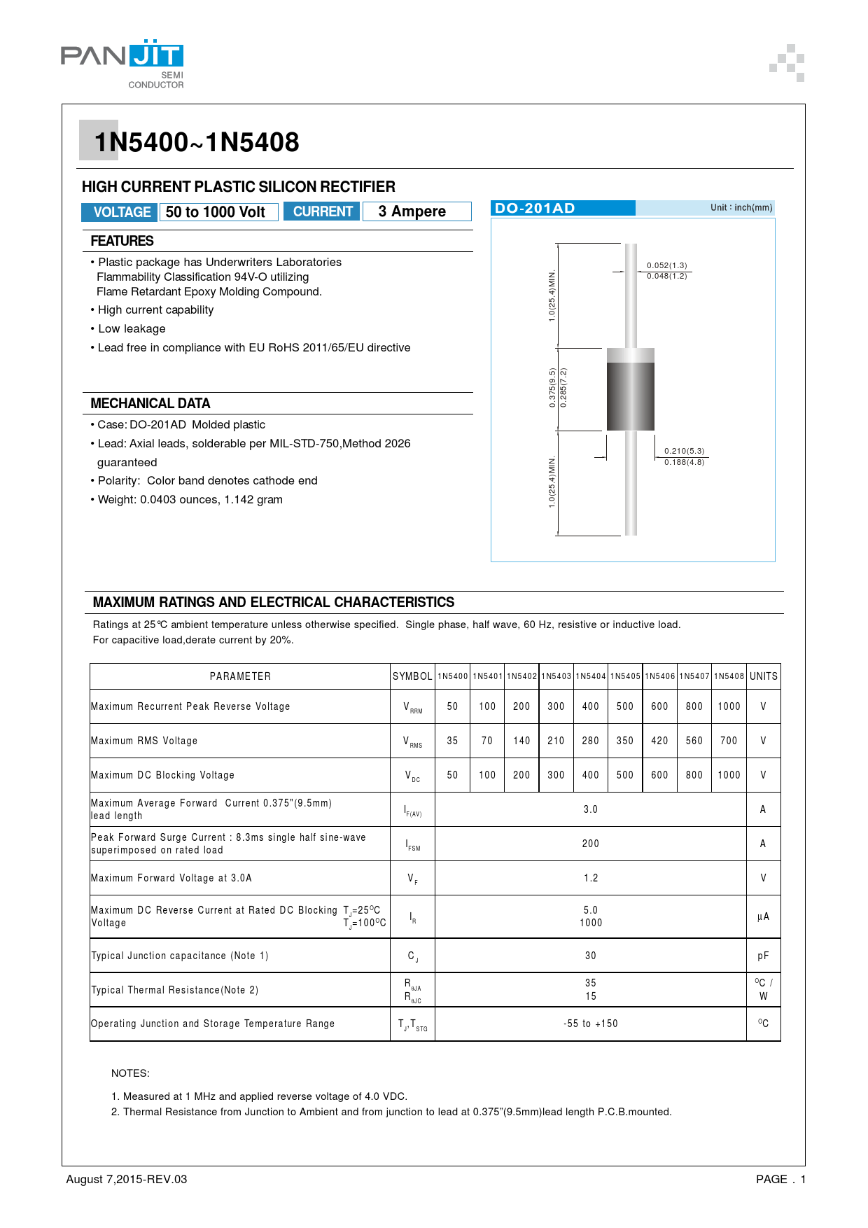

DescriptionHigh Current Plastic Silicon Rectifier. Voltage 50 to 1000 Volt Current 3 Ampere
Pages / Page4 / 1 — 1N5400~1N5408. HIGH CURRENT PLASTIC SILICON RECTIFIER. VOLTAGE 50 to 1000 …
File Format / SizePDF / 101 Kb
1N5400~1N5408. HIGH CURRENT PLASTIC SILICON RECTIFIER. VOLTAGE 50 to 1000 Volt CURRENT 3 Ampere FEATURES. 0.052(1.3)
Datasheet 1N5400-1N5408 PanJit
1N5400~1N5408
0.052(1.3)
0.048(1.2) 1.0(25.4)MIN. • Plastic package has Underwriters Laboratories
Flammability Classification 94V-O utilizing
Flame Retardant Epoxy Molding Compound.
• High current capability
• Low leakage 0.375(9.5)
0.285(7.2) • Lead free in compliance with EU RoHS 2011/65/EU directive MECHANICAL DATA
• Case: DO-201AD Molded plastic
• Lead: Axial leads, solderable per MIL-STD-750,Method 2026 0.210(5.3)
0.188(4.8) 1.0(25.4)MIN. guaranteed
• Polarity: Color band denotes cathode end
• Weight: 0.0403 ounces, 1.142 gram MAXIMUM RATINGS AND ELECTRICAL CHARACTERISTICS
Ratings at 25°C ambient temperature unless otherwise specified. Single phase, half wave, 60 Hz, resistive or inductive load.
For capacitive load,derate current by 20%. PA RA ME TE R S YMB OL 1N5 40 0 1N5 40 1 1N5 40 2 1 N5 4 03 1N5 40 4 1 N5 4 05 1N5 40 6 1 N5 4 07 1N54 0 8 UNITS Maxi mum Rec urre nt P e ak Re verse Voltage V RRM 50 10 0 20 0 3 00 40 0 5 00 60 0 80 0 10 00 V Maxi mum RMS Volta ge V RMS 35 70 1 40 2 10 28 0 3 50 42 0 56 0 7 00 V Maxi mum D C B lo cki ng Voltage V DC 50 10 0 20 0 3 00 40 0 5 00 60 0 80 0 10 00 V Maxi mum A verag e F o rwa rd C urrent 0 .37 5" (9 .5mm)
lea d length IF ( AV ) 3.0 A P e ak F orward S urg e C urrent : 8 .3ms si ng le half si ne-wave
supe ri mpo sed o n rate d loa d IF S M 20 0 A Maxi mum F o rwa rd Voltage a t 3.0A VF 1 .2 V Maxi mum D C Re verse C urre nt at Ra ted D C B loc ki ng T J =25 O C
Vo ltag e
T J =10 0 O C IR 5.0
10 00 μA Typi ca l J unc ti on ca pa ci ta nce (Note 1) CJ 30 pF R θJ A
R θJ C 35
15 T J ,T S TG -55 to +1 50 Typi ca l The rmal Res i sta nce (No te 2)
Operati ng Juncti on a nd S tora ge Te mp era ture Range O C /
W O C NOTES:
1. Measured at 1 MHz and applied reverse voltage of 4.0 VDC.
2. Thermal Resistance from Junction to Ambient and from junction to lead at 0.375”(9.5mm)lead length P.C.B.mounted. August 7,2015-REV.03 PAGE . 1
