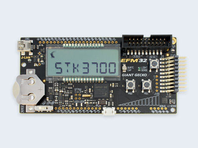

The EFM32GG-STK3700 is an excellent starting point to get familiar with the EFM32 Giant Gecko microcontrollers.
Detailed Description
The kit contains sensors and peripherals demonstrating some of the MCU's many capabilities. The kit can also serve as a starting point for application development.
Starter Kit Energy Micro EFM32GG-STK3700
Board Controller
The kit contains a board controller that is responsible for performing various board level tasks, such as handling the debugger and the Advanced Energy Monitor. An interface is provided between the EFM32 and the board controller in the form of a UART connection.
Specific library functions has been provided in the kit Board Support Package that supports various requests to be made to the board controller, such as quering AEM voltage or current. To use these functions, the Board Support Package must be installed.
Features
  • EFM32GG990F1024 MCU with 1 MB Flash and 128 KB RAM.
  • Advanced Energy Monitoring system for precise current tracking.
  • Integrated Segger J-Link USB debugger/emulator with debug out functionality.
  • 160 segment Energy Micro LCD.
  • 20 pin expansion header.
  • Breakout pads for easy access to I/O pins.
  • Power sources include USB and CR2032 battery.
  • 2 user buttons, 2 user LEDs and a touch slider.
  • Ambient Light Sensor and Inductive-capacitive metal sensor.
  • EFM32 OPAMP footprint.
  • 32 MB NAND Flash.
  • USB Micro-AB (OTG) connector.
  • 0.03F Super Capacitor for backup power domain.
  • Crystals for LFXO and HFXO: 32.768kHz and 48.000MHz.
