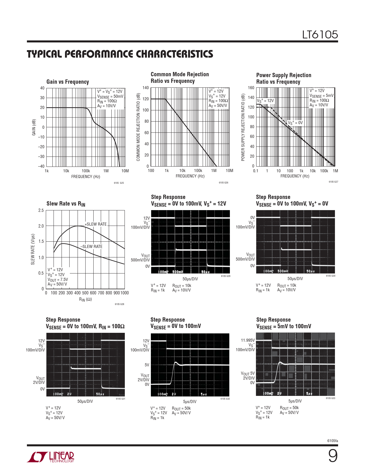

TYPICAL PERFORMANCE CHARACTERISTICS. Common Mode Rejection. Power Supply Rejection. Gain vs Frequency. Ratio vs Frequency
TYPICAL PERFORMANCE CHARACTERISTICS Common Mode Rejection Power Supply Rejection Gain vs Frequency Ratio vs Frequency
LT6105
TYPICAL PERFORMANCE CHARACTERISTICS Common Mode Rejection Power Supply Rejection Gain vs Frequency Ratio vs Frequency Ratio vs Frequency
40 140 160 V+ = V + V+ = 12V S = 12V V+ = 12V + V 30 VSENSE = 50mV V = 12V SENSE = 5mV 120 S 140 R V + = 12V R IN = 100Ω RIN = 100Ω S IN = 100Ω TIO (dB) A A 20 AV = 10V/V V = 50V/V TIO (dB) 120 V = 10V/V 100 10 100 80 V + S = 0V 0 80 GAIN (dB) 60 Y REJECTION RA –10 60 40 –20 40 –30 20 20 COMMON MODE REJECTION RA POWER SUPPL –40 0 0 1k 10k 100k 1M 10M 100 1k 10k 100k 1M 10M 0.1 1 10 100 1k 10k 100k 1M FREQUENCY (Hz) FREQUENCY (Hz) FREQUENCY (Hz) 6105 G25 6105 G26 6105 G27
Step Response Step Response Slew Rate vs RIN V + + SENSE = 0V to 100mV, VS = 12V VSENSE = 0V to 100mV, VS = 0V
2.5 12V 0V V – – +SLEW RATE S VS 2.0 100mV/DIV 100mV/DIV 1.5 TE (V/μs) –SLEW RATE V V OUT OUT 1.0 500mV/DIV 500mV/DIV SLEW RA 0V 0V V+ = 12V 0.5 V + S = 12V 6105 G29 6105 G30 V 50μs/DIV 50μs/DIV OUT = 7.5V AV = 50V/ V V+ = 12V ROUT = 10k V+ = 12V ROUT = 10k 0 RIN = 1k AV = 10V/V RIN = 1k AV = 10V/V 0 100 200 300 400 500 600 700 800 900 1000 RIN (Ω) 6105 G28
Step Response Step Response Step Response VSENSE = 0V to 100mV, RIN = 100Ω VSENSE = 0V to 100mV VSENSE = 5mV to 100mV
12V 12V 11.995V V – – – S V V S S 100mV/DIV 100mV/DIV 100mV/DIV 5V VOUT 5V V V OUT OUT 2V/DIV 2V/DIV 2V/DIV 0V 0V 0V 6105 G31 6105 G33 6105 G32 50μs/DIV 5μs/DIV 5μs/DIV V+ = 12V V+ = 12V R V+ = 12V R OUT = 50k OUT = 50k V + + + S = 12V V = 12V A V S V = 50V/ V S = 12V AV = 50V/ V AV = 50V/ V R R IN = 1k IN = 1k 6105fa 9
