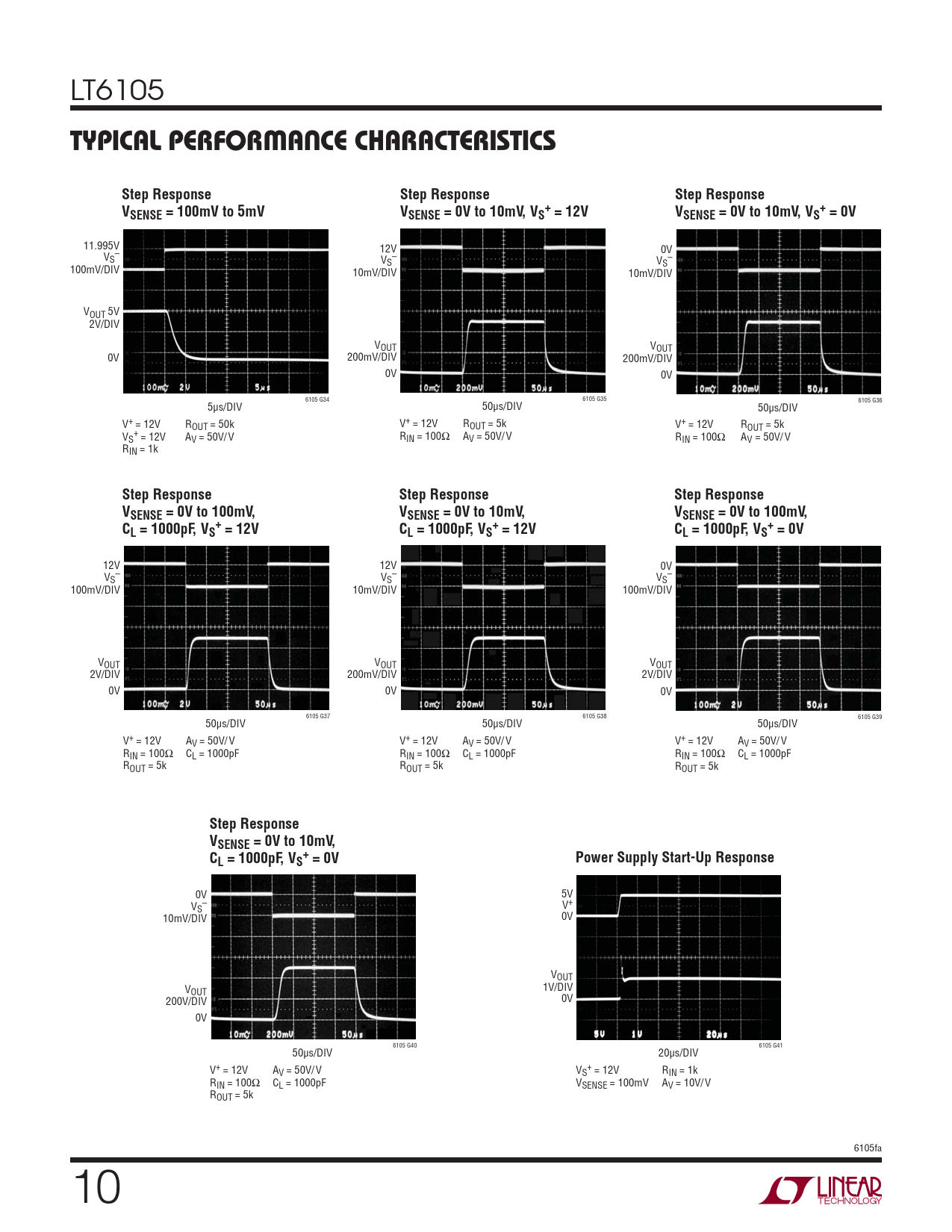

TYPICAL PERFORMANCE CHARACTERISTICS. Step Response. SENSE = 100mV to 5mV. SENSE = 0V to 10mV, VS = 12V
TYPICAL PERFORMANCE CHARACTERISTICS Step Response SENSE = 100mV to 5mV SENSE = 0V to 10mV, VS = 12V
LT6105
TYPICAL PERFORMANCE CHARACTERISTICS Step Response Step Response Step Response V V + SENSE = 100mV to 5mV SENSE = 0V to 10mV, VS = 12V V + SENSE = 0V to 10mV, VS = 0V
11.995V 12V 0V V – S V – S V – S 100mV/DIV 10mV/DIV 10mV/DIV VOUT 5V 2V/DIV VOUT VOUT 0V 200mV/DIV 200mV/DIV 0V 0V 6105 G34 6105 G35 6105 G36 5μs/DIV 50μs/DIV 50μs/DIV V+ = 12V R V+ = 12V R OUT = 50k OUT = 5k V+ = 12V ROUT = 5k V + = 12V A R S V = 50V/ V IN = 100Ω AV = 50V/ V RIN = 100Ω AV = 50V/ V RIN = 1k
Step Response Step Response Step Response VSENSE = 0V to 100mV, VSENSE = 0V to 10mV, VSENSE = 0V to 100mV, C + + + L = 1000pF, VS = 12V CL = 1000pF, VS = 12V CL = 1000pF, VS = 0V
12V 12V 0V V – V – S V – S S 100mV/DIV 10mV/DIV 100mV/DIV V V OUT V OUT OUT 2V/DIV 200mV/DIV 2V/DIV 0V 0V 0V 6105 G37 6105 G38 6105 G39 50μs/DIV 50μs/DIV 50μs/DIV V+ = 12V A V+ = 12V A V = 50V/ V V+ = 12V A V = 50V/ V V = 50V/ V R C R C IN = 100Ω L = 1000pF R IN = 100Ω L = 1000pF IN = 100Ω CL = 1000pF R R OUT = 5k R OUT = 5k OUT = 5k
Step Response V SENSE = 0V to 10mV, C + = 0V Power Supply Start-Up Response L = 1000pF, VS
0V 5V V – V+ S 0V 10mV/DIV VOUT 1V/DIV VOUT 0V 200V/DIV 0V 6105 G40 6105 G41 50μs/DIV 20μs/DIV V+ = 12V AV = 50V/ V V + S = 12V RIN = 1k RIN = 100Ω CL = 1000pF VSENSE = 100mV AV = 10V/ V ROUT = 5k 6105fa 10
