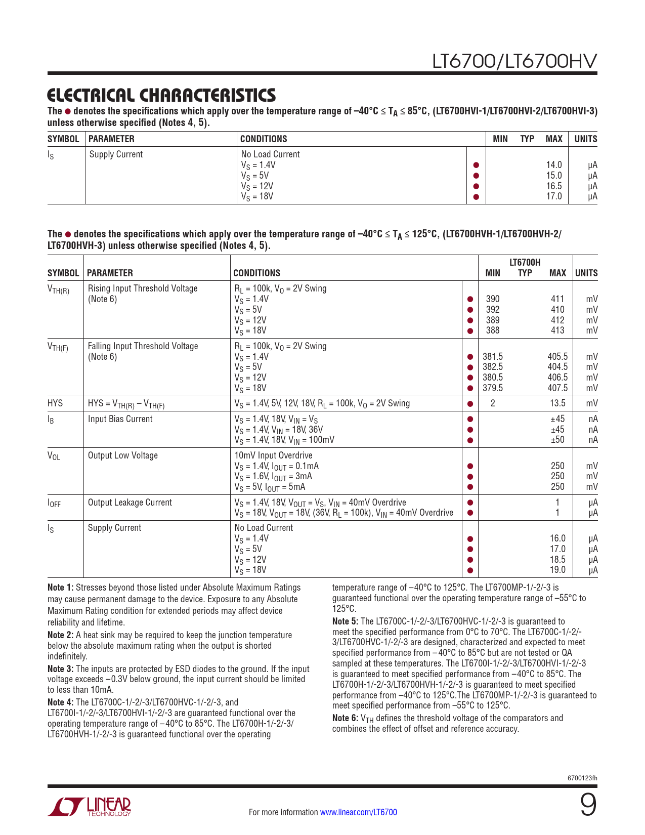

ELECTRICAL CHARACTERISTICS. The
LT6700
LT6700-1
LT6700-2
LT6700-3
LT6700HV-1
LT6700HV-2
LT6700HV-3
LT6700/LT6700HV
l
denotes the specifications which apply over the temperature range of –40°C ≤ TA ≤ 85°C, (LT6700HVI-1/LT6700HVI-2/LT6700HVI-3) unless otherwise specified (Notes 4, 5). SYMBOL PARAMETER CONDITIONS MIN TYP MAX UNITS
IS Supply Current No Load Current VS = 1.4V l 14.0 µA VS = 5V l 15.0 µA VS = 12V l 16.5 µA VS = 18V l 17.0 µA
The
l
denotes the specifications which apply over the temperature range of –40°C ≤ TA ≤ 125°C, (LT6700HVH-1/LT6700HVH-2/ LT6700HVH-3) unless otherwise specified (Notes 4, 5). LT6700H SYMBOL PARAMETER CONDITIONS MIN TYP MAX UNITS
VTH(R) Rising Input Threshold Voltage RL = 100k, VO = 2V Swing (Note 6) VS = 1.4V l 390 411 mV VS = 5V l 392 410 mV VS = 12V l 389 412 mV VS = 18V l 388 413 mV VTH(F) Falling Input Threshold Voltage RL = 100k, VO = 2V Swing (Note 6) VS = 1.4V l 381.5 405.5 mV VS = 5V l 382.5 404.5 mV VS = 12V l 380.5 406.5 mV VS = 18V l 379.5 407.5 mV HYS HYS = VTH(R) – VTH(F) VS = 1.4V, 5V, 12V, 18V, RL = 100k, VO = 2V Swing l 2 13.5 mV IB Input Bias Current VS = 1.4V, 18V, VIN = VS l ±45 nA VS = 1.4V, VIN = 18V, 36V l ±45 nA VS = 1.4V, 18V, VIN = 100mV l ±50 nA VOL Output Low Voltage 10mV Input Overdrive VS = 1.4V, IOUT = 0.1mA l 250 mV VS = 1.6V, IOUT = 3mA l 250 mV VS = 5V, IOUT = 5mA l 250 mV IOFF Output Leakage Current VS = 1.4V, 18V, VOUT = VS, VIN = 40mV Overdrive l 1 µA VS = 18V, VOUT = 18V, (36V, RL = 100k), VIN = 40mV Overdrive l 1 µA IS Supply Current No Load Current VS = 1.4V l 16.0 µA VS = 5V l 17.0 µA VS = 12V l 18.5 µA VS = 18V l 19.0 µA
Note 1:
Stresses beyond those listed under Absolute Maximum Ratings temperature range of –40°C to 125°C. The LT6700MP-1/-2/-3 is may cause permanent damage to the device. Exposure to any Absolute guaranteed functional over the operating temperature range of –55°C to Maximum Rating condition for extended periods may affect device 125°C. reliability and lifetime.
Note 5:
The LT6700C-1/-2/-3/LT6700HVC-1/-2/-3 is guaranteed to
Note 2:
A heat sink may be required to keep the junction temperature meet the specified performance from 0°C to 70°C. The LT6700C-1/-2/- below the absolute maximum rating when the output is shorted 3/LT6700HVC-1/-2/-3 are designed, characterized and expected to meet indefinitely. specified performance from –40°C to 85°C but are not tested or QA
Note 3:
The inputs are protected by ESD diodes to the ground. If the input sampled at these temperatures. The LT6700I-1/-2/-3/LT6700HVI-1/-2/-3 voltage exceeds –0.3V below ground, the input current should be limited is guaranteed to meet specified performance from –40°C to 85°C. The to less than 10mA. LT6700H-1/-2/-3/LT6700HVH-1/-2/-3 is guaranteed to meet specified performance from –40°C to 125°C.The LT6700MP-1/-2/-3 is guaranteed to
Note 4:
The LT6700C-1/-2/-3/LT6700HVC-1/-2/-3, and meet specified performance from –55°C to 125°C. LT6700I-1/-2/-3/LT6700HVI-1/-2/-3 are guaranteed functional over the operating temperature range of –40°C to 85°C. The LT6700H-1/-2/-3/
Note 6:
VTH defines the threshold voltage of the comparators and LT6700HVH-1/-2/-3 is guaranteed functional over the operating combines the effect of offset and reference accuracy. 6700123fh For more information www.linear.com/LT6700 9 Document Outline Features Description Applications Typical Application Absolute Maximum Ratings Pin Configuration Order Information Electrical Characteristics Pin Functions Typical Performance Characteristics Applications Information Package Information Revision History Typical Applications Related Parts
