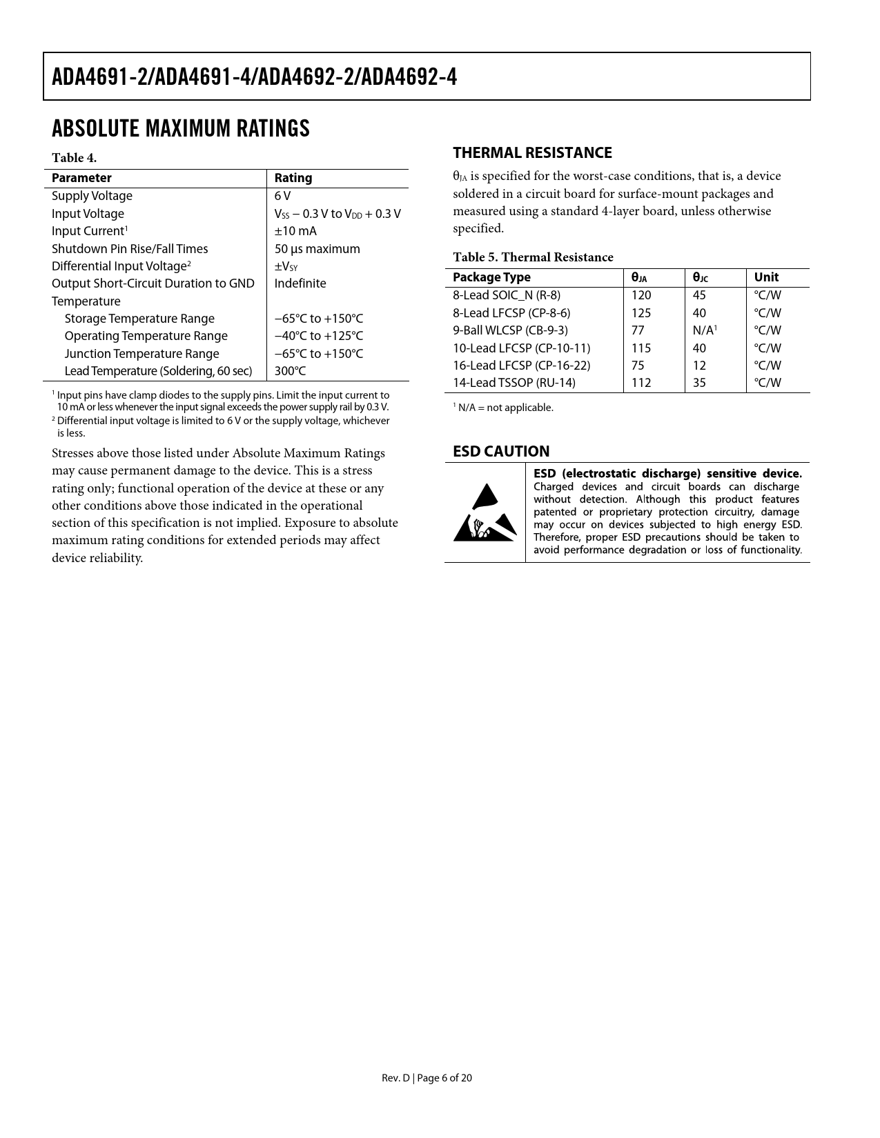

ADA4691-2/ADA4691-4/ADA4692-2/ADA4692-4. ABSOLUTE MAXIMUM RATINGS. Table 4. THERMAL RESISTANCE. Parameter Rating
ADA4691-2/ADA4691-4/ADA4692-2/ADA4692-4 ABSOLUTE MAXIMUM RATINGS Table 4 THERMAL RESISTANCE Parameter Rating
link to page 6 link to page 6 link to page 6
ADA4691-2/ADA4691-4/ADA4692-2/ADA4692-4 ABSOLUTE MAXIMUM RATINGS Table 4. THERMAL RESISTANCE Parameter Rating
θJA is specified for the worst-case conditions, that is, a device Supply Voltage 6 V soldered in a circuit board for surface-mount packages and Input Voltage V measured using a standard 4-layer board, unless otherwise SS − 0.3 V to VDD + 0.3 V Input Current1 ±10 mA specified. Shutdown Pin Rise/Fall Times 50 μs maximum
Table 5. Thermal Resistance
Differential Input Voltage2 ±VSY
Package Type θ
Output Short-Circuit Duration to GND Indefinite
JA θJC Unit
Temperature 8-Lead SOIC_N (R-8) 120 45 °C/W Storage Temperature Range −65°C to +150°C 8-Lead LFCSP (CP-8-6) 125 40 °C/W Operating Temperature Range −40°C to +125°C 9-Ball WLCSP (CB-9-3) 77 N/A1 °C/W Junction Temperature Range −65°C to +150°C 10-Lead LFCSP (CP-10-11) 115 40 °C/W Lead Temperature (Soldering, 60 sec) 300°C 16-Lead LFCSP (CP-16-22) 75 12 °C/W 14-Lead TSSOP (RU-14) 112 35 °C/W 1 Input pins have clamp diodes to the supply pins. Limit the input current to 10 mA or less whenever the input signal exceeds the power supply rail by 0.3 V. 1 N/A = not applicable. 2 Differential input voltage is limited to 6 V or the supply voltage, whichever is less. Stresses above those listed under Absolute Maximum Ratings
ESD CAUTION
may cause permanent damage to the device. This is a stress rating only; functional operation of the device at these or any other conditions above those indicated in the operational section of this specification is not implied. Exposure to absolute maximum rating conditions for extended periods may affect device reliability. Rev. D | Page 6 of 20 Document Outline FEATURES APPLICATIONS GENERAL DESCRIPTION TABLE OF CONTENTS REVISION HISTORY SPECIFICATIONS ELECTRICAL CHARACTERISTICS—2.7 V OPERATION ELECTRICAL CHARACTERISTICS—5 V OPERATION ABSOLUTE MAXIMUM RATINGS THERMAL RESISTANCE ESD CAUTION PIN CONFIGURATIONS TYPICAL PERFORMANCE CHARACTERISTICS SHUTDOWN OPERATION INPUT PIN CHARACTERISTICS INPUT THRESHOLD OUTLINE DIMENSIONS ORDERING GUIDE
