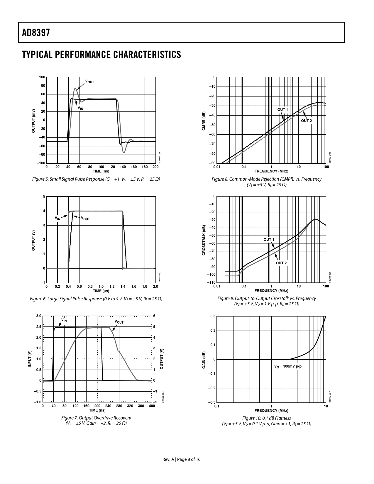

AD8397. TYPICAL PERFORMANCE CHARACTERISTICS. 100. VOUT. –10. –20. –30. VIN. OUT 1. –40. OUT 2. –50. CMRR (dB). OUTPUT (. –60. –70. –80. –100. –90. 120. 140. 160
AD8397 TYPICAL PERFORMANCE CHARACTERISTICS 100 VOUT –10 –20 –30 VIN OUT 1 –40 OUT 2 –50 CMRR (dB) OUTPUT ( –60 –70 –80 –100 –90 120 140 160
AD8397 TYPICAL PERFORMANCE CHARACTERISTICS 100 0 VOUT 80 –10 60 –20 40 –30 VIN V) OUT 1 20 m –40 0 OUT 2 –50 –20 CMRR (dB) OUTPUT ( –60 –40 –70 –60 –80 –80

0 20 40 60 80 100 120 140 160 180 200 0.01 0.1 1 10 100 TIME (ns) FREQUENCY (MHz)
Figure 5. Small Signal Pulse Response (G = +1, VS = ±5 V, RL = 25 Ω) Figure 8. Common-Mode Rejection (CMRR) vs. Frequency (VS = ±5 V, RL = 25 Ω)
5 0 –10 4 –20 VIN VOUT –30 3 –40 ) V –50 2 OUT 1 TALK (dB) S –60 OUTPUT ( –70 1 CROS –80 OUT 2 0 –90

0 0.2 0.4 0.6 0.8 1.0 1.2 1.4 1.6 1.8 2.0 0.01 0.1 1 10 100 TIME (

s) FREQUENCY (MHz)
Figure 6. Large Signal Pulse Response (0 V to 4 V, VS = ±5 V, RL = 25 Ω) Figure 9. Output-to-Output Crosstalk vs. Frequency (VS = ±5 V, VO = 1 V p-p, RL = 25 Ω)
3.0 6 0.3 VIN VOUT 2.5 5 0.2 2.0 4 0.1 1.5 3 ) ) V V B) d 1.0 2 0 INPUT ( OUTPUT ( GAIN ( VO = 100mV p-p 0.5 1 –0.1 0 0 –0.2 –0.5 –1

0 40 80 120 160 200 240 280 320 360 400 0.1 1 10 TIME (ns) FREQUENCY (MHz)
Figure 7. Output Overdrive Recovery Figure 10. 0.1 dB Flatness (VS = ±5 V, Gain = +2, RL = 25 Ω) (VS = ±5 V, VO = 0.1 V p-p, Gain = +1, RL = 25 Ω) Rev. A | Page 8 of 16 Document Outline FEATURES APPLICATIONS GENERAL DESCRIPTION PIN CONFIGURATION TABLE OF CONTENTS REVISION HISTORY SPECIFICATIONS ABSOLUTE MAXIMUM RATINGS MAXIMUM POWER DISSIPATION ESD CAUTION TYPICAL PERFORMANCE CHARACTERISTICS APPLICATIONS INFORMATION POWER SUPPLY AND DECOUPLING LAYOUT CONSIDERATIONS UNITY-GAIN OUTPUT SWING CAPACITIVE LOAD DRIVE OUTLINE DIMENSIONS ORDERING GUIDE
